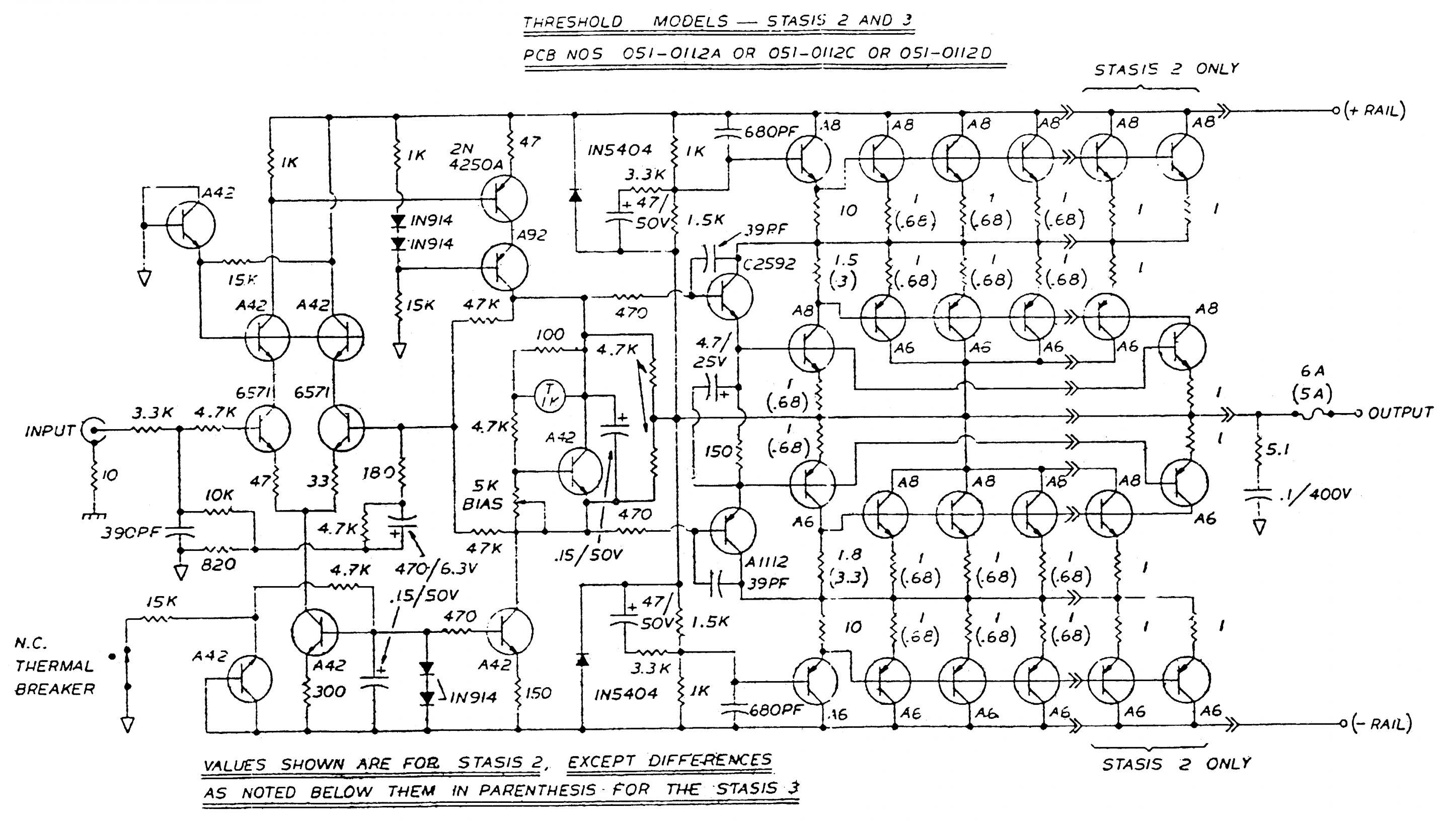

I just picked up a Stasis 2. It does not sound as good as my 4000's. I am using a Pioneer Vsx-59txi as pre-amp instead of a Threshold like with the 4000's. Every time I replace the line/power fuse with a fast blow it opens. It operates fine with the standard one it had in. I can not find schematic.
