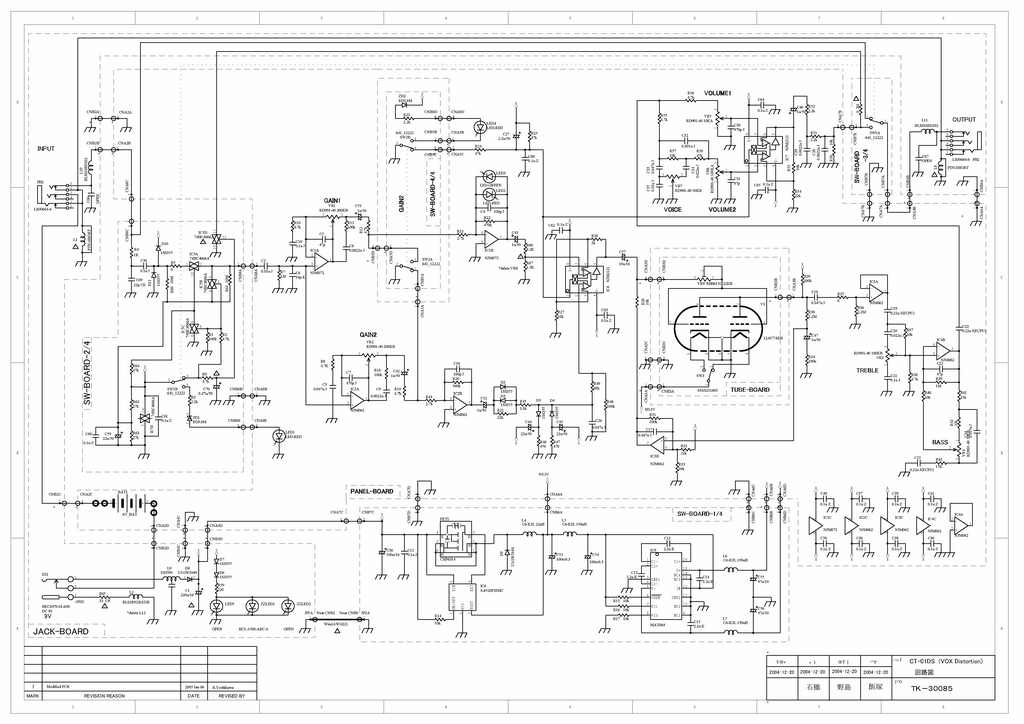

I have read the description of the pedal, but since it doesn't state anything about tube life span I posted.
JMFahey, I have a schematic of this pedal that I found floating around the net years ago, and it depicts the use of a 12AU7 in series with the signal. Yes, the clipping comes from some 3mm leds, but the advertising does not state the clipping comes from the tube - a "sonic performance of the tube" is mentioned.
The following two tests could show that the tube really is in the signal chain, giving some "character":
(1) I installed an smd switch in the pedal that allows you to choose one of the two triodes in the 12AU7 package (only one is used). Changing the triode used resulted in less volume and a bit less sparkle, but even if only volume was lost (and "sparkle" was a placebo due to the volume loss) the signal is passed along the tube - so no scam here.
(2) I have built (and happily using for a compact pedalboard) the overdrive of the 1st channel, using the same schematic I have but only omitting the tube. The two effects sound different, the tube-driven being a bit more compressed and mid-focused. Small differences, not anything great, but definitely noticeable. I really didn't think in the first place that the tube would matter, but maybe it does a little. (maybe stands for "provided I have the correct schematic"). With some mods the pedal without the tube is a great effect for my taste though, proving to me that 90% of the sound is indeed NOT the tube. I wouldn't disagree on that.
I just think that I can now manage use the treble control more, which was always a problem with that pedal everywhere I used it. So I thought that maybe the tube is dying, and posted. I have been using it for 10 years now, it has undergone lots of hours of playing. Maybe the best answer is to buy a replacement tube and check, but a conversation is always worth it.
Thanks.
Would you please post it?
I expected something like that.

If we get the VOX schematic I can build a gain stage, even a "Matsumin" and check what it can actually do.

I'll try. Oh, it worked.
Thanks for the schematic!
To me it seems that this pedal was designed by someone who knows their way around analogue audio electronics. It isn't a blind copy of something from the 1950s or '60s like most of these "real tube" pedals, and the design shows awareness of more sophisticated techniques that are lacking from typical hobbyist designs like the Valvecaster.
As an example, this VOX preamp uses an op-amp in a servo feedback loop to monitor the anode voltage of the 12AU7, and continuously adjust the grid bias voltage to bring the anode voltage exactly where the designers intended. The op-amp only operates at very low (near DC) frequency, so it doesn't interfere with the audio signal passing through the valve.
This means no need to hand-select 12AU7s for this unusual operating point (which is so far below normal operation that you can't even see it on normal datasheets.)
By the way, Takamine claims their Cool Tube preamp uses low heater voltage to avoid having a hot tube drying out and damaging the nearby wood of the guitar body. It could be pure marketing BS, but it is at least a plausible reason, unlike some of the nonsense we often see in ad copy!
