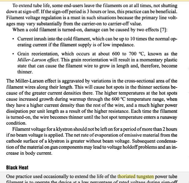

The "enemy" of thoriated tungsten filament tubes is the on/off cycles, due to the Miller-Larson Effect.
Jerry C. Whitaker
Power Vacuum Tubes: Handbook
Morgan Jones :
https://books.google.hu/books?id=ed...gsten Filament "Miller-Larson Effect"&f=false
There are two reasons why the off/on cycle kills thoriated tungsten filaments:
  • As the filament temperature passes through 900 degrees K [either when they are turned on or switched off], the Miller-Larson effect causes the grains of the metal to reorient themselves, so that the wire becomes thinner and longer. Worse, if a given section of the filament is slightly thinner, the increased current density causes increased localized heating, which exacerbates the Miller-Larson effect and causes further necking of the filament. Eventually, this necking leads to such deep cracks that the remaining conductive material has sufficiently high current density and local heating to vaporize it, thus destroying the filament.
  • The resistance of a cold filament is far less than that of a hot one, and assuming an operating temperature of 1,975K, but an ambient temperature of 293K (20 deg. C), the initial cold current is 8.6 times higher than the operating current. The inrush current through the filament interacts with the Earth's magnetic field to produce a small kick. Combined with the Miller-Larson effect, this gradually deepens the surface cracks in the brittle filament. The damage done to the filament is proportional to the cube of inrush current, so a 'softstart' circuit can be worth while.
