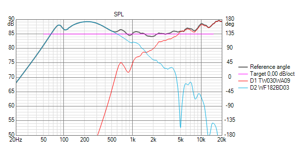

Wavemon 182, ported, using tweetter TW030WA09 + Mid-woofer WF182BD03
WaveMon 182
(I runned a simulation for this one too)

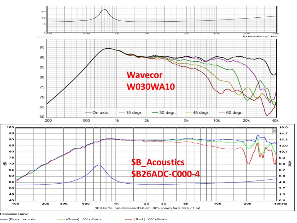

Loire Top, sealed, using tweetter TW030WA10 + Mid woofer WF182BD12
Loire Top

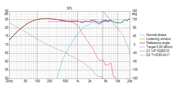

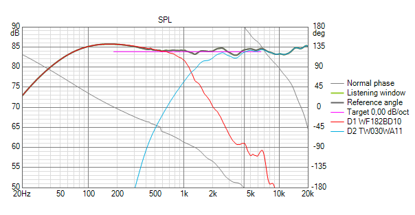

As said, with full specs in hand (as found in the Wavecor web page), and after calculating a first voltage divider for the tweeter and selecting first filter values running on-line calculators, then I began to make many adjustments (playing up and down with capacitor, resistor and inductance values) with VituixCAD (was a very interesting experience with this marvelous tool) and got final setup..
The results are in the photos attached to this thread.

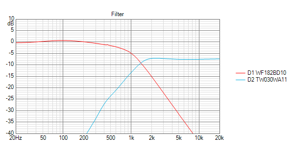

One photo shows the very simple crossover and component values, other the SPL simulation result with tweeter inverted phase/polarity and finally the filter graph showing a cross point at approx. 1898 Hz (this is not a problem for the tweeter, having a very low Fs of 410 Hz).
My question to any seasoned speaker diyer:
To me (a newbie) the results as per the photos seems to be fine. They reflect the drivers frequency and impedance bahavior. Is this trustable or I'm missing something?
Then.
My plan is to build a ported enclosure (not yet decided) between 15 and 17 liters, Fb between 37-39 Hz and F3 between 40-42 Hz. I know this will modify the SPL frequency response, but only in the lower first octave. I guess the results of the freq. response in the medium-upper register will not be affected.
Any thougts or advise?
I'm on a good road?

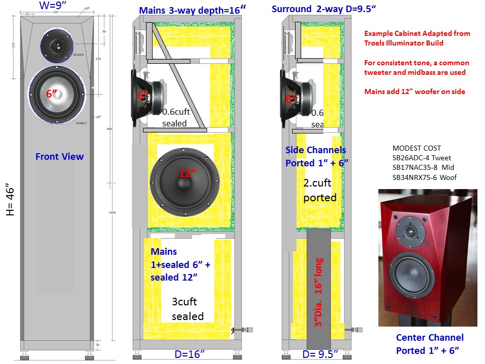

jdamico, From the Nelson Pass Aleph 3 datasheet, your 30-watt amp would favor a speaker with ~6-8 ohm impedance. BUT in your small room a 3-4ohm speaker load should not make heavy demands. BUT I would still favor using 8-ohm drivers(Re ~6ohms) if I owned the Aleph 3.
Distortion (1KHz)
0.2% @ 30 watts, 8 ohms
1% @ 60 watts, 4 ohms
1% @ 60 watts, 2 ohms
The woodshop capability often sets the design direction.
You could build a low edge diffraction 2-way cabinet and use a stand, or just put them on your furniture.... but...
In one trip to the woodshop you could cut the panels for a FUTURE 3-way floor-standing speaker cabinet designed for a sealed side woofer & sealed midbass, and today build-in just a proven 2-way with a 6.5" ported midbass plus 1" dome. Example attached. Hearing science shows benefits of ~1,700Hz crossover.

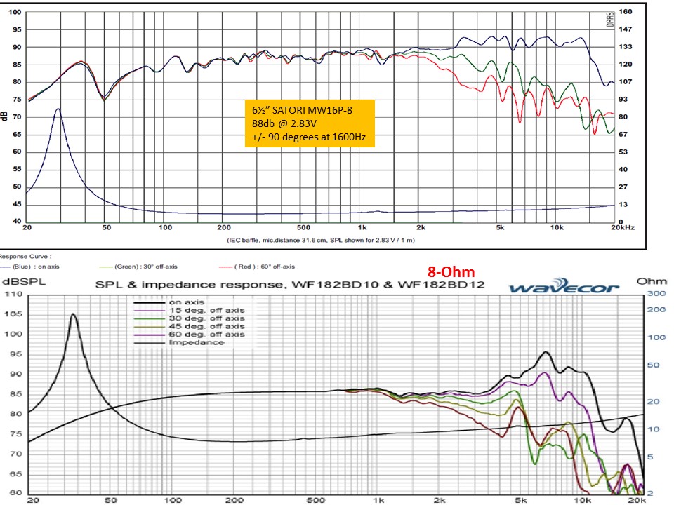

'I don't like the R-C-L additional filtering" = the WF182BD10 has a response peak which needs taming, so you'll need at least one RCL filter.
PeteMcK has identified both a cost consideration and a sound quality consideration: For passive crossover designs, can we find a more expensive, higher sound quality driver which does not require one or two R-L-C type filters? Spend your money on better drivers which do not require SPL tuning instead of the passive R + L + C components. The popular Kairos uses Satori drivers with just 2*L & 2*C & 2*R passive components, as do stepped baffle designs with the same drivers. There are a few 2-ways using textbook BW3 & BW3 circuits.

A few speaker experts recommend paper cone drivers over aluminum cone or ceramic cone for small listening rooms which have very little room treatment = rugs, drapes, soft fabric furniture, etc.... Anyone study this?

I think you'll like the result if you do it right, I've used a couple of Wavecor drivers and found them excellent.
re:'I don't like the R-C-L additional filtering" = the WF182BD10 has a response peak which needs taming, so you'll need at least one RCL filter
(Datasheet here: WF182BD09_10_11_12 )

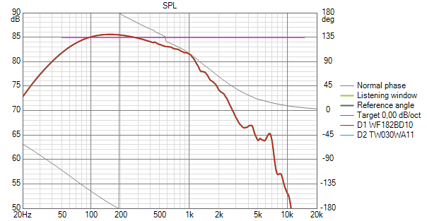

Many thanks for your advise PeteMcK
If I'm understanding right, the WF182BD10 nasty peak is that between 5kHz and 10kHz, but at such high frequencies (please correct me if I'm wrong) the simple lowpass filter shall do the job.
I'm attaching the WF182BD10 frequency response after the 2nd order lowpass, and the peak is still visible but appears to be very attenuated. Do you think is still a problem?
There is another little peak at 1kHz, but with less than 1 dB effect, and not know sure if this will cause trouble.
Thanks, LineSource,
My objective is towards 8 ohms and that's the reason I'm chosing an 8 ohm woofer.
On the other hand, my plan is simple MDF cutted at the same time of buying (in shop), then will think about finishing options. Fortunately I like woodworks and made a few furniture and repairs before, so feel confident.
The "Lorie" design team believed that three L-R-C filters plus a tweeter 'lift RC' were necessary to support LR2 crossover circuits with the Wavecor WF182BD12 & TW030WA10. If you build the Lorie, would you purchase and use this crossover?

What I'm seeing is that the resonance trap is needed. The breakup is only -20dB in your lowpass sim. This is not enough, and -25dB should be the bare minimum, whereas -40dB should be the norm, and -50dB is eliminated completely. Trust me, it will be audible at -20dB. Maybe not in output, but in HD and how the driver sounds.
Phase coherence is related the resultant FR, not mainly the circuit used, but a combination of the variances in the inherent FR of the driver and the transfer function of the circuit used. More parts is not necessarily a bad thing. "Minimalism with respect to necessity."
Now- the Loire looks to be bright on the top, and I would not favor it as it is depicted. Flat response would be better. The notches on the woofer help with the bump below the xover and the breakup. I feel these are required, but might be okay using a different filter to accomplish the same end-goal. The tweeter response has an LCR attached to lower the output in its lower range and leave the top-end untouched. I woud still add a 3-6 ohm resistor out front to attenuate it to match the midbass.

After just "playing" here and there with the crossover values in the simulator, I realized that i'ts possible to attenuate more the woofer "breakup" by lowering the crossing point (a more severe lowpass for the woofer). This adds some extra solicitation to the tweeter too, but having this tweeter low resonance Fs=410 Hz, I think this sould be not a problem.
I'm sharing the new plots for the Wavecor driver's crossover, one pure and another with 1/6 octave smoothing. Everything seems to be more or less in the +/- 1,5 dB SPL response 🙂

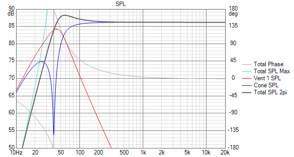

Also I'm sharing the new crossover values, the filter graph and a potential vented enclosure SPL behavior.

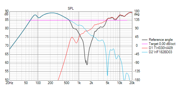

I found another project on the web using Wavecor drives.
https://www.hifisound.de/out/media/.../XwST3ZSunAfsutBEcDR0uisCVu7LUjr4fSDwHA==.pdf
Wavemon 182 was designed by Bernd Timmermanns and was published in a german magazine (unfortunately I do not speak german).
The interesting thing is that for this drivers the complete data for crossover simulation is available at Wavecor web page, so I ran a simulation to compare my results vs. the measurements shown in the magazine.
Attached my sim results. Only inverting tweeter polarity I could obtain something similar to a flat response. In the magazine the designer inverts woofer polarity (don't know why). Nevertheless the simulation is far from a perfect response and reflects some nasty bumps. 😕

How about showing the phase of the individual drivers with xover applied, please? How about plots of impedance, imp/phase, and individual impedances with xover applied as well?
You just are not showing us all of the information.
Wavecor TW030WA11 | HiFiCompass
I would not xover below 1.5kHz with this tweeter to keep the 3rd order down. You will also find that this waveguided tweeter is not that easy to tame and keep happy without the dreaded honk coming through. I've heard it 3 times, and one of 3 got it right, all by experienced builders. Several others have said they could not succeed and be happy with it.
