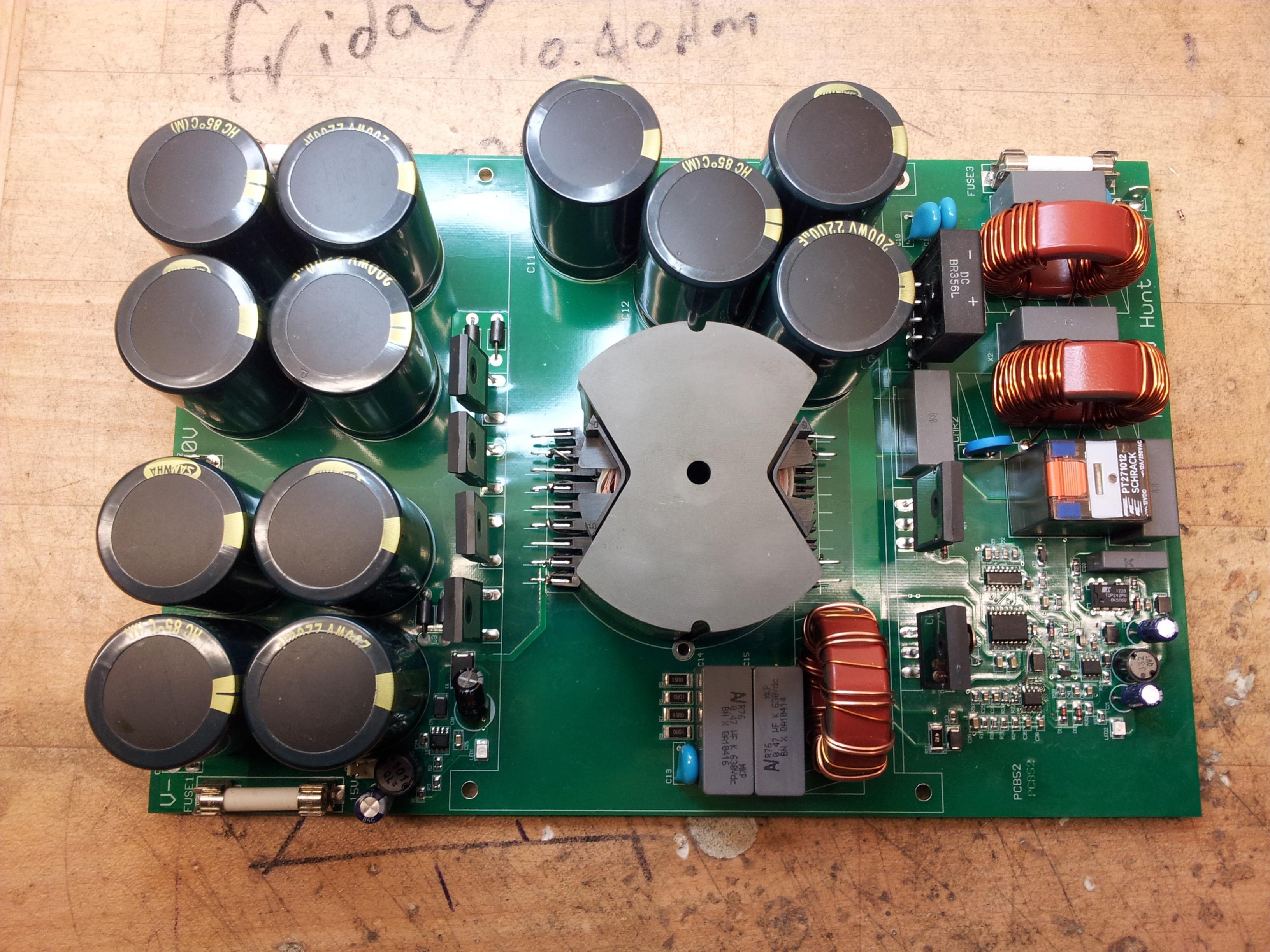

here it is my prototype
Unregulated ZCS

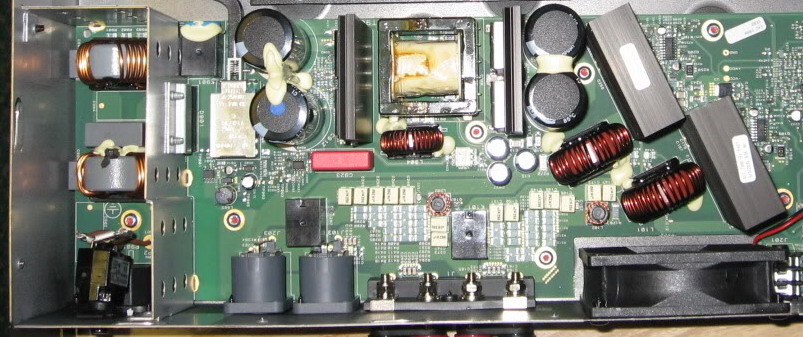

i think the pcb routing isn't good , it's better to reduce the length of hi voltage path (before and after rectifier). look at XLS1500 component placement.
IRSound
