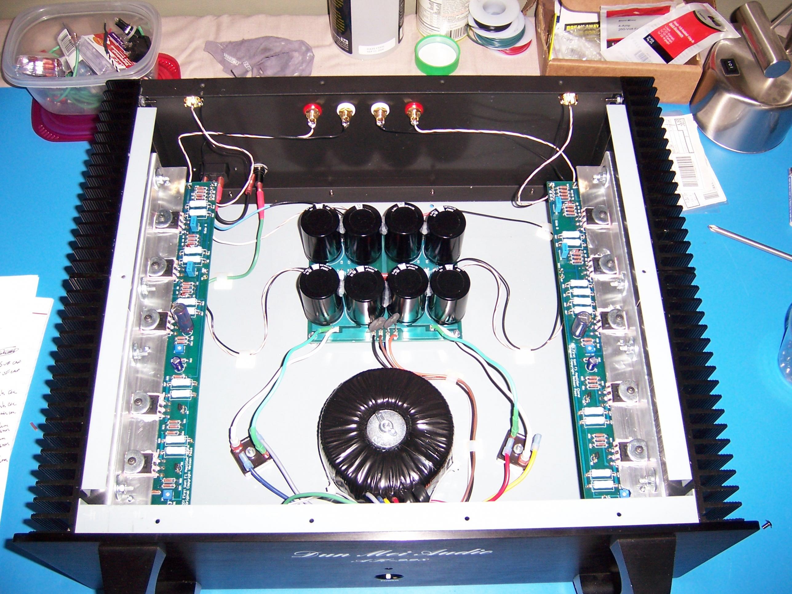

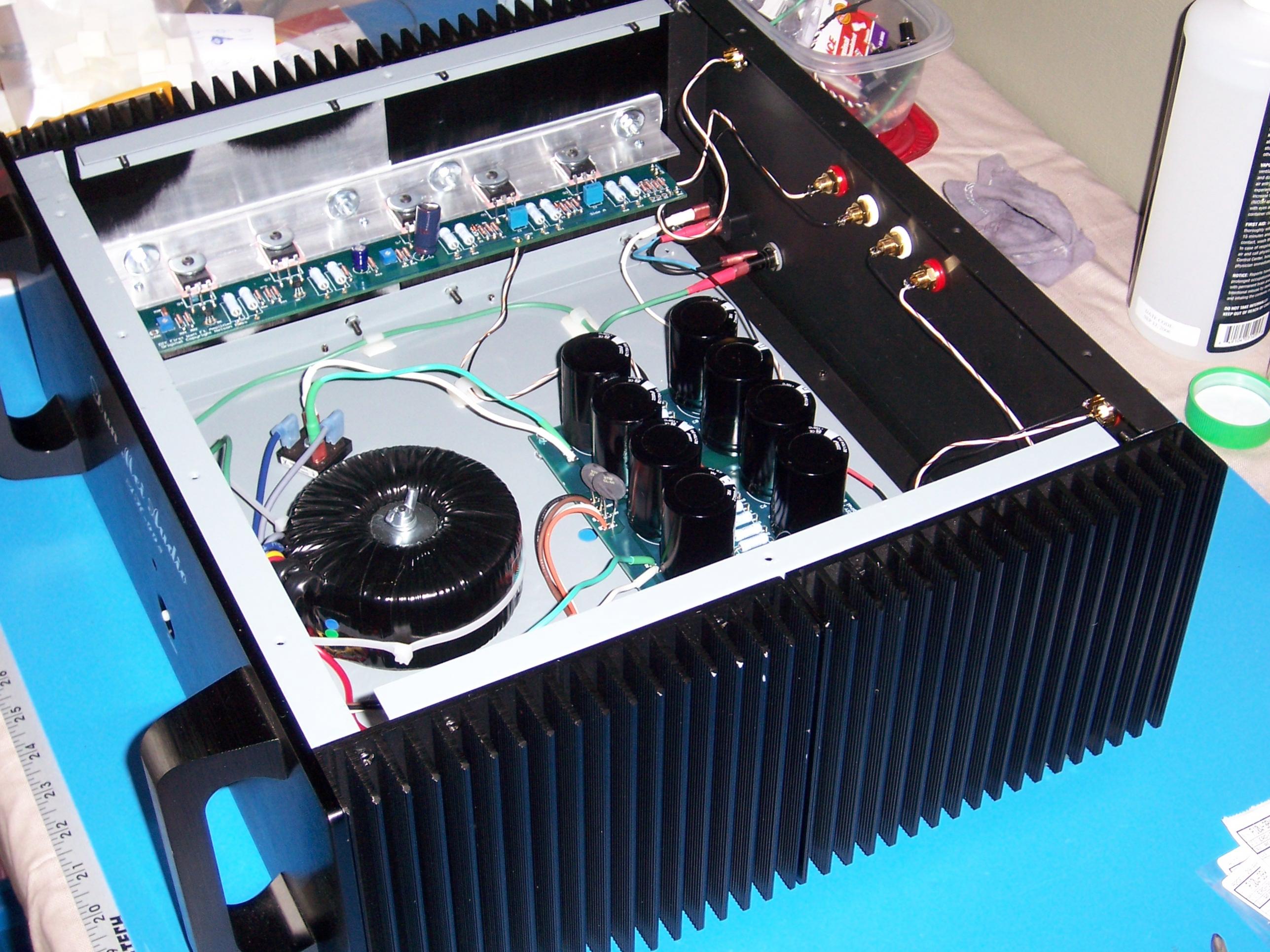

after a year or so of gathering parts (most via this forum) I am finally finished with my first First Watt amp...an F1. I figured I would start with the first of the series and go from there. This will be the first time i've started up an amp so the start-up and biasing process is new to me. Before I 'plug and pray' would anyone care to offer suggestions on last minute checks, double checks etc. ?
Also to clarify my understanding do i need to connect anything to the inputs to start the biasing procedure ? Any help and/or suggestions would be greatly appreciated.

Well the "plug and pray" approach thankfully did not result in smoke or fire. Unfortunately though I seem to be having issues setting the bias.
1)P1 only gives me a range of 18.5v to 19.1v across the drains relative to ground. Should be set at 13.8.
2)Drain of Q7 is a measly .575v instead of 3v relative to ground.
3)The voltage across r27-r30 is right where it should be at .59 v.
4)The gates of Q1 and Q2 are at 5.75v instead of the specified 7v.
Any help would be greatly appreciated.

Not enough positive voltage being applied to the Gates of
Q1/Q2. Make sure the zeners aren't conducting, or the caps
aren't leaking at the input, or the values of r5-8 are correct.
No way a functioning Q1 and Q2 will only show 5.75 when the
input bias network is driven by 19V, unless something is
drawing the current off the input.

Good morning, and thanks for taking the time to respond. I am getting a reading of .75v dc across all 4 of the zeners. (?) The values of r5-8 appear correct. As for checking that the caps arent leaking at the input could i get a little play-by-play as to how to go about it ?

Wow...you guys are good. Zeners are indeed backa@#wards. Now that i have them desoldered should i reinstall correctly, get new ones and install or leave them out entirely ?

Thank you Mr. Flemming. After switching the orientation of the zeners the amp now biases steadily at 13.8v . Before hooking this beast up to my C&C Abbys I have two more questions...
1) since i am not running balanced inputs do i need to make any allowances (ie jumpers) for this on the board ?
2) In reference to the differential voltage (50mV) seen by the loadspeaker , where do i take this measurement ?

Measure the offset across the speaker terminals, prefereably
with a load.
As to inputs, this design really likes balanced inputs. You should
make provision for them and try to use it that way in the
future.

Thanks again Mr Pass,
Im getting 30mv across the right channel speaker terminals and 45mv across the left terminals. The amp has amazing depth to the soundstage but is surprisingly bass shy with my Abbys. (?) I'll run it in for a while today and see if it fills out. Paired with my 24v Aikido i dont seem to be getting enough gain.
