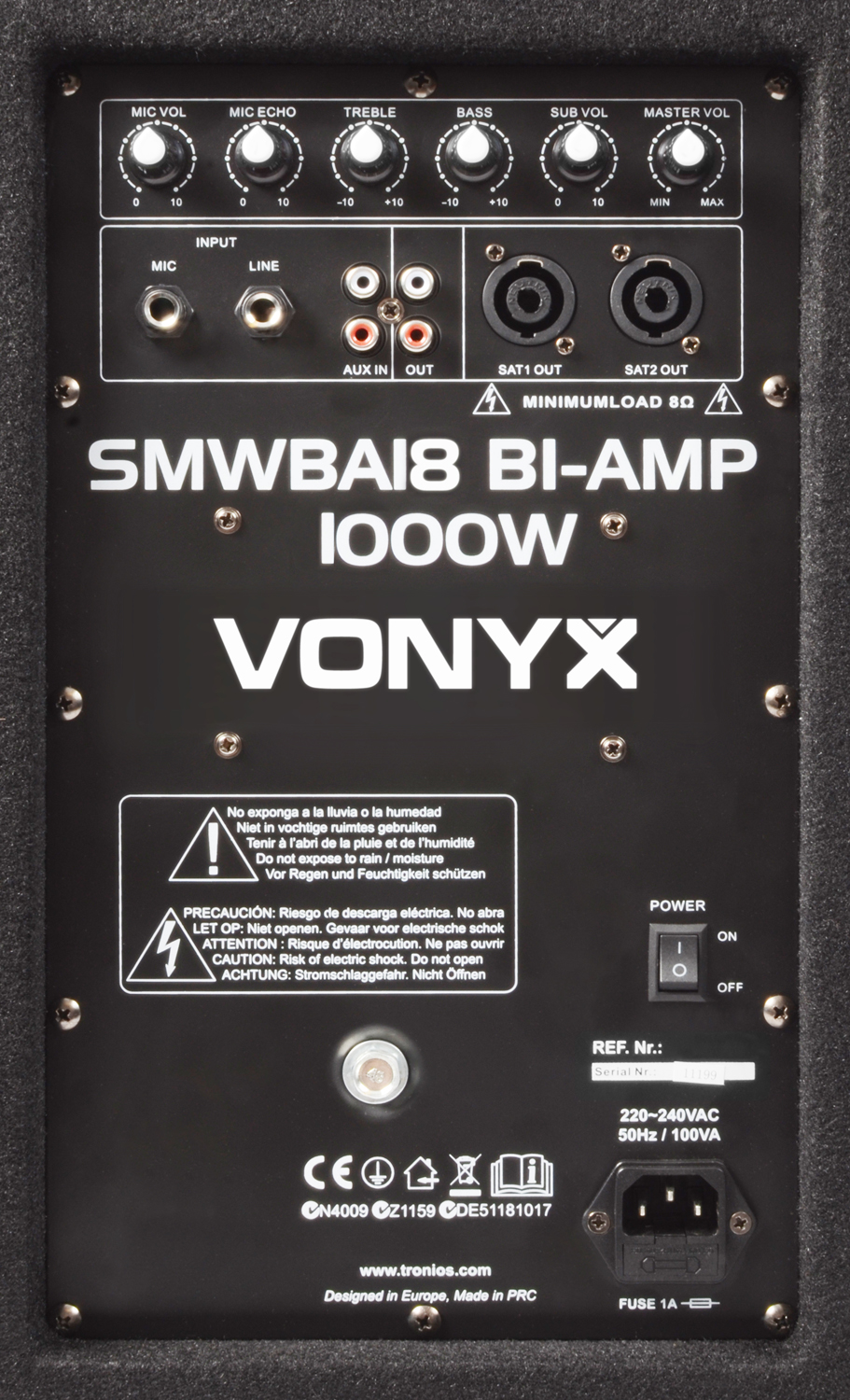

Found this really amusing 18" sub, brags about integrated amp with 250+250w for the tops and 500w for the sub. All this while drawing a whooping 100VA from the mains! 😀 Gotta love that PMPO.
