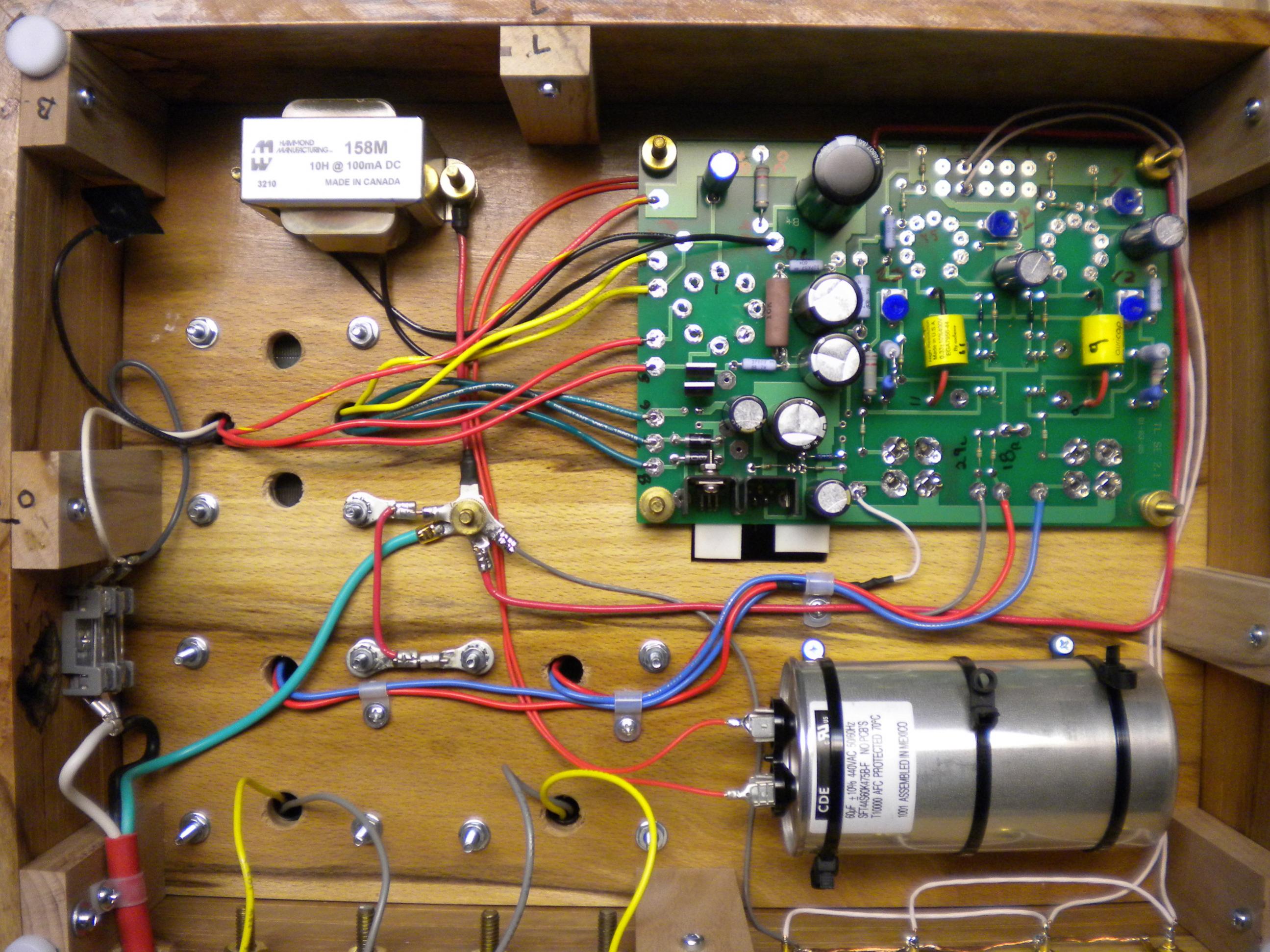

thanks guys for the detailed answers already. I love this forum 🙂 On a very simple level, though, the following issue remains:
All ground cables are connected at a terminal strip ("star ground"). Does that conclude it when using a wooden box or should I add another cable from the terminal strip (star connect) and wire it somewhere and if so, where ? Drill a hole in the back and run a cable out the box and ground it somewhere ourside ?

What do you mean by "all"? Does that include a safety ground connection?weber30 said:All ground cables are connected at a terminal strip ("star ground").
No. That could be dangerous, as you may be introducing two different electrical 'grounds' into the same room.Does that conclude it when using a wooden box or should I add another cable from the terminal strip (star connect) and wire it somewhere and if so, where ? Drill a hole in the back and run a cable out the box and ground it somewhere ourside ?
'Ground' is not some magic sink for all unwanted hum/noises/inteference. All you need to do is establish one point from which all signal voltages take their reference.
You have lots of single wire connections.Here is my wooden chassis. Since the photos I changed the input wires to coax cable...dead silent.
Every input and every output and the power supply are two wire connections to the outside world.
They should all be two wire connections with the two wires close coupled along their whole route. Even better if the two wires are a twisted pair along their whole route.
This allows for better rejection of interference.

Andrew you are correct. This was one of my first builds.... I have read and tried to understand things as time has gone by. I have taken your advice on close coupling when laying out wiring for projects. Also your advice on not fusing the neutral line.... In this case simply using coax for the signal wire cleaned things up.

It looks tidy. I use similar grounding technique for prototype builds - those eye terminals make ground connections easy - make sure these and the star point is most firmly attached.. More "permanent" builds get a grounding bus in my builds.
Andrew's advice is spot on. I might have said it this way: for every longer AC connection make sure you use twisted pair. This includes connections to the OPT. It is of course not reasonable to do this for connections between valves.
From your photo, it looked like your input grounds are all connected together. When you changed it to coaxal cable, I suspect the were then separated. So the same improvement might have been achieved by simply using twisted pair. Of course if the coax is in there and works then its best to keep it. 🙂

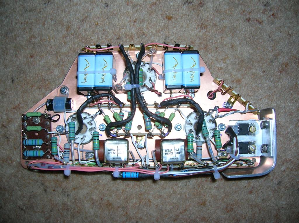

You can use plain PCB to create a ground potential and shield under the wood which will earth most of the things mounted on the top..
You can also use foils glued inside the box and earth that..depends how far you want to go..

If you use foil inside a chassis,
Don't use it as the bus Earth its just grounded shielding..ie not current carrying..
If you use PCB it can be used as bus ground..take a wire from it to supply Earth.
I try to take into account physical strength of the Earth connections..as long as I can work with them not to stiff..
(Big enough cross section to carry fault current without failing)..so the fuse clears the fault..ADS
You can make hard wired circuit boards and use the copper on the PCB as shielding and not use it as a ground plain..e.g.
Then you could mount the PCB's under the wood and use wood screws that don't come all the way through to top plate..

If you were serious enough you could mount the hard wired PCBs onto rubber shock absorbers and mount that onto another plain PCB and mount that onto the wood top plate..use aluminium foil glued as shielding inside the box and Earthed..with the circuit boards spaced away by about 5mm..years ago some TVs had foil shielding inside wooden cases it not a new idea..🙂
You could use ground planes for each board and bring them all back to a star ground then take that to the suppy Earth..

With the hard wired circuit boards you don't even get the valve base screws through the chassis..its all held in place with wood screws or blocks glued to the top plate..

This is what I was wanting to show with my photo.
