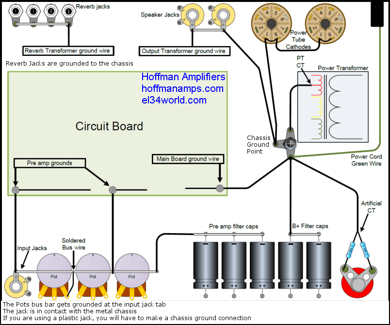

Star ground on metal chassis
I understand that idealy we want all of our grounds wired to one spot or star ground...
In my build every terminal strip has a tab thats supposed to be at ground, and is always the same lug connected to the mounting tab for obvious reasons...
Aree we supposed to lift that terminal strips mounting tab with associated nuts and bolts off thr metal chassis or is running a hookup wire from that ground tan to the main star ground enough?
Don't use the grounded terminals if you want a star ground or bus ground. Actually you don't need to do either if you don't have noise currents flowing in the chassis. Keep Power supply return current out of the chassis (especially the filter capacitors!); ground the output transformer secondary near the point of feedback (if used) and run the speaker output from there. Vintage equipment was hum-free (even phono preamps!) without star grounding until modern DIYers got hold of it.

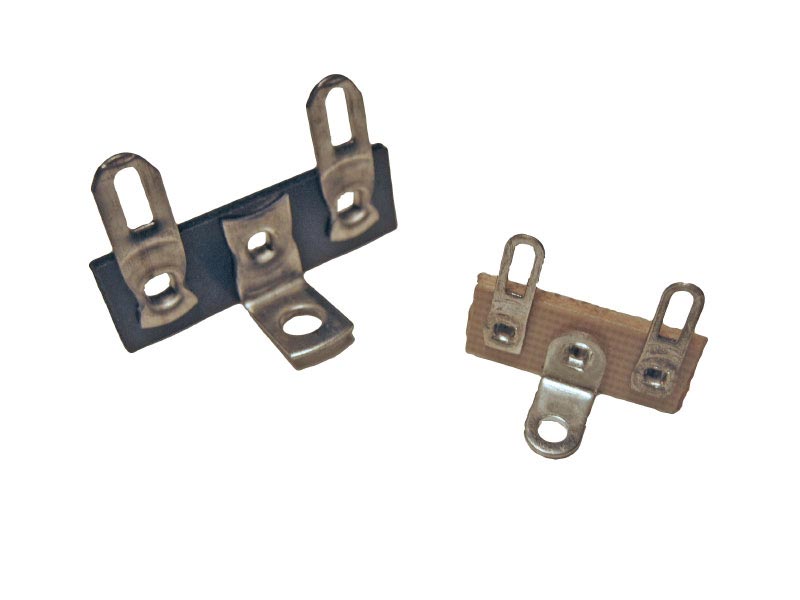

Don't use all those "grounded" terminals at all. That will cause ground loops and hum.
Use strips like this instead. Then you can bolt them to the chassis tightly and securely.

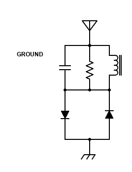

I really believe that all of this confusion is because folk believe the "ground" symbols on schematics. Because they believe there to be these dragons, they don't worry about current flows - after all, "ground" is perfect, and magically sinks and sources current. That's the way I was raised, and it took many moons to overcome that bad thinking. Many.
All good fortune,
Chris
And there's also all that dirt in the backyard. Which Hams call "ground".
I'm thinking that somehow schematics make us think about things in voltages, because that's what we can point at, measure and print on schematics. Currents run "inside" on schematics, so don't seem as real, or at least as immediate. Or is it a simpler matter of just changing perspectives that other people can do much easier than me? Both are views of the same world, but for this issue, current "flow" is the interesting perspective. Maybe just a more complete model (schematic) really is the best solution. You're right, of course, but know that nobody's going to thank you for this. Arf!

The concept is usually physically impossible in practice anyway, even though
some still try to jam a whole bunch of lugs under one screw, which is prohibited in industry for reliability reasons.
That is because it supposed to be soldered together to an eyelet terminal or turret. Sometimes, I'll even use the negative lead eyelet of the power supply cap sometimes.

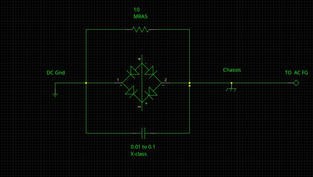

I 100% never share the safety ground with anything. It's easy enough to just drill another hole right next to the IEC connector and run a short, separate dedicated ground there.

I connect all grounds to chassis including directly connecting electrical ground (green). Not only does this provide effectively no hum or buzz, but it's actually posible to use single wire signal with earth as return. No more super loud buzz while disconnecting RCA cables.
