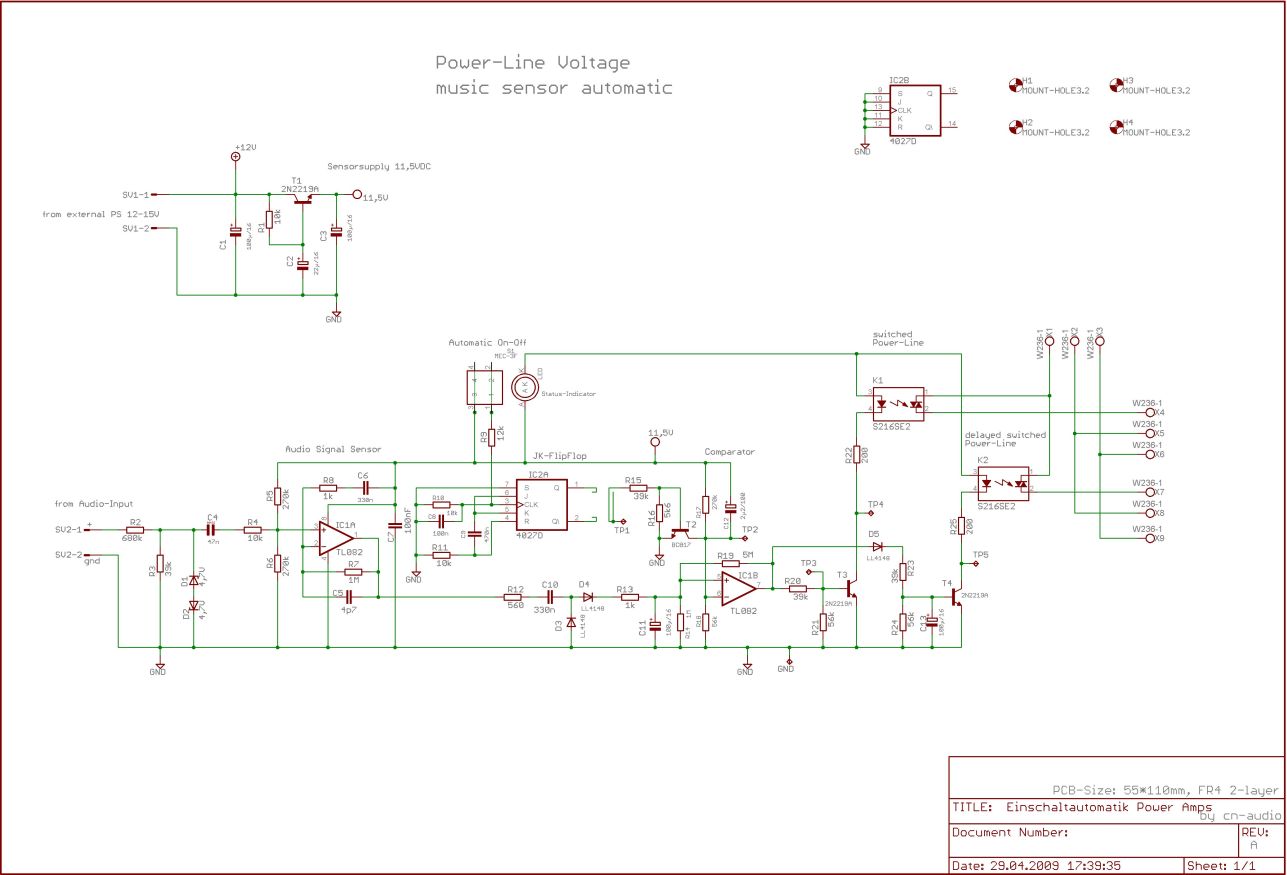

Is there a way to have a relay for automatically shutting down a diy amp when there is no input (stereo line-in) source?

Yes, you buffer, mono, rectify, and filter the signal, then use the presence of this DC voltage
for a timer circuit that enables a relay that switches the power on. If the DC stops,
the timer starts, and after a preset time interval, the relay and power are switched off.

It's more complicated than just that, something like this is necessary,
but it may not be everything that you need. Cebek PM-11 Audio Signal Controlled Relay Switch Module | Quasar UK

I used something similar in a headphone amp for my dad. Opamp +CMOS 555 + FET.

I used this circuit fo many years.
It is more complicated, but it discriminates between a spike on the power line and music signal ... so it detects a music signal safely.
The switch-on is done with two solidstate relais on of which is delayed.
The first relais soft-switches the connected power electronics via a bunch of power resistors.
