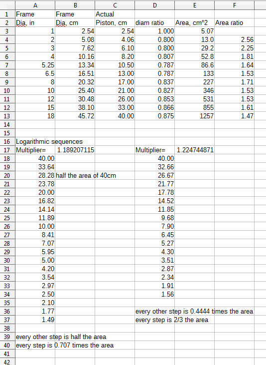

Here is an exploration in excel I did at one point
These sizes were standardized in the early radio days. I think that the EIA was involved at one time. I also agree that they approximately hit constant percentage steps in area growth. Note that there is some ambiguity in measurement as well. I was always told to measure round woofers across the diameter and pincushion or square across the short dimension rather than the diagonal. That led to odd circumstances such as a 5" round midrange using the same cone as a 4 1/2" pincushion.
Different makers also made their own odd sizes and favorites. For automotive the Europeans like 4 x 6 and 4" (100mm). Detroit liked 6 x 9 and 5 x 7, but Ford had a different size 5 x 7.

The golden section number concept & spreadsheet w/ratios are interesting (for some reason the TV show Ancient Aliens came to mind after reading those posts 😉 😀).
Yep I've definitely noticed that issue over the years. Especially with modern subwoofer drivers i.e. the spec sheet says "ten inch" but the cone looks more like @8" because of a huge surround.
