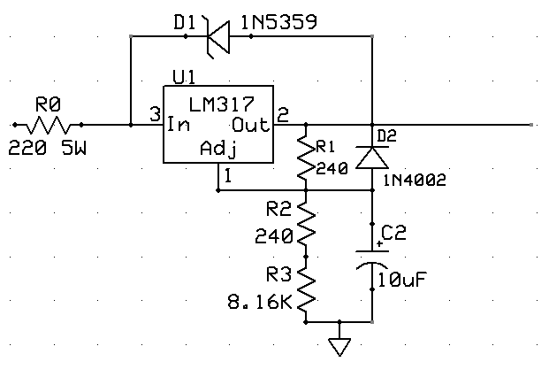

Thanks for the replies!
So this would work?

So this would work?
A few issues:
This would only work if your circuit has a significant draw. If you are feeding a few mA with this, the zener will supply the circuit needs and your regulator will be bypassed.
240 ohms is a little high for the out/adj resistor. National always uses 120 on their datasheets.
Why bother to add the input resistor?
If I was building this, I would just throw everything out except 2 resistors and the capacitor.
Yes, but using 240R cuts total dissipation in R2 and R3. The reg itself.really doesn't care what R1 is, it only sets a constant-current through the lower voltage-setting resistor(s).
Adding a smallish cap to ground after R0 will help no end. 0.1-10uF is enough, with R0 this will reduce noise feedthrough and keep input impedance low at the regulator - 317s like <10ohms source impedance.
BTW the ADJ pin averages 50uA leakage current, which x 8K4 means the reg a posted will deiver about [[(1.25/240) * (8K4)] + (50uA * 8k4) + 1.25v] , about 45.5V. Not way off target, but when using large-value voltage set resistors the ADJ pin current can be significant.
Adding 10uF across R2+R3 will significantly improve ripple rejection and lower the output impedance BTW.
I see 240 everywhere, they even recommend it IIRC ;-)

Not sure if that's sarcastic or not. Whatever you decide, at least consider adding an extra loading resistor to the schematic you drew. As I said, if you have a small small load, the current will just flow through the zener and bypass the regulator entirely. That is what will happen if you are just feeding a single tube with the regulator.
