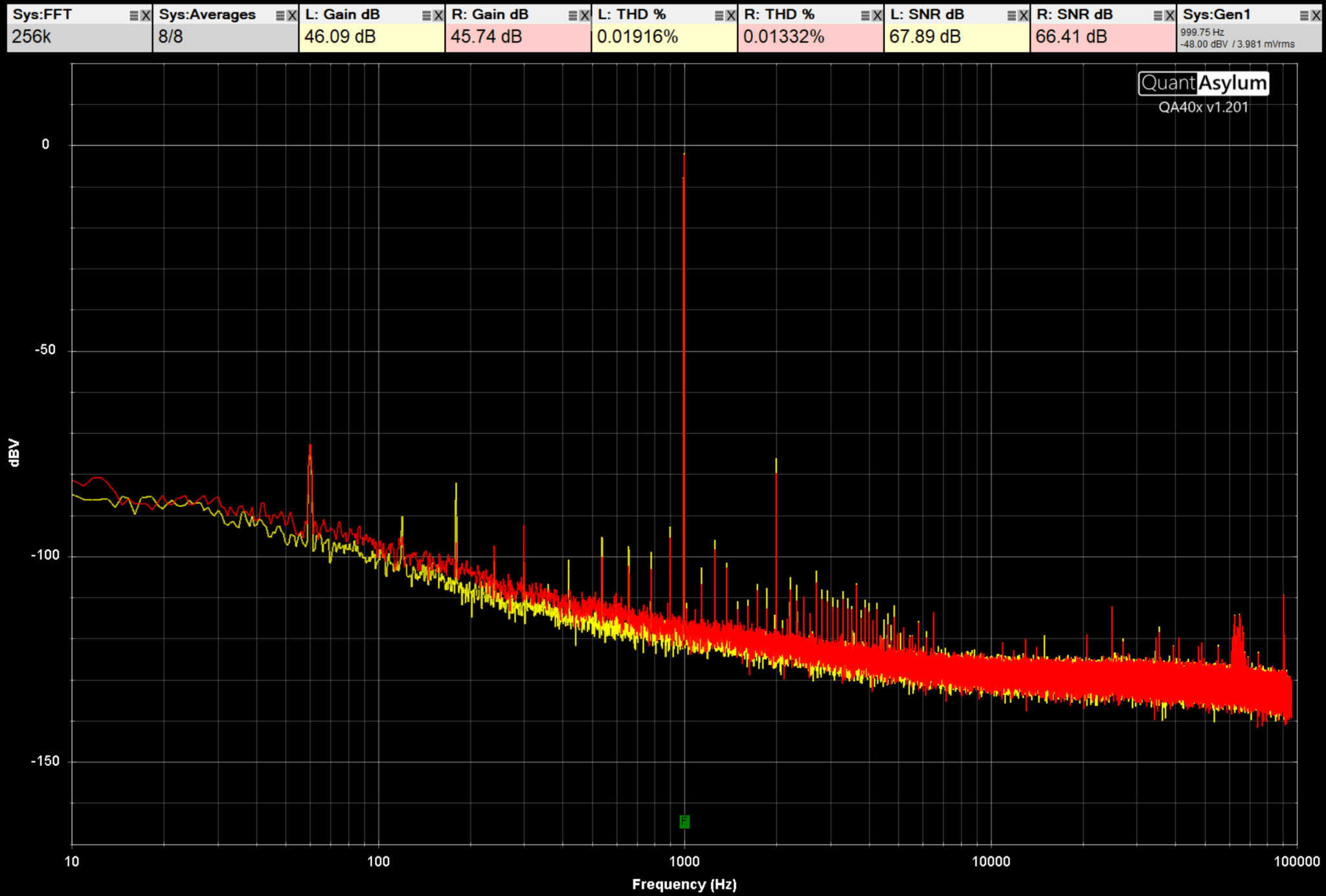

1. All audio performance data was taken with a QA403 Audio Analyzer. The yellow line is the left channel, the red is the right. Photos of the test setup are below.
2. The unit was designed to take a -48dBV signal, off a moving magnet pickup, and amplify it to around 0dBV, at 1KhZ, with a 22k ohm resistive load on the output. See image 4 for a test tone on an unloaded output and image 5 for a loaded output.

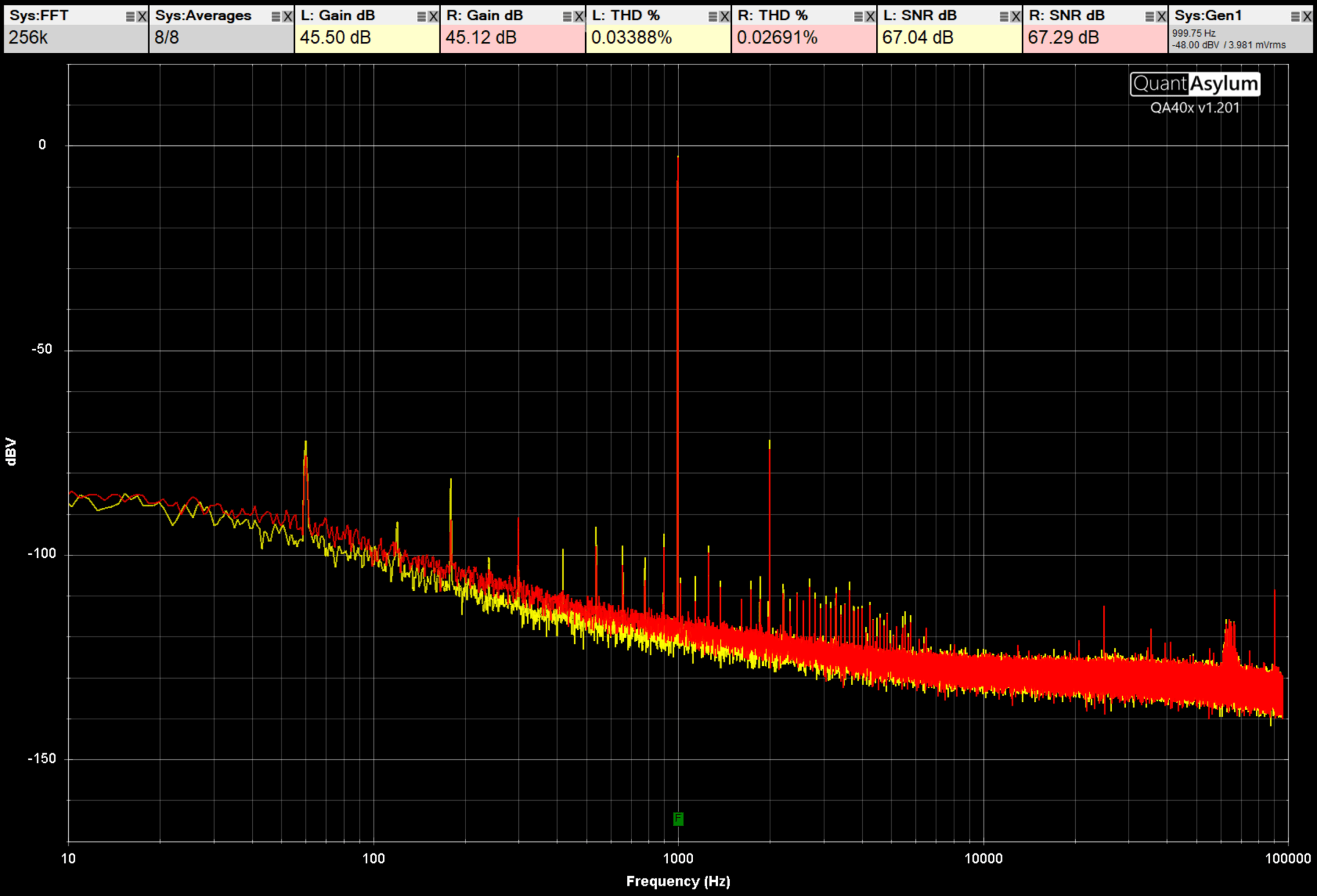

3. THD, at 1kHz, ranges from 0.004% to 0.01% with no load, and 0.01% to 0.02%, with the 22k ohm load.
4. Unweighted, the signal to noise ratio ranges from 68dB to 71dB. With A-weighting, it is between 81dB and 83dB. Note that the testing was not done with great quality RCA cables, as I have none on hand. This explains the 60Hz spikes and harmonics present in the data. With better interconnects, I expect the signal to noise ratio to improve, along with the THD.

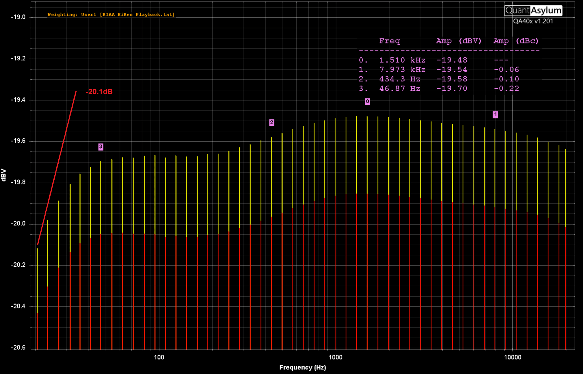

5. When RIAA weighting is applied to test tones across the audio band, there is 0.2dBV or less deviation between the tones. See picture 7.

The LEDs are not blue, they are IR. The schematic voltage readings show a drop of around 1.2V at each cathode with respect to GND. Did you look at it? A blue LED, like you said, will drop around 2.5V. I agree 2.5V is an inappropriate DC biasing point for a 6C45P.
Correct me if I am wrong, but IR emitters are not particularly noisy. I chose them for the bias point, and the need to not include a resistor bypassed with a cap, which adds a low-frequency time constant. I'll admit, I did not research the topic of LED noise figures, and what those would be vs. that of a resistor.

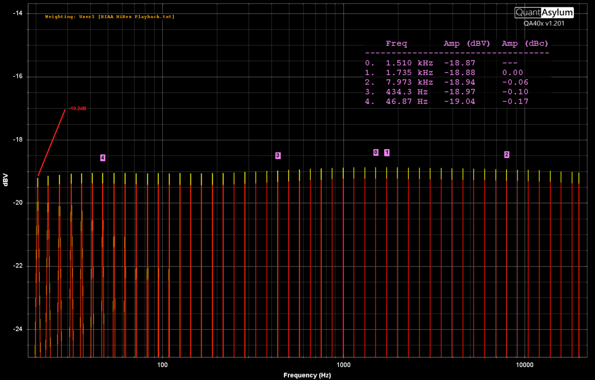

As for the RIAA response, I did include this in my data. Did you not see it? It is picture 7.
I did test the unit unloaded vs. it being connected to a 22k ohm load (see pictures 4 and 5). The load was connected with a 1 meter RCA cable. I observed a 0.6dB loss of signal (across the whole audio band) along with a 0.015% rise (worst case) in THD at 1kHz. There was no observable high-frequency roll off, which I would expect to see with cable capacitance. The RIAA data was taken with the load connected, and there was less than 0.2dB of deviation.
The only evidence, from my testing, that correlates to output impedance, is signal loss and THD. As per RCA cables, you mentioned length/capacitance, but did not give any numbers. So for a cable, what is considered long? What capacitance is considered high for an RCA cable? And what do you consider low for an input impedance of a following stage?
Finally, is there any more data you or anyone else would like me to post?

To ensure the unit was not whistling, I checked the output with my oscilloscope at idle, with the -48dB 1kHz signal, and while powering up and powering down for RF noise. I found no evidence.
I suspect oscillations have more to do with inductive return paths at RF frequencies, rather than the tubes themselves. The boards in the phono stage have ground planes on the bottom side, which may explain why I am not seeing any whistling.
To further test performance, I attached 3 meter cables and retook the 1kHz tone data. Pictures 1 and 2 show 1kHz tone performance with 22k ohm and 10k ohm loads respectively. As expected, the signal to noise ratio dropped by around 3dB (with respect to my original data) due to hum pickup of the long cable. With a 10k ohm load, there was around 0.5dB more signal loss, and a further increase of THD, with respect to the 22k ohm load.
Just so everyone knows, as far as the RIAA data is concerned, I was not particularly thorough in taking it, so I attached better data. Pictures 3 and 4 show RIAA performance with the 22k and 10k ohm loads. There is 0.33dB of deviation with the 22k ohm load, and 0.62dB with the 10k ohm load. This is because C18 and C28 make a high-pass filter with the loads. Increasing the values of C18 and C28, along with R28 and R38 will improve the deviation. The only drawback will be more low-frequency signal when the unit is not loaded or lightly loaded. As far as high-frequency roll off is concerned, there is still no evidence of it.

The RIAA data I posted does show low frequency roll off using 3 meter cables, with both 22k ohm and 10k ohm loads. The exact numbers are in post #8. Measurements were taken end-to-end.

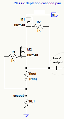

BTW why don't you use "low Z" output of cascode CCS?
Can you elaborate on this point?
That's taking the output signal of the output stage from the source of the CCS MOSFET, instead of from the triode plate.

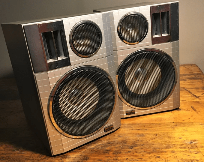

As a fellow diy hobbyist, I can suggest that having some inexpensive speakers on hand to test with are worth the very modest investment. The last pair I sourced at a flea market cost me all of $15. They are still going strong too.
I had a second set of inexpensive testing speakers ready as a reserve (which had cost a whopping $18) but our cost center #1 moved out and she took them with her to university...

I do sincerely hope it all works fine. Inexpensive Testing speakers save your good ones too btw. 🙂
If you have a Goodwill or similar near you, that could be a good source of 'stunt speakers' for testing. Nobody wants those old 1990s rack systems and boomboxes with detachable speakers. Remember these?
