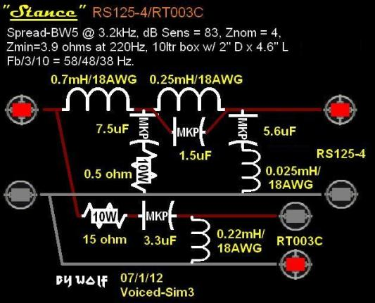

It's my design...
..and it placed 3rd in the <$200 class at MWAF this past summer.
All info is in this thread:
I theorize: 'Stance' a mini 2-way with RS125-4 and Beston RT003C...
and herein for the photos:
http://s18.beta.photobucket.com/use...library/?&_suid=13517558910780993639014226737
Full bodied without bloat, and a nice and sweetly relaxed topend. Talk of that Sound-off I attended.
Let me know if you have any other Q's,
Wolf

How about anyone with experience with the Beston Round Ribbon?
3kHz+ (12dB electrical minimum) for this round-planar. Rumor has it- it's the same element and design as the Genesis 'ribbon that they tout so highly. It just doesn't have the horn flare like the Beston does.
It rolls off fast below 3kHz, and it's easy to get a BW5 out of it with a 12dB electrical filter like I did.
It has it's own sound/character unlike many other units, but I think that's because it's more of a ring-radiator in terms of operation.
This design really exceeded my expectations, as I thought it'd be a stretch to get them to play nice with each other, but it blended so well in the end.

This is wonderful, it looks like a very cost effective kit.
Are the inductors DCR critical?
Can I go with 15awg P-Core inductors for the woofer?
Would there be any benefit, or would it be too much of a change?
The inductors are not large enough in value to be P-Cores. All are 0.7mH or less. 18AWG Air is specified, as directed from me looking at correct DCR, for the kit through Meniscus. The coil DCR should be within 0.1 ohm.
So in essence- you can't swap a P-core for the Airs as nothing applies.
Later,
Wolf
