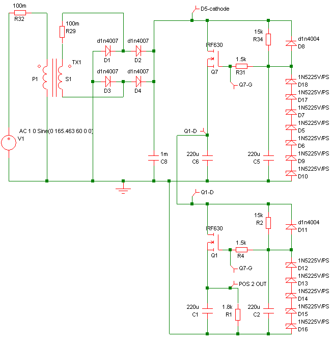

In Zen version 3, Nelson details a power supply. My question is this: can two positive voltage power supplies, such as described in the Zen article, be stacked, piggy-back?

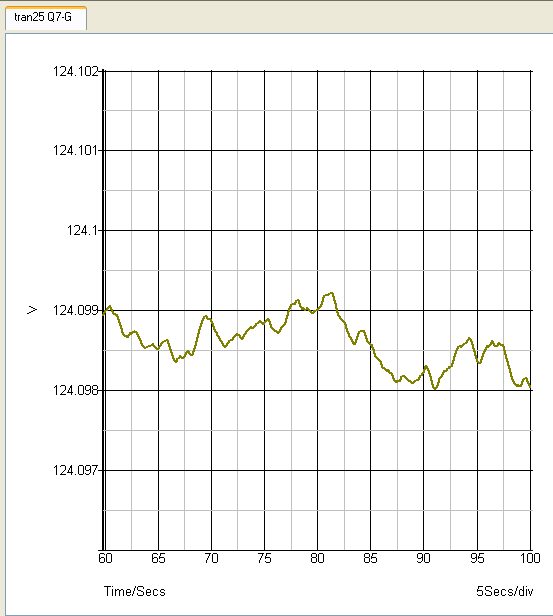

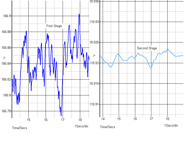

I'm submitting a schematic that I simulated. According to Simetrix, the voltage is smoothed considerably with the second stage.
I'm seeking this particular method because I wish to use higher voltage (125v) on my mid-stage mosfets. I'm not very comfortable operating a chip voltage regulator at this extreme.

carpenter said:
The problem with increasing the values of C5 and C6 is that high voltage caps are expensive. I'm trying to keep this thing affordable.
If you have a cap in mind that will do the trick, let me know...🙂
Ah yes, you're running in the 125v range, I'm just running in the 50v range. Really don't have anything in mind, have just been curios what changing these values would do. Thanks Carpenter
No replace r34 with a CCS such as a CCS diode using a 10ma CCS instead of the 15k resistor r34 then select a resistor value to use instead of a zener stack. In this case 10ma across a 4k resistor will give you a 40v across the 4k resistor. In this example
any input voltage between ~43v and ~143v (assuming a 10ma
CCs diode with a 100v complience rating) will give 40v across the
4k resistor.

The only cap that made a world of difference (according to the sim) was C5 and C2 (I'm re-posting the schematics in case something has changed).
I'm filtered down to just a tad over 1mV with a two stage regulator.
