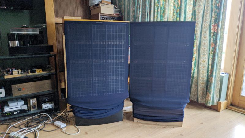

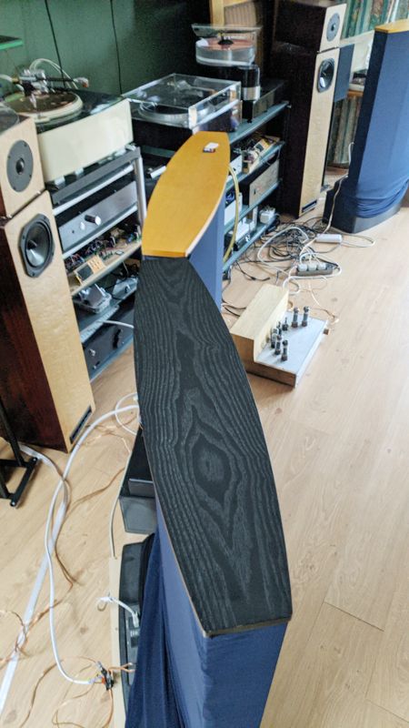

So there are a few threads here where people ask about stacking quad 63s - and as far as I can see, pretty much all of these threads die away after a few comments. Typically people comment to say how it might not work because of the delay line/point source thing, about how you place one speaker behind another at right angles, or to take the panels out and connect them all up together in a new frame.
Well folks, after nobody that I could find ever reporting on how it sounds, I want to report that I think it sounds wonderful!
Simply hooked up in parallel, both speakers at the same height (I prefer mine about a foot off the floor), with both speakers slightly angled so that they both point towards the listening chair. Impedance is halved, so a nominal 4 ohm capable amp is needed. It gives much better heft and impact, although as you'd expect it doesn't go lower. No smearing or soundstage problems that I could detect. In short if you have 2 pairs, and you have the amp, then there is nothing to lose to try this out - well bar the room that they take up!!
This probably works better in larger rooms, with both sets pulled out a bit from the back wall etc etc. Setup and angling makes a big difference, so do not neglect that.

@jan.didden - I know that in the photos they don't look "stacked" but they are connected up together in parallel. I wanted to have the middle panels closely aligned, and the idea was that each speaker points to the listening chair. I found a post or two that talked about having one speaker behind the other at right angles to it. I tried that and all life was sucked out of them, so there must have been some cancellation or something going on there.

Kevin - this is interesting to hear. When I was experimenting with positioning I realised it had a significant effect on the end result. I had the space side to side to fit them like that, up on supports about 12" off the ground, and each speaker is angled towards the listener. I reckoned I got the best result with this - the soundstage isn't artificially big or knocked out of whack, but you get all the extra impact and heft. The other thing, was I reckoned having the mid panels at the same height as each other was important.
I'll freely admit that I didn't try putting them in a frame on their sides, or one on top of the other etc, just because that would have been a big enough undertaking.
