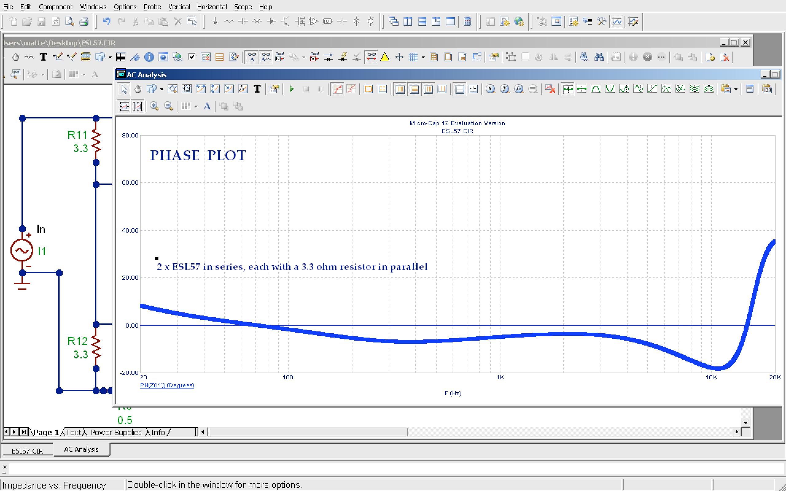

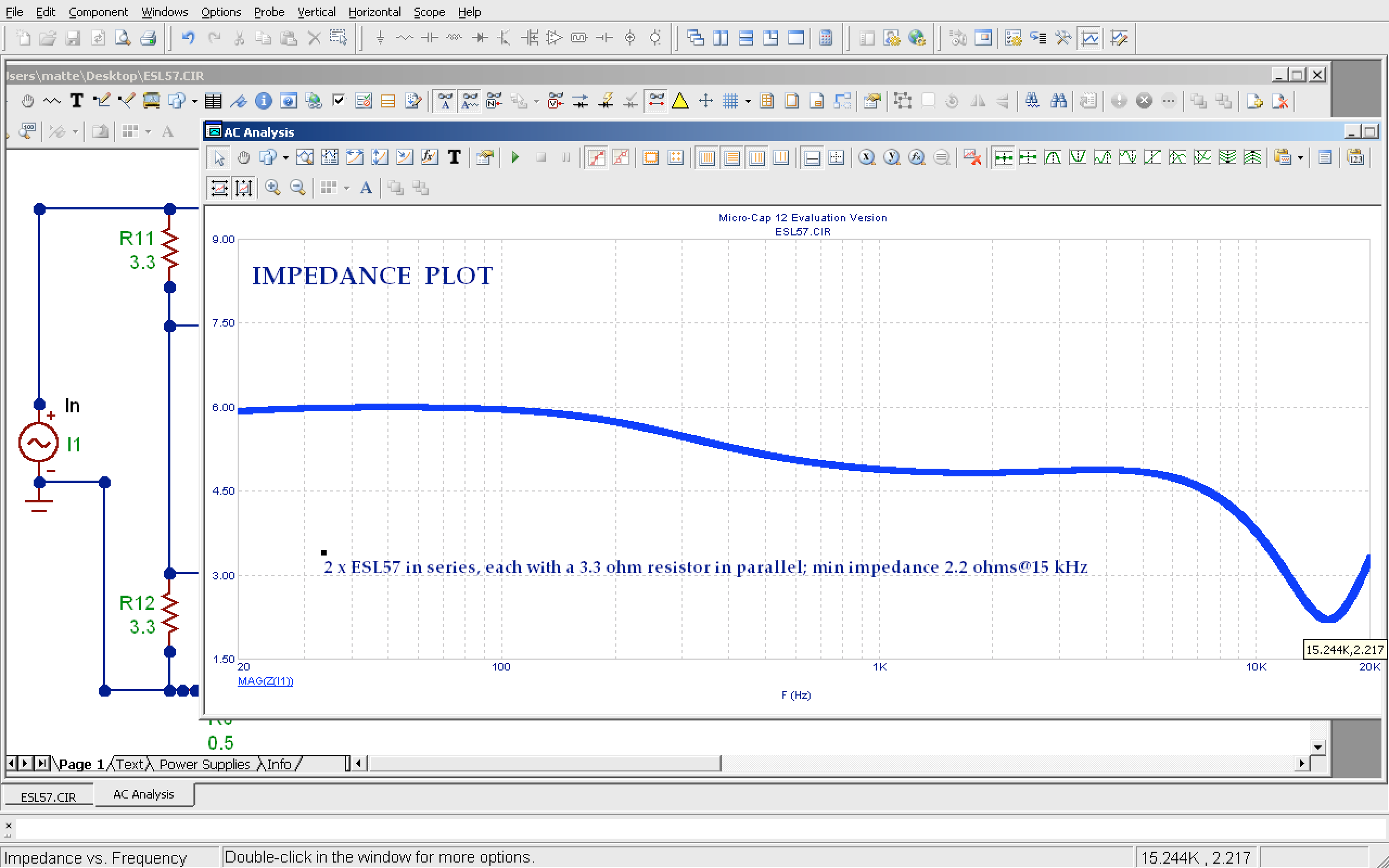

Yes, I first saw it as almost inconceivable as well, but a voltage divider is a good thing from the input power perspective, since i wanted to reduce the power to a level that is in the right ballpark for the 57s.

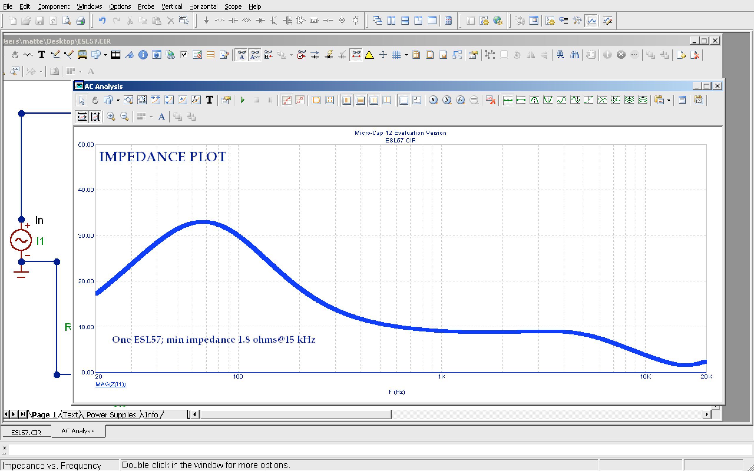

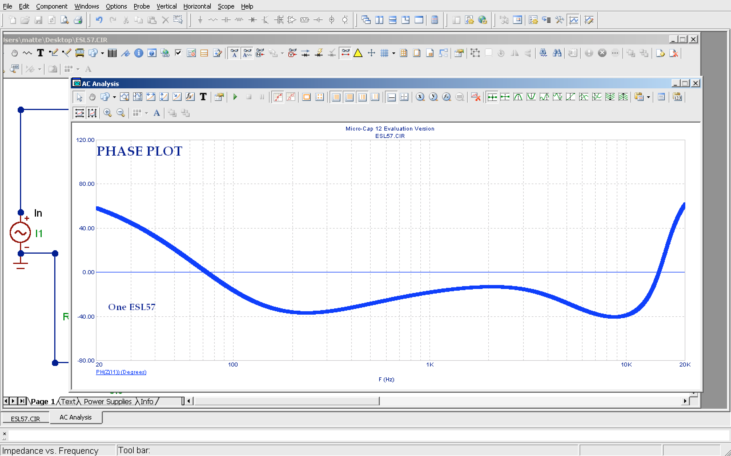

Agree the wild impedance plot is troublesome, but with resistors in parallel with each speaker, the voltage division becomes very close to 50% (checked at several frequencies) -- and the impedance plot seen by the amp becomes quite nice...see pics of simulation...impedance and phase plot of a single ESL compared with two 57s in series with resistors in parallel. 🙂
