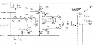

I have a Harmon/Kardon Citation 17. It uses stabistors in the output section. The one is connected to the base of a transitor to the +24v line. The voltage on the base is 23v. The other is is being used in the bias section. one end of the stabistor is .58v and the other end is -.75v. One end is connected to a collector of the predriver and the other end to the collector of the other predriver. The symbol shown is two diodes in series. Part numbers are 41624214 and 41634702. Can I sub them with something else? Just use resistors or simply do not use them? I hope I uploaded the schematic properly.
