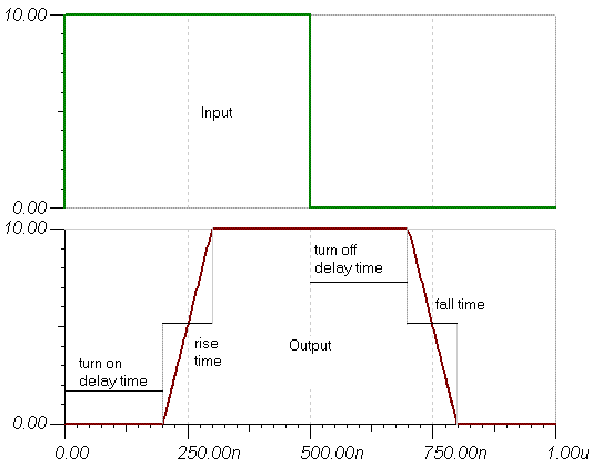

During transition of switching node the mosfets are in a much higher impedance state. This causes typically 2 regions symmetrically to 0 output current in DC output transfer function where gain is decreased. Drop in gain is increased with higher relative dead-time.

To understand this you have have to know the basic PWM waveform, inductor current, and a simple modell of dead time, and then combine them. If all of them are unknown, then I don't have time to tell everything, but if you know almost everything mentioned, then maybe I (or somebody else) can help.
But if you are not familiar with these kind of circuits and methods of analization, then forget all, and just reduce PWM frequency!
