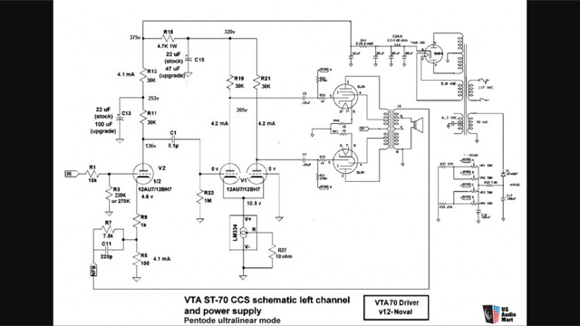

I read great reviews on Bob Latino's VTA ST-70 low-gain driver board with constant current on the phase splitters. Being the bonehead I am, I thought the St70 and the SA2 used the same output tubes and built a replica of his circuit, P2P, on the SA2. I also added Shannon Park's EFB circuit to it while I was in there.

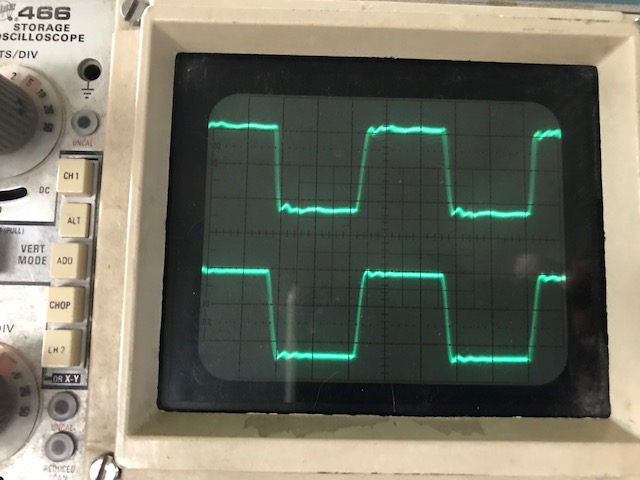

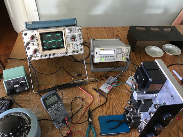

I even tuned the feedback a little, and checked the square-wave output at 10khz. Everything looked nice and squarish, and I think it sounds great.
I tested the output with an 8 ohm load, and it clipped at about 15wpc.

The attached waveform is 10Khz at 10w
The schematic is the one I copied
Should I expect any problems with my odd setup?

The EFB is trademarked by Dave Gillespie, it's not designed by Shannon Park, who merely ran some tests on his ST-35. Anyway, the VTA driver should be fine in the SA-2, as long as you don't crank up the input too high or it will overload the EL84's, as it is intended for the larger EL34's.
As a general sort of guess, a good driver circuit capable of driving EL34s will have an even easier job driving EL84s. The trick is ensuring the loop gain and compensation is still sensible when applied to an EL84 output stage, as EL84s need a lot less drive. If the feedback isn't excessive and the thing is stable then it's probably fine!

I haven't measured the gain yet, I'll do that next time I've got some spare time to haul the test stuff out of the closet. Is there a ballpark I should be in for the gain in an EL84 PP in ultralinear mode? I'm still using the 7.5k Ohm and 220pf feedback network from the V12 VTA driver schematic. I figured the 10k square wave looked OK and didn't change it. Do those waveforms look OK? I've gotten carried away with other amps I built and just lost interest. Trying to tread lightly with this unit. The slight oscillation in one channel appears to be a transformer issue. The square wave looks awesome at 1khz, BTW.

Yes, the 10kHz square wave response looks decent, but you should not have even a slight oscillation in one channel. You may need to tweak the NFB network a bit (or add a Zobel for that OPT) to get rid of it.
