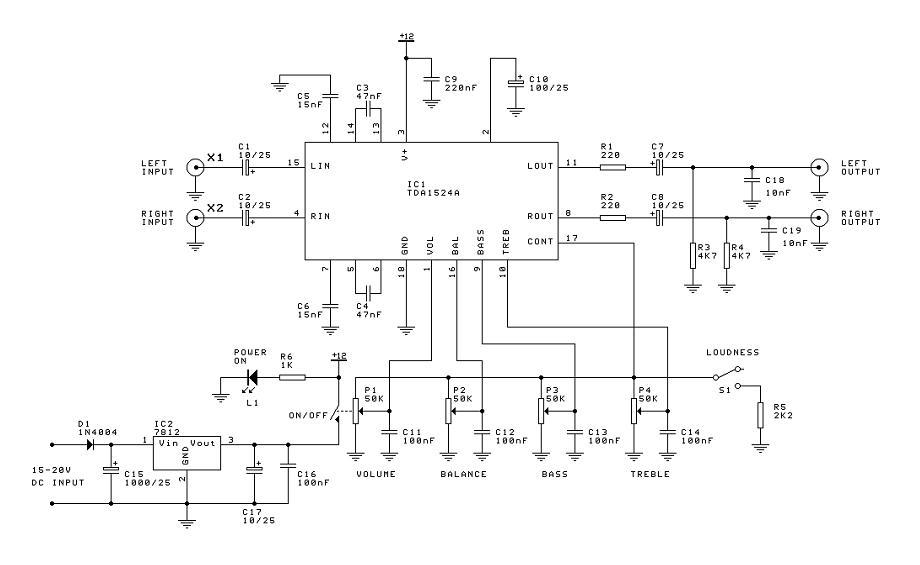

PRE-AMP TDA 1524A AS PER DATA SHEET

Here is the circuit straight as datasheet spec.what i mean by turning bass up i cant go past half on some recordings depends on the music but yes basically on most with a lot of bass.i had a visiter here and said that the cone of the speaker is hitting its end like one of u said but what i dont understand is surely their must be a way to safeguard against this.
txs john

I thought that would be the case, you have to keep in mind that the amp is capable of quite some more power than the speaker can handle, bass boosting means upping the power even more, even the kef s might not be able to do more than 50 watts. Have a close look at the power ratings given for the speakers, do the say RMS or music power, there is a vast difference ?? Does the magnet of the speakers heat up considerably ?? another good indicator of overpowering.
