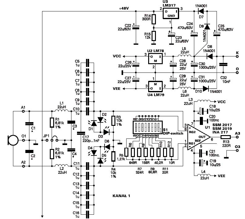

I've got the question about preamp I found. Thats project:
http://www.diyaudio.com/forums/attachment.php?attachmentid=195729&stc=1&d=1289283154
attachment.php
So, How to modify this preamp to reach unbalanced input with +/- 15V supply? Is it possible?
This should work as non inverted preamp.
How to connect -IN of SSM2019?
Thx
The schematic you are looking at is really designed for balanced inputs (seen this IC on a lot of microphone preamps). The IC is actually 3 opamps configured as an instrumentation amplifier. To make it work singled ended you can simply ground "A2" input however you will drastically reduce your Common mode rejection and degrade your signal, Not advisable for a design. You can always use an opamp input for your pre. Is there any reason you want to use this circuit?
