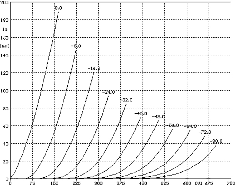

One other question, is there an online depository for load line charts for various tubes? I guess that's what you call them; the graphs with the grid voltage lines like the one pictured below.
After over an hour of Googling with numerous search terms I've come up empty handed. Maybe I'm not using the correct term for these charts.

The picture you showed is of the "plate curves" which are given in tube manuals and data sheets. For most pentodes, there are several different sets for various screen grid voltages. Choose the page that is closest to your intended screen voltage. Load lines are drawn on these curves.

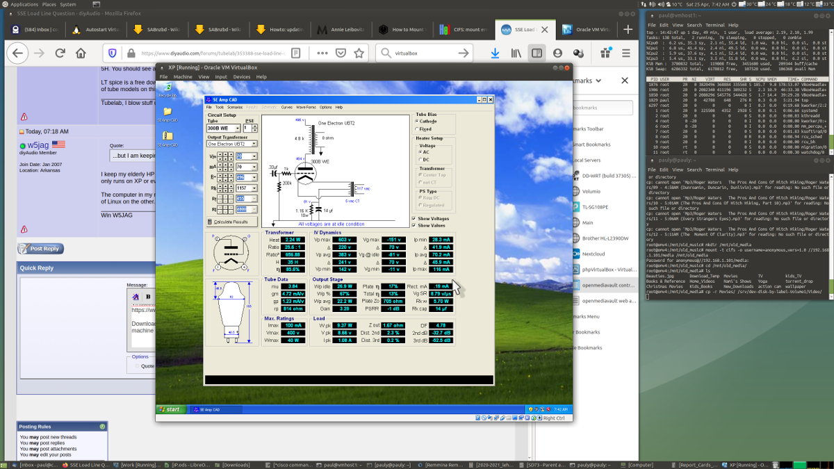

Folks, there just really is no excuse for not running virtual machines.
Virtualbox is 100% free and is stable enough for enterprise deployments, IMO. Oracle VM VirtualBox
Download and in stall it on Windows 10 or whatever you are running and then create a new virtual machine and install whatever OS you want - in this case Windows XP. It is dead simple.
Screenshot of my desktop (Linux) attached. As you can see, there is an entire installation of XP running in that window. The only reason I have it is to run SE Amp CAD. On my 6 core system with SSD, it takes about 12 seconds to boot it and launch SE Amp CAD.
