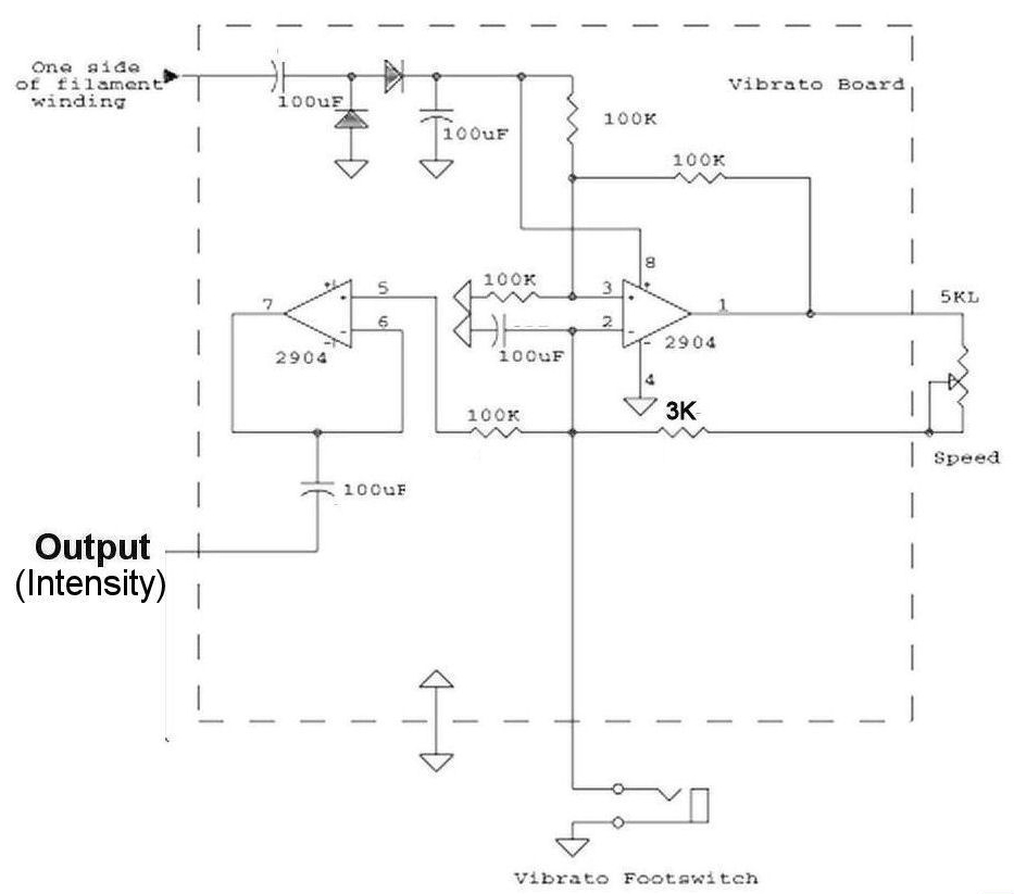

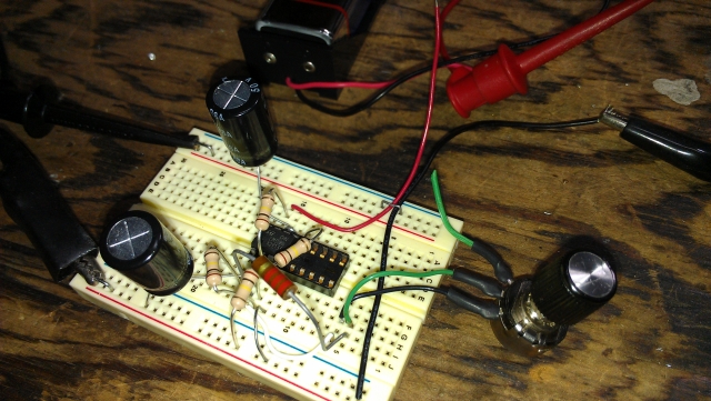

I realized I didn't have enough B+ to use a tube oscillator in my (Iso xfmr driven) line AC supplied intercom/amp, so I built the Weber circuit. They currently aren't selling it, supply problems they told me, so I just breadboarded it. Used a 9V battery (I like single supply OP amps!) - their circuit doubles then rectifies the 6.3VAC heater voltage - just to get it up and running. Only about 1.5Vp-p, now to figure how to integrate it into my amp!
Have been testing it, and it is more than enough! Varying grid voltage on a preamp tube by 1.5 volts (by varying the cathode bias with the tremelo) worked so well I had to put a 5K pot on the tremelo to tone it down.... Weber also has examples of inserting the tremelo in the DC bias supply for power tubes, which should notice a couple of volts up & down? Also, I'm only using a 9-volt battery. More supply voltage (up to 32 VDC) will increase output swing. You could push plate voltages around with that (perhaps - I'm pretty much still a newbie on this, but I'm learning).
Voltage doublers use large electrolytics at medium to high voltage ratings (not stuff I have laying around!), and I'm having good success just inserting it at the cathode. Probably will take 12VAC off a preamp tube (the last one in line - heaters are strung across 117VAC, tubes have 34, 50, 12 & 12 volt filaments), 1/2 wave rectify it, add an electrolytic, and have 10-11 VDC (Weber circuit uses a voltage doubler on a 6.3VAC winding). Best thing I've done to the original circuit is smooth out the "points" on the tremelo wave with a cap from pin 5 to gnd (thanks to help from a thread I posted on the Solid State forum!). Eliminated a "slapping" I was getting in the amp.
