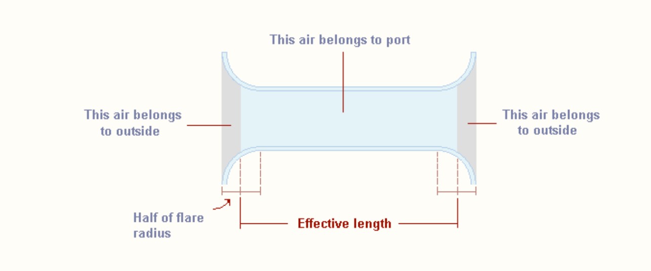

Thanks! Those were some helpful links. about the quested monitors. together whith a sub i can guess they will sound alot clearer than event opal. but they might be too big for that little studio i'm building the sub for. Anyways. The link you provided to Madisound had this little recommendation. "For a vented box of 2.5 cubic feet, 3" vent by 11" long, your F3 is 27Hz." wouldnt that port be a little too slim?
Port length grows up in proportion to the area (maintaining the same alignment).
Some considerations, if in your project you can have a straight port, without that 90º curve, that would be a bonus. I would have that in consideration for a studio. (Port Effective Length pic) 🙂
Flares for Slot Ports
Routed Port Flares
I used a plastic pipe with flares in my previous subwoofer build. the only thing i couldn't get through the software i used was the port length. that project was for a car sub tho. imjust thinking that i can reduce the size of the box with a slot port. and ofcourse ill make things as rounded as possible without a router wich i don't have or even a place to use it. But is it not better with a smaller chamber inside for more compression using that zigzag kind of slot port? Any other benefit of a straight port sonically exept for less turbulence?
