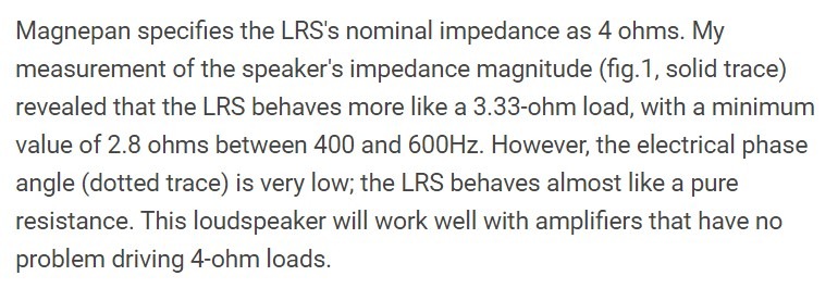

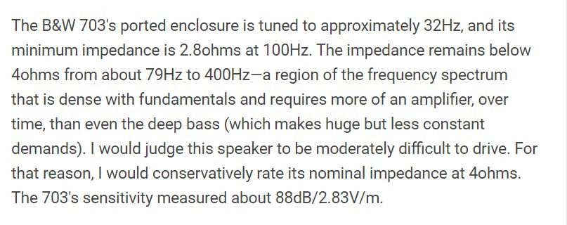

I see the B&K is a lateral FET design and all I can say is my own amp (Lateral FET) has no issues driving B&W703's which can apparently dip down to 2.8 ohms.
I bid on a B&K ST140 (2nd generation) and I'm aware of the low impedance issue with this amplifier. I will be using it with KEF LS50 Metas and Magnepan LRS...

otherwise brand new, that amplifier can drive 4 ohms no problem.
Some electrostatic may dip down to 2 ohms.
As with any amplifier, low impedance load has heat concerns
and can create more distortion. Just observe amplifier temperature.

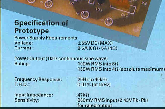

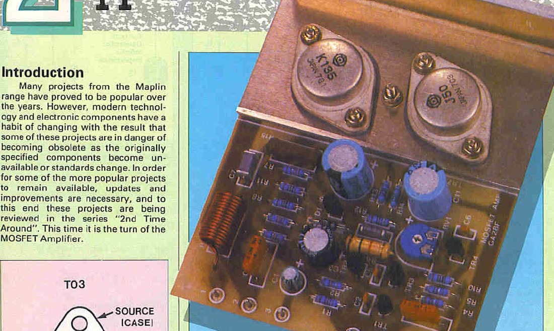

Having said that I looked at the ever popular diy amp from the 80's (the Maplin lateral fet amp) which uses the original single die 2SJ/2SK parts and that is rated at (gulp) 150 watts rms into 4 ohm and 100 watt into 8 ohm.
This generation has single pair of FETs...The next generation (3rd Gen) has two sets of FETs ....just so it can drive low impedance loads more easily.

And the Maplin/Hitachi style amplifiers being such a DIY favorite.
Would be a perfect candidate for a double die project.
