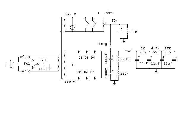

Ive decided to build an SRPP line stage as my first tube project. I have the power transfo as well as the tubes purchased. The amp will use 5687wb nos jan tubes with a b+ of about 330v. The problem I have run into is the heater biasing on the upper section. I was planning on using ac to heat the tubes, I have 2 6.3v windings at 2.5A and 1.25A. So I have enough current to supply both the heaters on seperate windings, 0.9A per tube @ 6.3v. My question is how to reference the supply for the upper tube without over coming the cathode heater potential limits, which is about 90v in my case. Should I create a voltage divider off of my b+ @ around 1/2 of the B+ voltage? Will A DC reference volage cause problems or should I create the reference before the rectifier tube? I havnt recieved the transfo yet so Im not 100% sure if the 6.3v windings are center tapped or not, Im a pretty sure they are not though. Any advice would be appretiated, or sketches even 🙂

You're pretty close. Set up a voltage divider string with the output at roughly 20-30V above where you think the cathode will be. Use that to float the heater voltage. It's best to use a CT winding with a hum adjust if you really want to use AC. But you might want to seriously consider DC.
If you're worried about complication, compromise by going from SRPP to a plain vanilla voltage amp. It will do fine for that magic First Volt.
Heater to cathode insulation is indeed 90 V either way (+/-) but with 900mA AC running through the preamp it's going to be tricky to make it inaudible.
Running DC is a lot quieter but regulating it will require a low drop regulator.
6.3*1.4 = 8.82 so the reg can only lose about 2.5V, not impossible.

I think I will go for DC just to try to reduce noise as best as possible. For example if I have a cathode value of 160v If I had my heater set up for roughly 180 to 186.3 that would be sufficient? Would I bennifit from running a solid sate rectifier before my rectifier tube then running the voltage regulator, or would running right of the rectified B+ be sufficient? Is it possible to float DC biased heaters if so what would that look like? Is a pot a good idea for adjusting DC bias as well or is a fixed value ok? Just trying to iron this power supply out at the moment, its starting to make more sence though🙂 Just for interest sake I have 420vct which I want to tube rectify with a choke input, the rectifier and choke havnt been picked out yet, any advice on that would be great too, I have 2A @ 5v available to me. The idea is to get a nice quite power supply with a B+ of 330vdc , haha a worthy goal.
Markedward,
Use a 5AR4 as the B+ rectifier. Your trafo's 5 V./2 A. winding is quite adequate for the 5AR4's heater requirements. Another good thing about the 5AR4 is its relatively low forward voltage drop.
For the P/S filter, a 10 H. unit of appropriate current rating feeding a 47 muF. cap. paralleled by a 10 KOhm POWER bleeder resistor forms the 1st section. Follow the 1st section with individual LC sections for each channel. 10 H. and 100 muF. in the paired 2nd sections should do nicely.
If you go with a DC heater supply, use Schottky diodes for rectification. Schottky diodes have a LOW forward voltage drop and ZERO switching noise.
An "easy" way to construct a DC heater supply is to use a full wave voltage doubler made from Schottky diodes feeding a cap. stack of 2X 4700 muF. 15 WVDC 'lytics. The doubler feeds a 7812 3 terminal regulator. Follow the regulator with a 10 muF. 25 WVDC 'lytic. Snub each 5687 heater at the socket with a 4.7 muF. 25 WVDC 'lytic in parallel with a 10 nF. CERAMIC cap. Apply B+ bias to the heater's center tap. BTW, connect the 2X 6.3 VAC windings in parallel. You need 4X the DC draw in AC RMS.

IMO that would be best.
If you measure 160V on the cathode with respect to the heater and your cathode to heater insulation maximum is 90V it means you're 160V-90V = 70V over the allowed maximum.
In order to counterbalance that you'll need to inject at least 70V from the B+ into the heater to bring it within limits.
A little more won't hurt at all, quite to the contrary.
In your example you'd be pushing the heater positive with respect to the cathode by 26.3 V.
You don't want that either, the heater can theoretically emit electrons although it would exhaust quite rapidly.
Not sure what you have in mind here....
If you mean to ask whether biasing the DC heater in the same way as shown for AC heater then, yes.
A pot is only useful if you want to toy with different tube types, other than that a fixed voltage divider works just fine.
A 5Y3 would be more than ample for the 5687.
Keep in mind that a choke input type filter will lose quite some more volts than a capacitor input.
Predicting how much is tricky but apparently PSUD can do it quite well in software.

Your design sounds very good, I am planning on simulating it this week in circuit maker if i can manage to get the tubes simulation working properly. Just one question about your design what do you think the current output would be given a 100ma ac rms value from the transfo. Im a little conerned it might be a bit low to drive 2 double triods.

Mark,
Don't confuse the heater supply with the B+ supply. The 100 mA. RMS of your B+ secondary will easily yield 100 mA. DC with choke I/P filtration. That's enough for a SMALL power amp; it's MORE than enough for 4X 5687 sections.
The heater supply requires care. When you use a voltage doubler, the AC RMS current needs to be 4X the DC draw. If you connect both 6.3 VAC windings of your power trafo in parallel, you WILL have enough current. Use 2X 40 PIV/5 A. Schottky diodes to form the doubler. The initial surge into the 4700 muF. filter caps. is NASTY. Over engineer and avoid problems.
Use a 5687 in each channel. Bias the heater center taps off the B+ supply to about +60 V. You kill 2 birds with 1 stone. Noise is reduced and exceeding the heater to cathode potential limit is prevented. Don't forget to float the DC heater supply. The only connection to ground for the heaters is via the bias voltage divider across the B+ rail.

>>There are no negative effects of running one tube per channel?<<
As long as you bias the heater off the B+ to prevent exceeding the heater to cathode potential limit, there are no negative effects. As a matter of fact, separation is slightly better using a dedicated "bottle" for each channel.
