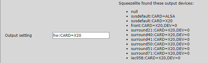

and thank you for your reply. I don't expect to turn on the DAC and resume where I left off. I choose play on another track, album but even though the sqeeuzelite player is visible in the Logitech media server web application there is only silence in the speakers until I reboot RPI.
I googled a bit and it seems I am not alone:
Topic: Stuttering or no sound on resume every morning or so… PCM2707 USB DAC | Max2Play
Trouble is I am already using hardware name of the soundcard.

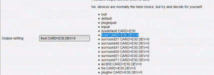

I know this is an old thread that I'm resurrecting, but I also had this issue with a new install.
For others that may trip across this in a search, I found the solution here:LMS could not reestablish any USB connection after USB Dac is disconnected - Page 2
Basically, try the 'front:CARD=<DAC>,DEV=0' line as your 'Output setting' value on the Squeezelite settings tab of your piCorePlayer WEB UI. Worked great for me!
