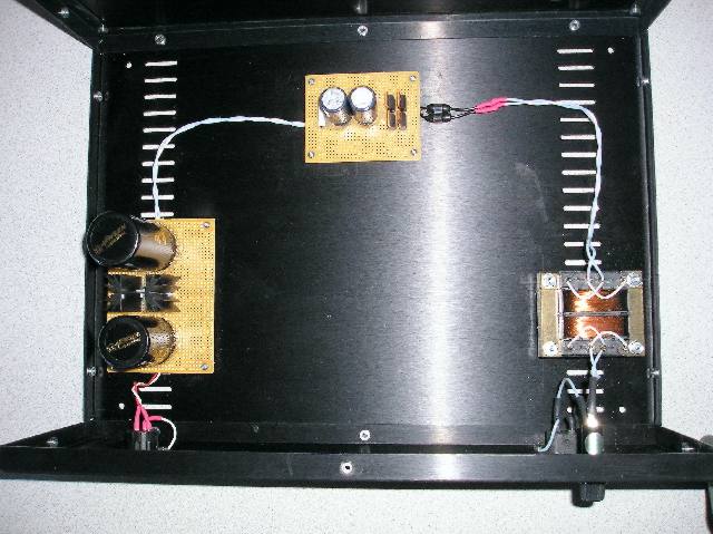

Hello, for my first DIY work, I would like to build a "audiophile" power supply for my squeezebox. 220v to a 5v 2.5A.
Has someone a good shematic fot that and advices about best components to use ?

(For your transformer, use a 25 VA rated, primary for your voltage = 240 VAC and a secondary of 18 VAC ... fast blow fused to 1 Amp on the transformer input / line cord / plug in the wall side. This will allow you to plug in just about everywhere = from 120 VAC to 240 VAC = 9 VAC secondary to 18 VAC secondary, respectivly. Feed it through a full wave bridge rectifier ...)

Do you really need 2.5A? Seems an awful lot to me, and you'll need more than a 7805 to provide it.

Well, IMHO, stringing 5 or 6 7805's in parallel is unlikely to beat the performance of whatever supply the device came with.
If you are a newbie, a super-regulator might prove too difficult. If you look at the following post and built the +ve circuit with an LM338, you might be very happy in the end:

There is. Those older fixed regulators are noisier because they use a cheaper voltage reference. Why do you think you see so much use of the LM317 on this forum? You think all those countless DAC designs use the LM317 for 5VDC because the designer is too stupid to figure out that a 7805 exists?

Many thanks for all these replies, not sure I understand everything...
In fact, I checked the Squeezebox, and it constantly needs 1100 mA (with wifi and display on). That's why I thought about 2.5A for this power supply.
The "positive-voltage regulators" shown by FastEddy will be too difficult for me to built (first DIY work
I think I can handle with leadbelly's link to "enhanced regulator Altus Audio" but what regulator should I use ? And what values for the other components ? I don't know what kind of transformer will be the best one (toroidal or other) Are 9v 25VA right ?

what's the brick say?
So, what exactly is written on the existing wall wart (brick) ... 9 VDC ?? 5 DVC ???
What exactly is the output of the existing wall wart ?? ... 25 watts?? 15 watts?? 10 watts??
Knowing this, it is quite easy to add extra filtration to your existing wall wart without resorting to building a complete power supply from scratch ....

It's a very small and light brick 5v 2A made in china 😱So, what exactly is written on the existing wall wart (brick)
(I have a bigger one for my cell phone 🙄 )
I asked for the 9v 25VA for the "enhanced regulator Altus Audio transformer".
The Squeezebox needs 1.1 A.

No! Power supplies are not that simple. If you add extra capacitance, you raise the output impedance, possibly making it sound worse. If you don't understand the theory, you should be building to schematics.

Obviously a switching supply.
My favorite inline filter for this type is two inductors, one in each line (+ & -) with a 1.0 uF. Poly or MTF Capacitor (to 35 Volt rating) in between the two cheap inductors ...

Yes, you are right, it does ... and that is exactly what you want from a power supply's output filters = increased impedence to any frequency above 1 Hertz ! === Increasing impedence to noise and hum.
Note that the use of inductors and/or capacitors does not "raise the output impedence" of the output DC, direct current/voltage.
