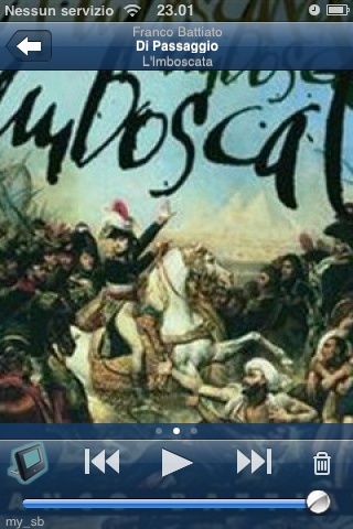

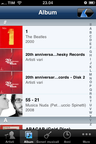

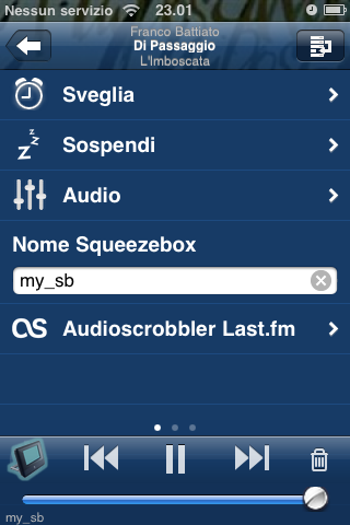

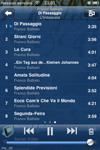

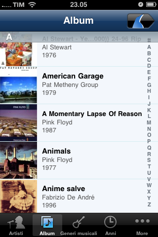

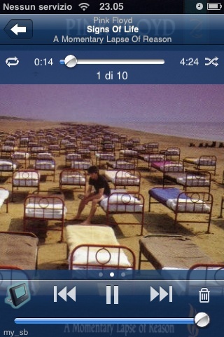

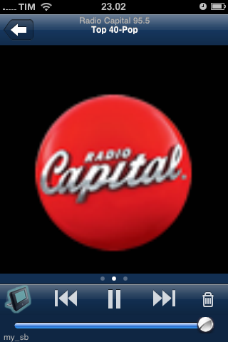

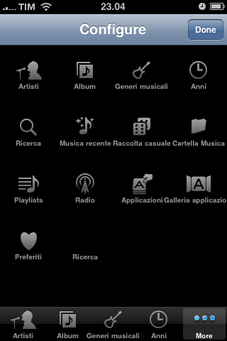

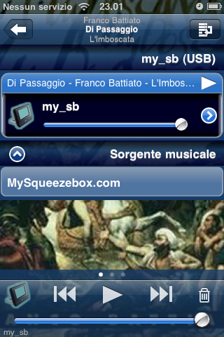

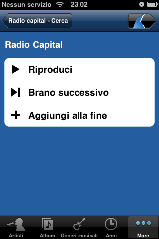

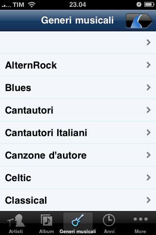

Then screen can switched off on SB Touch 😉 and can use iphone/ipod to control the player from everywere in your home, and sounds very well 😉
