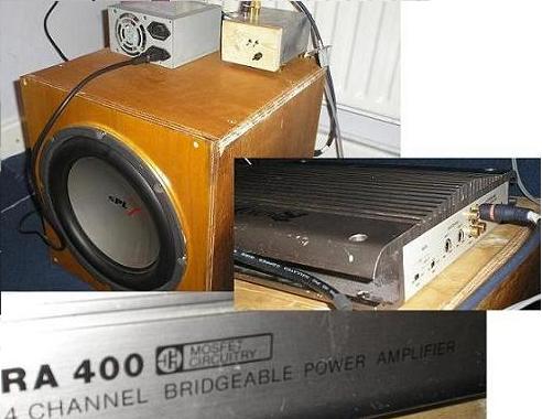

As you may or may not know, I've built a Linkwitz Transform sub recently, and have a new problem today. This time its not my electronics, but my driver. My cheapo SPLX 12" car subwoofer occasionaly makes a squeek in time with the bass, that seems to eminate from the centre of the cone. Could be something to do with the voice-coil stressing perhaps?
Can anyone tell me whats going on?

Hi Mike,
could likely be the voice coil former touching the back plate of the magnet assembly.
This is nothing to worry about as such, you just have reached your mechanical excursion limit for that driver. The likelihood of destruction is small if it doesn't happen too often, but don't challenge your voice coil former too much, though - the back plate is stronger.
Could also be something else, e.g. clipping of an amplifier stage. This would have to be determined before a solution can be found, I'm afraid. 😉
One question: by writing "occasionally", do you mean something like: at exceptional excursions due to high SPL and/or low bass content?

Hmm..
Hello Sebastian,
I think an op-amp could be clipping. Because I'm using a car amplifier running off an old AT powersupply, and the fact that the protector light goes out at the same time, suggests clipping. The AT supply is only putting out 8amps max. Also I'm not sure how powerfull this car amp is. I also think that if the coil former is hitting the back plate, it would be a knocking sound, more than a squeek.

Whatever the exact cause, mechanical noise from the driver means you're pushing it too hard. I suspect the LT circuit has too much gain, pushing your driver to its limits and overloading the amp and power supply at the same time. LTs put huge demands on the system, and if it can't cope, it will go bang eventually.

Yes. For LT to work at low frequencies, you need a good driver, and a powerful amp with a good PSU. With respect, it sounds like you have neither.

Hi mikee55,
Your AT supply is 8A 12V that makes 96W. How much power does your amp draw, or supposed to give?
A voltmeter or much better a scope will tell if your 12V is up to the task.
pinkmouse is right, LT is going to put severe stress on amp and driver. How much gain diff from LT do you have at most within your wanted sub bandwidth?
Have you done any driver excursion analysis with your LT applied?

Hello, pinkmouse I don't wish for you to take me the wrong way either, I just felt I'd be laughed at for throwing together a load of cheap parts in a design like this. I can't afford 1000 watts of muscle to drive a Tempest or Peerless XXLS, I'm just getting along the best I can. I've had too many people laugh at me in my life it makes it difficult to ask for help without feeling small or I shouldn't be asking. I've had a lousy childhood, and that effected my education. Everything I have learnt has been through asking people like on here. My confidence is low, so I feel inferior.
Sorry for waffling...
I was originaly using a Technics amp, that was dead on one channel it was a Technics SU-V2 and I'm now using this car amp. A post on an ICE forum has just thrown up that its a cheapy amp of which lots were made.Its 4 Channel Mosfet job so I assumed it would have been advertised as 4 x 100 watts. Its chassis isn't as long as the 600W version.I'm using just one channel. The only graph I can show is of the Transform spreadsheet. I have the T/S parameters written down too.

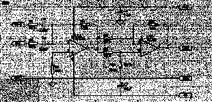

As I thought, too much gain. Try knocking the gain down to 10dB. With the small size of house in this country, room gain will pick up the difference. One of the other sim programs has a graphical indication of required power and excursions for a given filter. I can't remember what its called offhand though. Have a google.

Yes you could connect an amp meter (if it's up to the task) in series and if current approaching 8A (probably) you are in trouble.
Excursion test, in a sim program for example the popular WinISD Pro program there it is possible to add your LT and watch power and excursion plots.
One example with values from your spreadsheet:
We apply 10W, at 50 Hz there is no gain from LT, so therefore 10W to speaker. If we just lower frequency we get:
At 30Hz there is approx 10dB gain from LT so 10*(10^(10/10))=100W
At 20Hz there is approx 15dB gain from LT so 10*(10^(15/10))=316W
If I got this right you will see the rapid change in required power in order to keep response flat. So reducing gain a bit is a good idea. As mentioned before, room gain is going to fill in.
I mean that if you have a voltmeter, connect it to your supply while playing loud. Your supply probably have current limit close to 8A and if exceeding that it is not going to supply further current so your voltage will drop, easily seen on a voltmeter.mikee55 said:I have a volt meter but no scop, and wouldn't know how to do an excursion test with LT applied.
