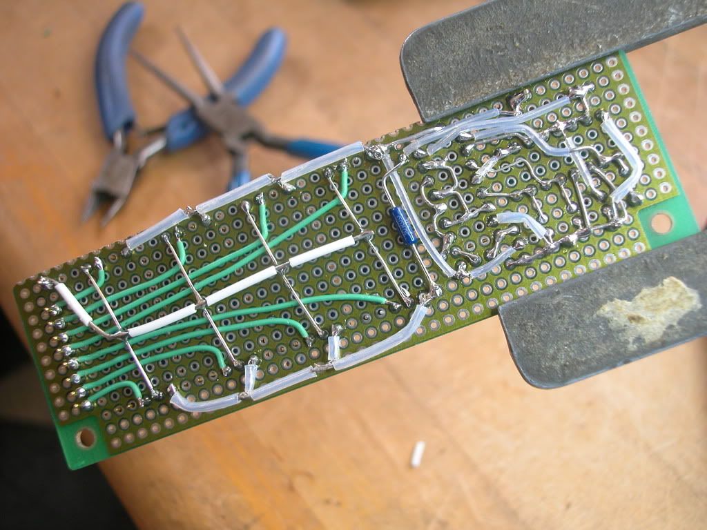

If anyone wants to draw a quick schematic, I'll volunteer to build some of these designs and do a mini "shootout", and post the results. (that is, IF my usual "point to point" proto building technique won't hinder the performance too much...I'm pretty good at it though http://i5.photobucket.com/albums/y177/Midiot/DSCN2897.jpg }

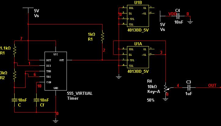

I have 4024b.jgedde said:The 4040 is also a good choice. I'd personally go with the 74HC393 which will give you a whopping 450V/us slew rate.
What to do with the unused pins ?
Looks nice, Mooly.
=RR=
redrabbit said:
I have 4024b.
=RR=
Unused input pins get tied to ground or Vcc.

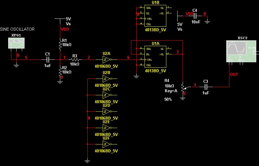

jgedde said:Try this... It uses what you have in stock. Don't forget power and ground on the 4013 (not shown).
John
Alright, I'll try those next.
Did you draw up those tonight ?
Thanks, I appreciate it !!

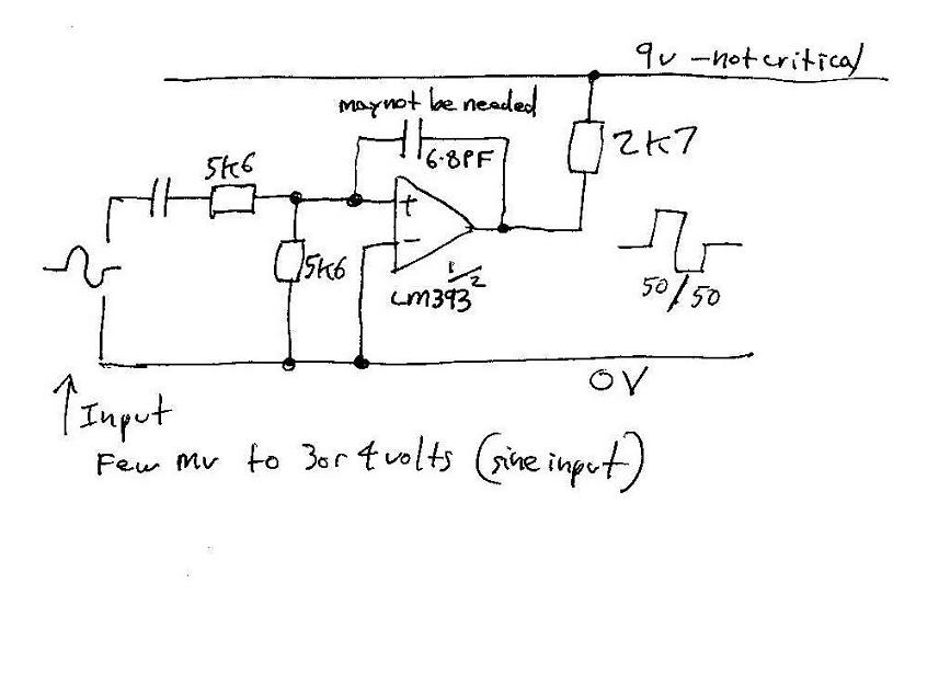

jMooly said:This works,
would form the basis of a nice little project. As jgedde says the output is affected by capacitive loading so a buffer required. It doesnt come much simpler though.

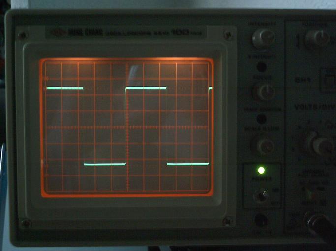

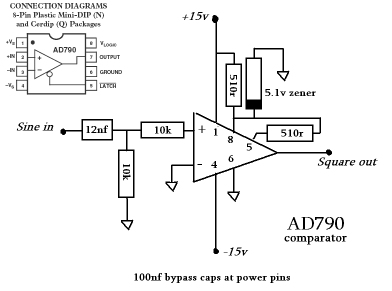

Yes, it does work.
I used an AD790...it has a couple of extra pins to deal with.
My scope had a bit of trouble triggering it at low freq, at under 200 hertz.
Drawing
