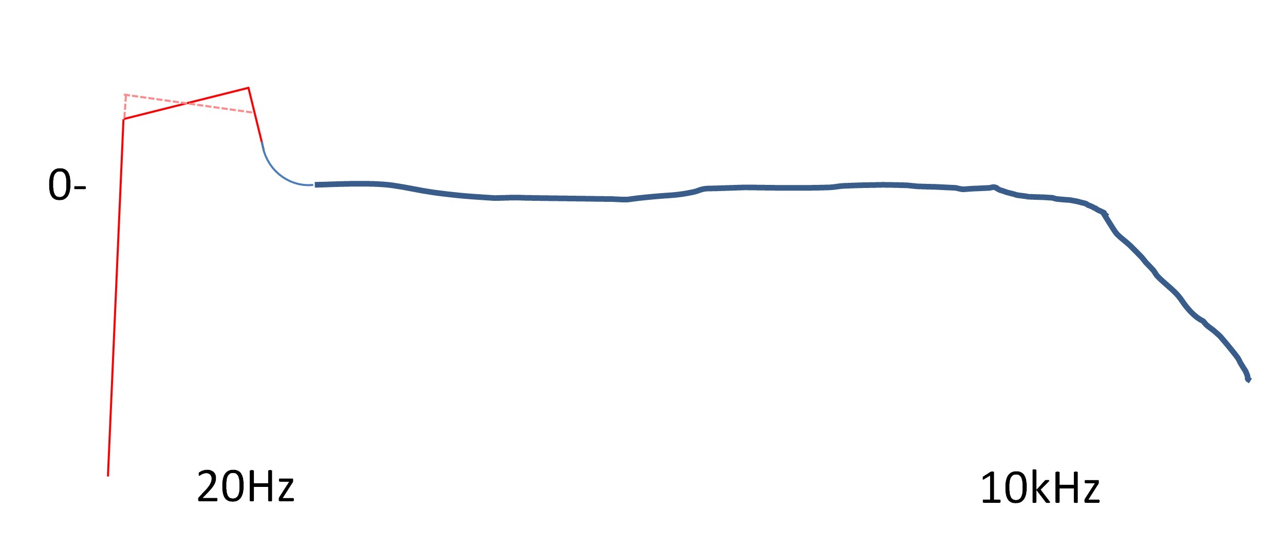

Hello everyone
Hope you can help me. I changed the Output Transformers in one of my tube compressors. I used a LL7903 wired inverse 4:1.
The point is that I am getting a square wave peak at the very low end. No idea if it is resonance. The load impedance is 9K6 (tube output with decoupling cap [1.5uf]).
Do you know if a RC Network at the OT primary can help with this or is better to use another OT?
Thanks in advance.
LL7903 is more a microphone step up transformer.
It is specified for +10 dbU 0.1% distortion at 50 Hz when all primaries are in series; that is some 2.5 VRMS.
Used inversed the transformer should accept some 5 VRMS at 50 Hz for low distortion; for 20 Hz no more than some 2 VRMS.
Likely your tube compressor puts out too much; you would need a bigger transformer.
