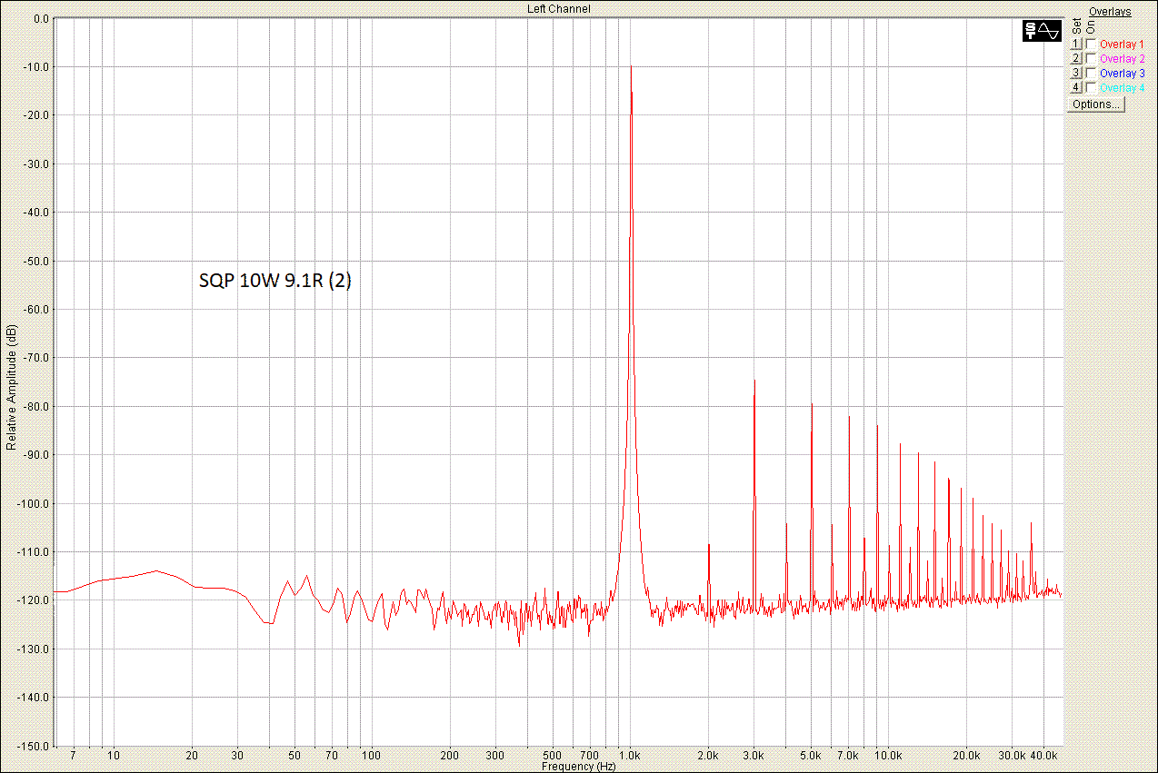

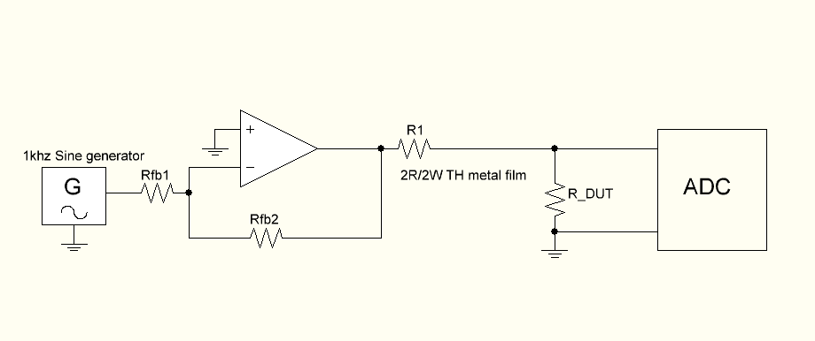

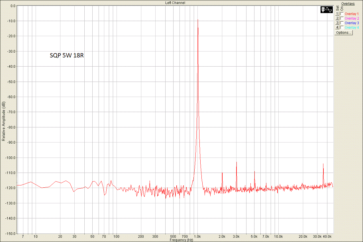

To test various resistors for linearity, I have assembled a setup according to the provided schematic, where the tested resistor is denoted as R_DUT.

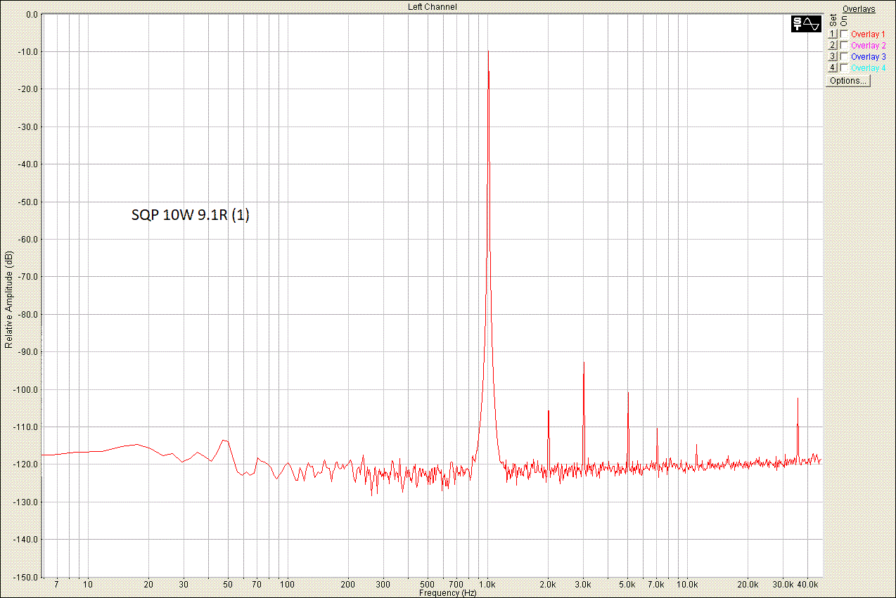

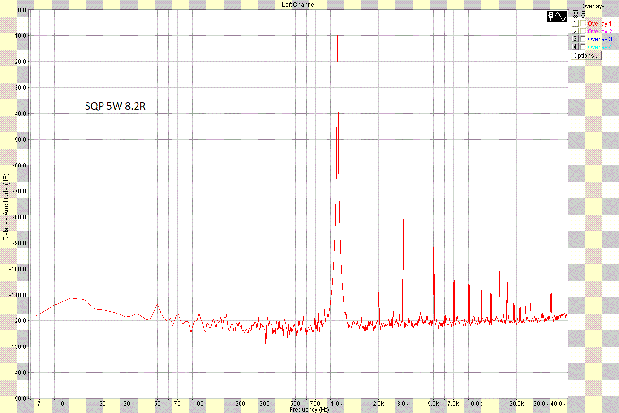

As evident from the measurement results, certain SQP resistors introduce a significant amount of harmonics (distortion) into the test signal, and the spectrum of this distortion is dominated by odd harmonics, which are well-known to be the most unpleasant for the human ear.

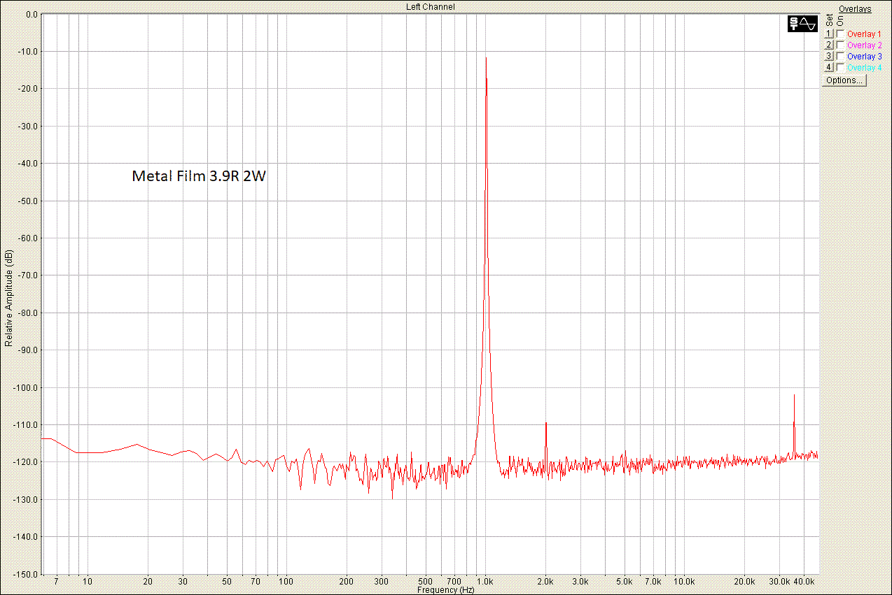

Metal film resistors do not produce measurable distortion.

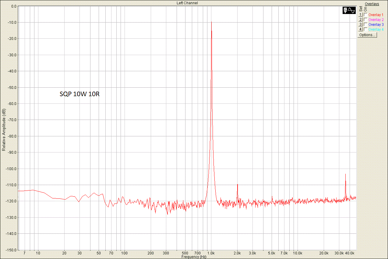

It can be observed that the amount of distortion produced by different SQP resistors also varies. Some SQP resistors generate minimal distortion. What is the reason for this?
I have discovered that high distortion is characteristic of resistors wound with wire made of an alloy containing a significant amount of magnetic material (most likely nickel). Conversely, resistors wound with non-magnetic or weakly magnetic wire do not introduce substantial distortion.

Here's some anecdotal evidence that supports this. I built a high power dummy load for testing power amps. I used two 4 ohm 300W wirewound resistors, which could be configured at 8 ohms (in series), two separate 4 ohms, or 2 ohms in parallel. These resistors are 35mm diameter and 220mm long wound on a tubular ceramic former.
Using a Tektronix SG505 sine generator and AA501 distortion analyzer (good to 0.001% THD) I was dogged with anomalously high distortion on the amps I was testing. I eventually built up an array of Vishay TO220 packaged metal film resistors on large heatsinks, which worked with no additional distortion problem.
I've just hauled my original dummy load out - and the resistance element is strongly magnetic, and the solder tags are exceptionally magnetic.
On the basis of that, I can well believe that a strongly magnetic resistance element can give rise to a high level of harmonic distortion.
I have used the distortion inducing resistors in applications where harmonic distortion is not a problem - but they are now always used in those applications.

Wirewound resistors sometimes have a high distortion level. This has been discussed on the forum, here for example, and elsewhere.
There seems to be a correlation with the magnetism of the resistive element, but I think it is just a correlation, not a cause to effect relationship. The mains culprit seems to be the contact between the terminals and the resistive element, and it is probably more difficult to ensure a good quality, purely ohmic contact with some resistive alloys which also happen to be magnetic
Didn't there used to be some popular high end resistors that used copper endcaps? IIRC the endcaps loosened over time so were unreliable. The manufacturer switched to steel endcaps which stayed secure, but the sound changed for the worse. It caused some people to stop using the new version.
If the wire is ferromagnetic it will exhibit non-linearity dependent on the current level - for uA or mA signals this is not normally significant or even measurable, but at high current (amps) its definitely a thing, the non-linearity of the inductance of the wire due to ferromagnetic behaviour is becoming visible as the magnetic flux density increases. This is true whether or not the device is inductively wound, note, as there is inductance directly in the wire itself.
The standard resistance wire(*) alloys, nichrome, constantan, manganin all claim to be non-magnetic, although they contain ferromagnetic elements like nickel and anti-ferromagnetic elements like chromium - perhaps some resistance wires use formulations that are magnetic? Or the alloy specification is loose enough that sometimes it is? Or some cheap devices use steel(!?)
Its well known than many terminal posts and relay frames are steel and have measurable distortion due to ferro-magnetism for high-currents (speaker wiring, basically).
Poor bonding of terminations in resistors can give rise to distortion. Resistance alloys don't solder I believe, so some sort of spot weld / cold weld / brazing is needed for wire-wound resistors - if that is low quality then bad things can happen.
(*) Resistance wire has a low temperature coefficient of resistance, unlike pure metals which have large positive coefficients, and some resistance alloys handle very high temperatures in air without oxidizing away so they can be used in electric heaters.
