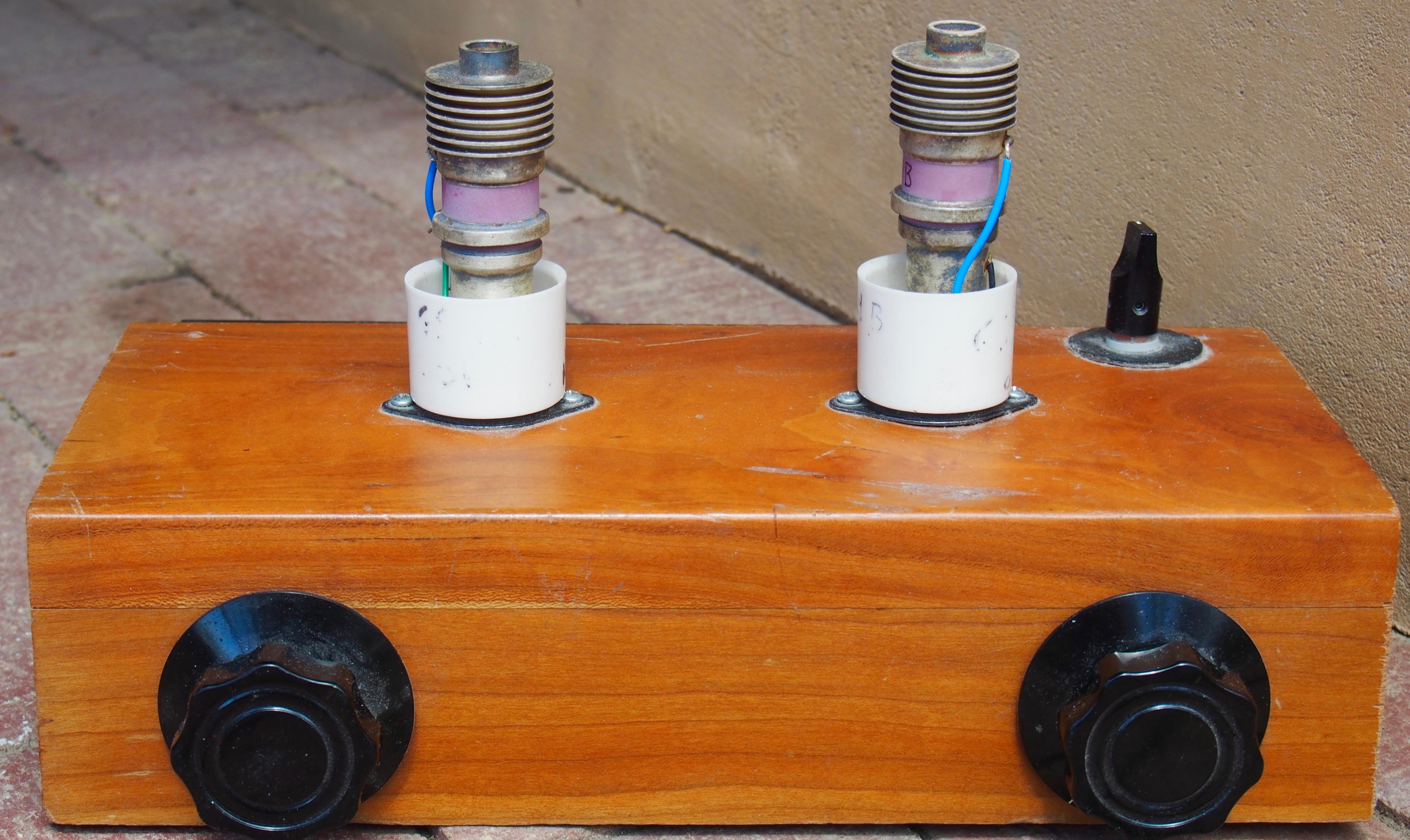

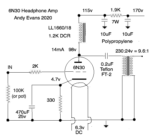

Update: I finished off a basic parafeed circuit, using toroidal transformers as the OPTs. Very cheap option and I'm very impressed indeed with the sound. I used a Lundahl LL1660/18mA just the primary as a plate choke because I had a pair available. A cheap option would be Hammond 157G like Hagerman uses in the Tuba. I have a pair of Hammond 126B doing nothing, and I could use the primaries of that, which would allow up to 30mA.
Sound is wonderful - everything I hoped for. So a generic parafeed circuit like this, which is very similar to the Hagerman Tuba for example, or most other simple parafeed designs, can really make your cans come alive. I've attached the circuit I used for reference. One thing to watch out for is high frequency oscillations in tubes like this. Not what you want in headphones. I didn't use ferrite beads in this case, but I probably should have and may retro-fit them. Power supply is in a separate box, and I stole it from one of my preamp builds.

I think I have a better understanding of why your initial 4.5:1 LL1660s were not working well with your 62ohm headphones. I calculated a Damping Factor of 2. That's no bueno! But as you mentioned with 300ohm cans you would have been OK at damping factor of 7. Your 10:1 power transformers in the parafeed design you tried also give you a DF of 7. I've got a pair of 115+115:9+9 2A toroids from an aborted solid state project so I'm tempted to try them. In 115:18 configuration the voltage ratio would be about 6.4:1. With the 6c45p and my Sennheiser 6xx, I calculated a DF of 11. Might be worth a shot.

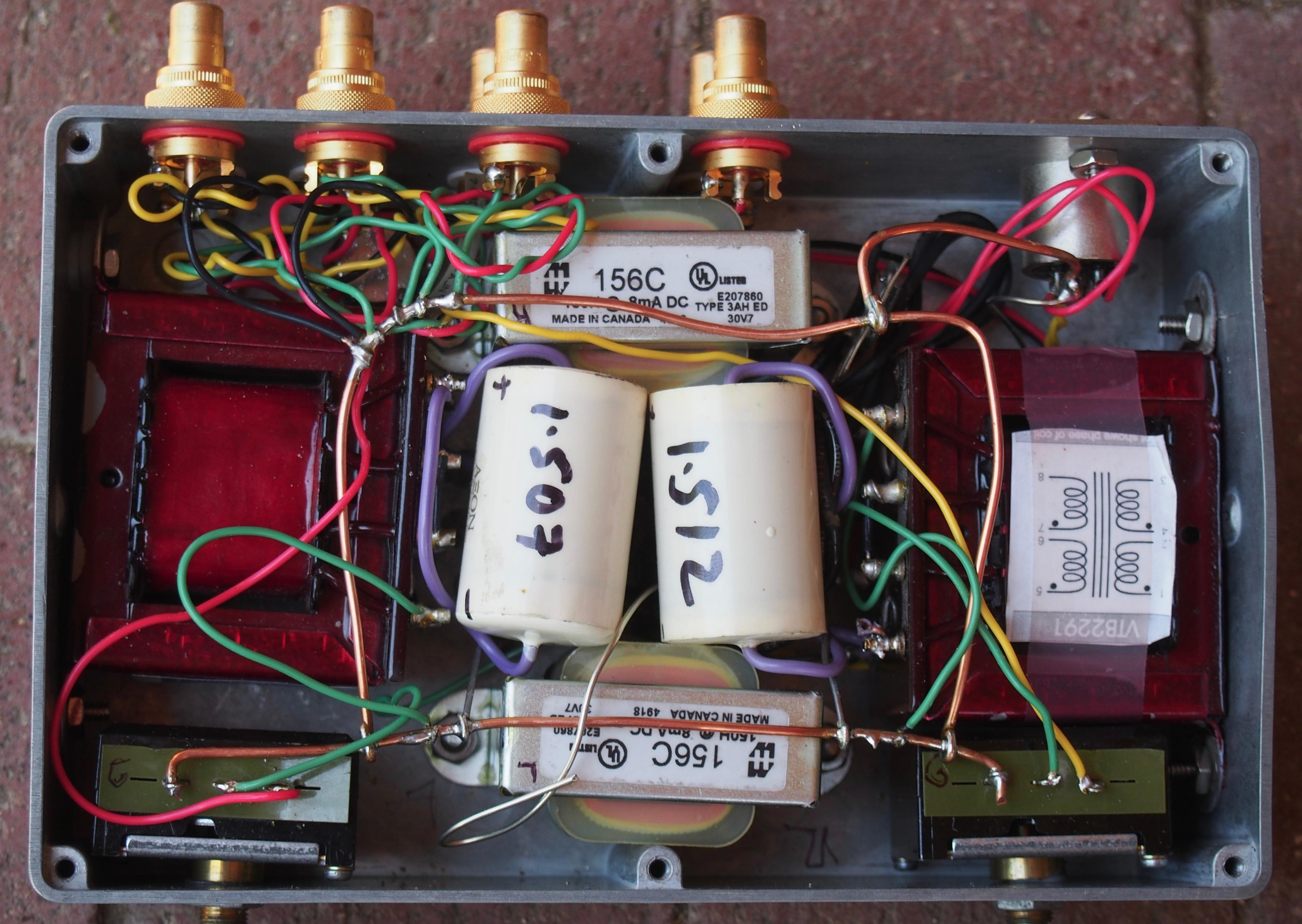

My update is that I abandoned the mains toroids - I was getting some kind of ringing somewhere in the system and I couldn't measure it.
I ended up with a 4P1L and Lundahl LL1689/PP in 9:1. By far the best sound. I was using a very nice amorphous core plate choke. I'll use this setup as the first stage in my 4P1L PSE amp and put a switch to switch between headphones and speakers. The NP plate choke and Lundahl OPT are overkill really. I'm wondering about some smaller OPTs. I have a pair of small Lundahl microphone transformers, LL1515. Can anyone tell from the data whether they would overload into a headphone? The current model is the LL1530

I’ve have many serial and parallel feed headphone amps with 600 ohm OPTs as I use them to drive Beyerdynamic 600 ohm headphones and drive long interconnects to my amp/speaker setup in another room.
All amps connect with umbilicals to a variety of power suppliers I use, 60V, 120V, 150V and 200V, or an adjustable bench supply. I also have an LCLC adjustable filament supply on a variac that handles DHT heading. I use stacks of lead-acid batteries for B+ as well as filament duties.
If you buy two extra Edcor XSMs you can use them as plate chokes if you want to try an all iron parallel feed version. Hook the primary and secondary in series for more H if you need it, or leave unused secondary open.
Edcor used to make GXSE5-600-5k (5k/600) and GXSE5-600-15K (15K/600). Both were series feed 5W rated outputs so good for almost any tube you wanted to try. Seems like they were around $20US. I don’t know why they are not currently listed but as they made them not too long ago I’m sure they can still wind them up. I mostly used the 5K version and usually with the trioded 6P30B-R. I cannot think of a better series feed output for the price.
A parallel feed headphone amp uses Quad Eight QEE 3436 outputs (20K/600ohm) and Electraprint AC9037 chokes (100H/10mA) with 1.5 Solen tin blocking cap. It was originally designed for 26, 01a and 801a, but I mostly use GS24B ceramic tubes in it. I know its not the tube for this but it sounds super.
A few months ago to use some un-gapped Carnhill VTB2291 (9.6K/600ohm) I had I added a plate choke (Hammond 156C) and squeezed it all into a 4.5 x 7.25 x 2.25 Hammond tin box.
