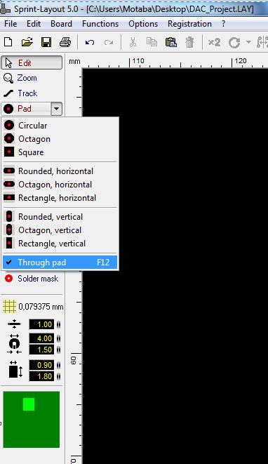

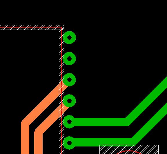

Till now i'm using Sprint Layout 5.0 for one sided pcbs fine.
I'm in the procedure of designing a double sided pcb for a DAC and i'm realy confused.
I put lets say a DIL28 (CS8412) in C2 side and now i need to add a track in C1 side connected to a pin of IC.
How i can add the pin pads in C1 side too? Only manualy?
Thank you very much.
I added 3 photos.

The pads should appear on all layers automatically. There must be some kind of
component or pads setting option in the program to do otherwise.
