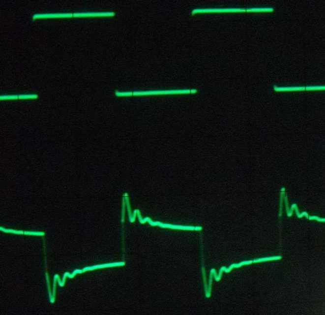

Second, when scope testing the unit hooked into a driver and recovery circuit, what kind of wave form should I see so I know that the reverb circuit it is doing what it is supposed to do? I breadboarded the driver and recovery circuits exactly as the Acutronics web site described, and hooked in the unit. I ran a sine wave through the circuit. The input and output wave forms looked exactly the same. Does that mean it’s not working? What does a ‘reverbed’ sine wave look like? I expected to see at least some disturbance of the wave, but it was reproduced almost exactly.
Try testing it with something other than a sine wave. The reverb tank can only delay the signal. If you take a single frequency sine wave, delay it, then add it back to the original, the output is just the same wave with the amplitude and phase changed.
A pulse signal should show the effect of the spring reverb.
With your test rig up and running monitor the output with the scope and then vary the test frequency. The output should go all "goofy" if it's working correctly. Varying the amplitude will get some "goofiness" but not nearly as much as the frequency.

Many thanks, that worked. I tested it with a square wave and as I increased the reverb level, the square wave sloped down. Actually, the rise level increased, rang a bit, then sloped down. Interesting. I guess I forgot what I knew about sine waves - add two sine waves and you get a sine wave. I could attach a phot of the scope if anyone is interested.
As you would expect, the shape of the wave changed as the frequency varied. Hope this info helps someone else.
By the way, I have the reverb located between two op amps in a two-stage tone control for this particuylar test.

If anyone is interested, I have posted a photo of a square wave of the reverb circuit. The top is the square wave from the function generator, and the bottom is the wave after it has been blended with the output of the reverb recovery circuit.
T Grant
