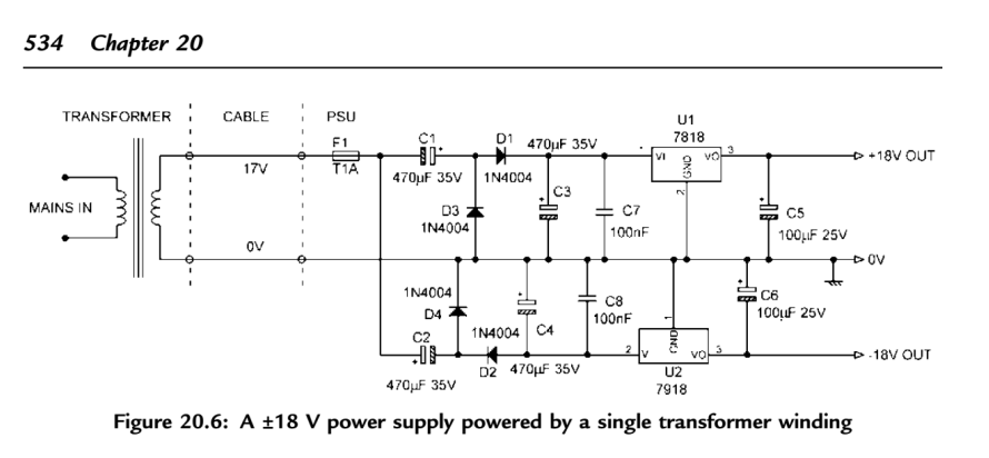

I have a nice spare laptop power supply that gives me clean +18 VDC. Douglas Self's book gives the attached solution for a split rail power supply off an AC wall wart - could I substitute my handy dandy laptop power brick where it says "cable" and forgo the diodes in Self's schematic?
Or is there an easier solution to get +/- 15VDC off a 18VDC laptop power supply? Using a voltage divider would give me +9/0/-9, which is not enough.
Then again, because voltage is relative, why wouldn't I just be able to put 18V and 0V DC straight to the op amps? If I understand correctly, the op amp won't care if it's [-9 and +9], [0 and 18] or [100000 and 100018] for that matter. Right?

That design from Self is great. Simple, with a real ground return but relies on the input being AC. The output of your supply is DC and if you hook it up the way you suggest you'll get good voltage (not saying clean) on your positive supply, but nothing on the negative. Like Andrew said, you'll need a virtual ground to use a single ended DC supply. The designer or the O2 headphone amplifier had a great page on virtual grounds, I recommend reading it to decide if that's the way you'd like to go: NwAvGuy: Virtual Grounds & 3 Channel Amps
Otherwise, to use the Self power supply you'll need to get the transformer he suggests. It would be much cleaner since filtering switching noise can be difficult.

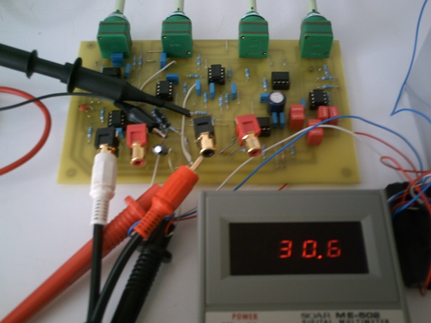

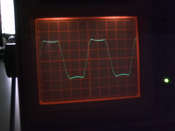

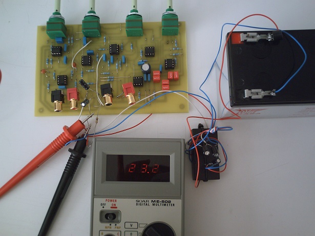

🙂 I'm going to disagree with Andrew on this. Practicalities...
I still have my 7 opamp D Self test PCB, and this is a low impedance version that uses 4k7 pots for bass, 2k2 for treble, 1k for treble turnover and 4k7 for bass turnover. So its not really suitable for TL072's because its asking to much to drive it fully... however...
Here it is fitted with TL072's and fed from a 12 to 15/15 convertor with 1 ohm resistors in the supply to determine current draw. This uses 7 opamps.
Current draw quiescent was 23.1 ma
Current draw at 16 volts pk/pk output at 1kHz was 30.6 ma
Current draw at 10 kHz and max treble boost purposely driven into severe clipping was 45 ma The scale on the scope for this was 5 volts/div.
For any normal music input and with levels around a couple of volts the change in current draw from quiescent is minimal.
The small convertors that are rated around 66ma per rail will easily power 6 TL072's under signal conditions.
