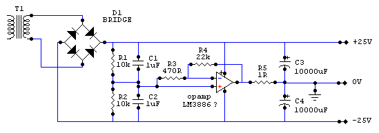

Only possible issue: can the TDA2030 operate in unity gain, and does it tolerate 100µ caps from the ouput to the rails?
My thoughts exactly, the TDA2030 is not unity gain stable and will probably oscillate.

I have used this circuit with great success https://www.diyaudio.com/community/...in-power-amp-applications.174791/post-2323212:
You can probably use a weaker opamp though, that chipamp can handle 7A of low frequency offset. And depending on what you want to power you might be able to use smaller caps too.
