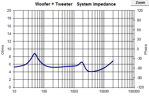

According to PCD 7 two parallel woofers will greatly increase bass response, is this right? (dB gain below 100Hz seems to be higher than that above)

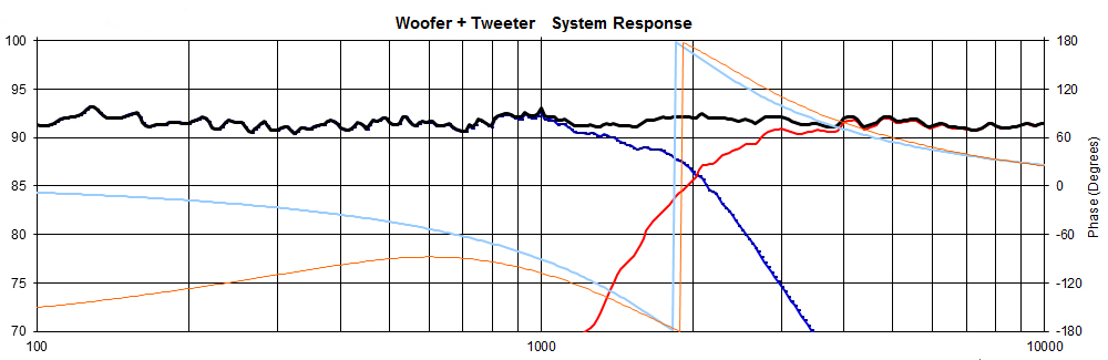

The obvious design questions are raised regarding balancing response and impedance, and the two woofers are theoretically more efficient than the tweeter. This has been solved with thin-wired inductors and a 4th order electrical crossover. Images of sim attached.
Also, I tried a 4th order electrical on the sealed 2-way but was very unhappy with the results, sound was just... bad (so probably need to re-measure impedance of drivers in enclosure as was working from manufacturer data for that) but this doesn't fill me with confidence for a floor stander...
If I go floor standing crossover costs will be lower, impedance lower, sensitivity higher, xo at 2kHz.
Stay on 2-ways and I'm basically at the finishing gates but unhappy with the sensitivity or performance unless using a 2nd order xo, which sounds bad at high levels due to the peaks in the midwoofer's higher response, and the tweeter is being pushed quite hard due to the 2nd order slope at 1.5kHz...

With your current speakers why are you concerned about "how hard it is pushing my amplifier"? Is it because you have the volume knob turned up higher than in your old room? An impedance correction circuit probably won't make an audible difference with a low output impedance solid state amp.

TMM has to be a 2.5 way, i.e. the lower woofer needs to be rolled off at around the baffle step frequency, while the upper woofer goes up to the crossover frequency. Remember that a 2.5 way is a full baffle step design.Alternatively I could switch to a TMM design (MTM is less likely solely for aesthetic reasons), that would be a sealed floor standing unit.
If you want both woofers summed at every frequency up to the crossover point to the tweeter you have to resort to a MTM because of the C-C involved (both woofer need to be close to the tweeter).
No. Driving two drivers in parallel has a gain of maximum 6dB for every frequency.According to PCD 7 two parallel woofers will greatly increase bass response, is this right? (dB gain below 100Hz seems to be higher than that above)
Frankly, you shouldn't have any problem in crossing both drivers at around 2KHz with a LR4 acoustic slope - usually with a 2nd order electrical on the woofer and 3rd order electrical on the tweeter. For your bigger room I'd opt for either TMM or MTM, for the gain in sensitivity. Only if you do a baffle step compensation of less than 3dB you'll end up with the woofers more sensitive than the tweeter.
