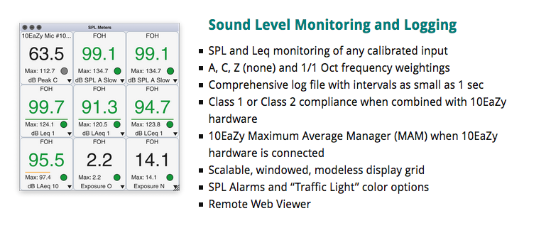

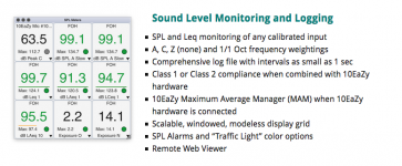

Smaart V8 does exactly what you want to do:
Smaart v8
I didn't read the manual (don't want to get tempted to upgrade from V6..), but looks like at least 6 mic locations are supported on one screen.
