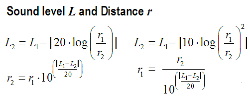

Im trying to calculate SPL attenuation over distance. I understand that for every doubling of distance, you'll have a 6dB SPL loss.
Therefore if i have 88dB @ 1meter, i can calculate what the distance will be when the SPL is reduced to 76dB. Using the attached equation, I am finding "r2".
This is a simple equation that calculates distance at which you have attenuation to a known / desired SPL level.

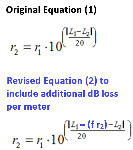

However, my difficulty is not determining the dB loss per meter of distance, it is difficulty in formulating the distance at which the dB drops to a pre-determined level, with the 6dB loss per doubling of distance and an amount of dB loss per meter.
I have attached two equations. The first is the simple 6dB loss of SPL per doubling of Distance. The second is 6dB loss of SPL per doubling of Distance, and dB per meter loss included. The dB number is "f". But now I have the problem of having r2 on both sides of the equation. I'm not sure if it's possible to solve this.

Thanks but it doesn't have the equations to consolidate both the doubling of distance attenuation, and attenuation by humidity (dB per meter).
As per the attachment in response to Art above, I have formulated an equation, but have a feeling its impossible to solve, without getting into complex maths.
I can calculate it in tables on a spreadsheet, but I'm looking for one equation to wrap it up in one hit, with varying inputs.
