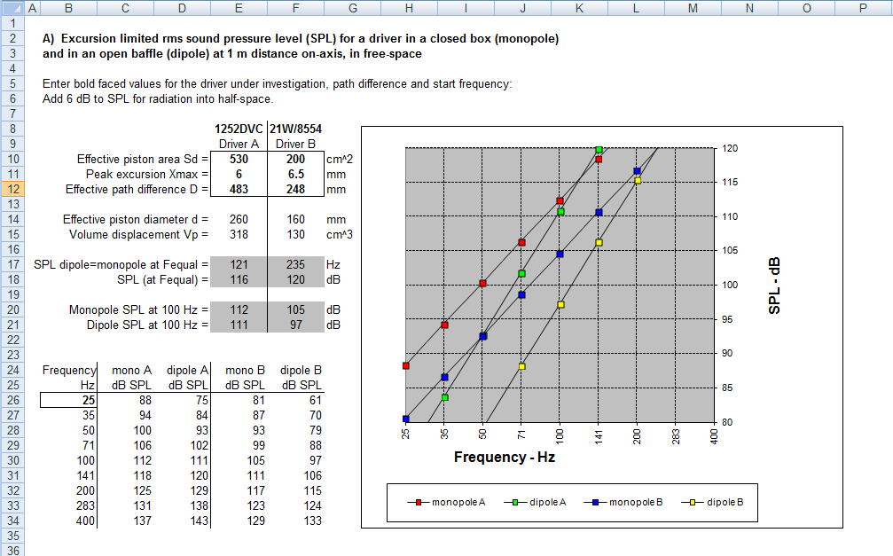

If you are after an estimate of max SPL capability vs frequency based on area and Xmax the spreadsheet geraldfryjr posted is a good guideline to manage your expectations as to what SPL is possible. It comes from Section 4 - Excursion-limited SPL Nomographs about 2/3 the way down Linkwitz publication page here: Linkwitz-Publications which will be kept alive for the foreseeable future.
Linkwitzlab Website down?
RIP Siegfried Linkwitz
Note that both the monopole and dipole calculations are based on point source models, so nearfield effects from large radiating area planars will not be captured. Still…a useful sanity check for obtainable SPL. The effective path difference “D” in the spreadsheet for dipole calculations should be set to the width of the planar or the width of the baffle if applicable.

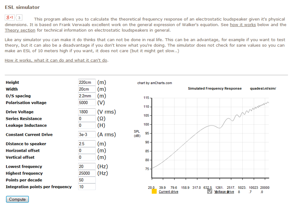

You might have also been thinking of Arend-Jan’s online ESL Simulator(pic #2) which sadly no longer available. Belated RIP: Arend-Jan
You can see the webpage on the "Wayback" machine, but the simulator itself does not seem to function.
Electrostatic Loudspeaker (ESL) Simulator
