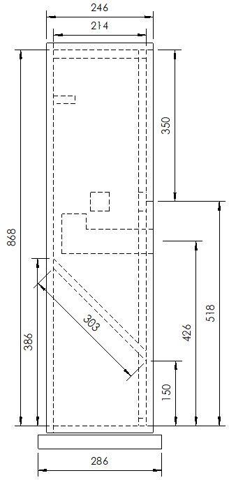

For WAF reasons, namely, my wife hates speaker stands, I've got to build them floorstanding. No bookshelves on stands in this house. So Im thinking the side and back panels will be longer, reaching to the floor, and the original dimensions will be there by means of a false floor inside the speaker cabinet. The baffle will be the original size, to deal with the 5 degree slant, and then will connect to a straight, flat piece that goes down to the floor or a base. It will be veneered, but I figure I can get the veneer to go over the 5 degree joint on the front pretty easily.
My sort of general question is, is this a good idea, or it will it just ruin the whole thing? And any tips or suggestions? Has anyone seen this or something similar done? Have pics?
I think you'll be fine. The false compartment will also allow you a place to position your xover.
I would advise damping the elongated walls on the inside, as I made a soundbar with unused cavities, and they ended up ringing to the music played because there was no damping inside. In my case, stuffing was all that was needed, but maybe an adhered foam sheet might be all that is required.

I was also thinking, damp the bottom part, at least partly with sand, and put a space for the crossover above it just under the speaker part itself. The sand will dampen the speaker as the unused part may resonate. And a brace on the bottom of the cabinet itself (under the normal bottom of the speaker) may also help to avoid that.
You could reduce the cabinet depth and use the available volume. I don't know the design well enough though. With floor stander cabinets always be beware of the vertical modal resonance and use some kind of volume damping (e.g. a piece of egg crate foam on a bracing panel) just below halfway the cavity. Move the reflex port to a position under that damping and it will have less port resonance.
Yes. Effective cavity damping on the port resonance frequency will reduce the port resonance output because the stimulus will be lower in level. Transmission loss through acoustic foam on frequencies of about 600-800Hz isn't great, but it's there. But you have to believe that port output is audible of course 😉
I've done a few small volume floor standers and used an angled panel to divide the enclosure. Saw this in a speaker I had from Ralph Waters (Richter) in the 1990s and been using it ever since.
The one in the sketch Vb=18 litres.

Thank you all for the excellent tips. I had not thought of adding bracing to the cavity, that is a great idea, and not too difficult, so I definitely will.
As far as Damping, Im going to look into this. Im kind of hoping it doesn't have to be sand, just because, well, sand... I mean what else could I use? No kitty litter either, we have a cat and I dont need him using my speakers as, you get the idea. Maybe some sound treatment I could stick to the walls instead? If I do use sand how far do I have to fill it?
Regarding using the additional volume to reduce depth or other dimensions, could definitely work, but I'd rather not, the design alteration gets beyond my knowledge. I would rather keep it as close to the original design as possible while addressing my WAF issue.
The angled bottom that's been suggested, by this I think you're referring to my false floor that I mentioned in the first post. I've got to wrap my head around this. Try and digest it. I dont have the speaker plans yet, I guess they come with the kit. Give me a bit to process all this and I may see about working that in.
