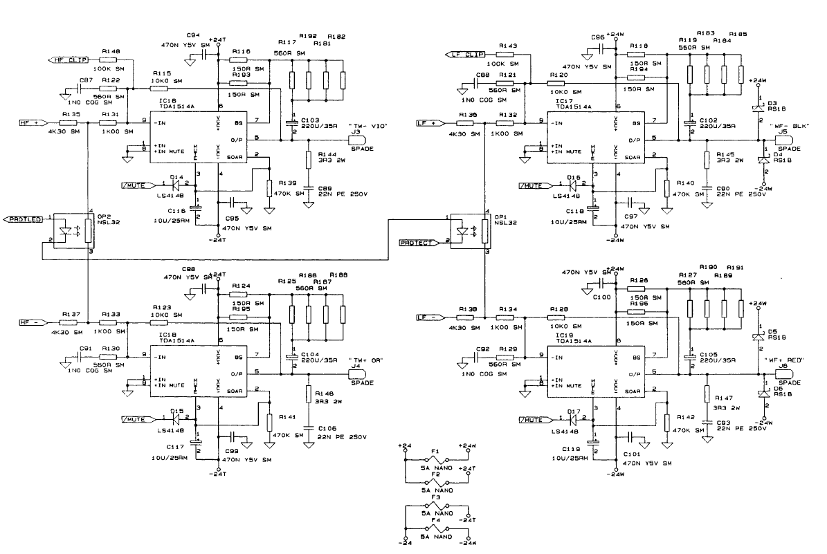

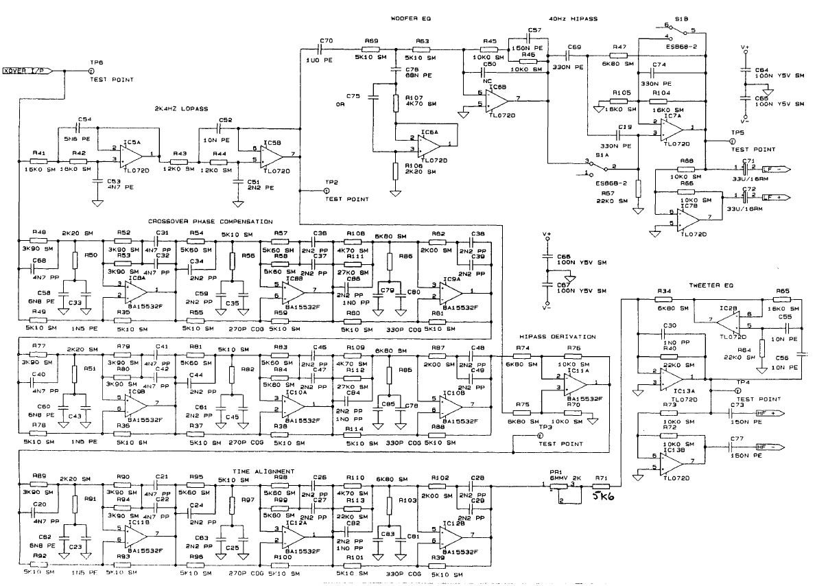

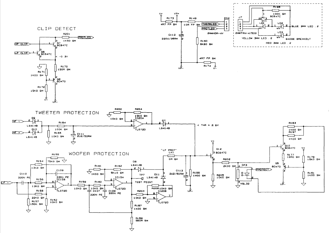

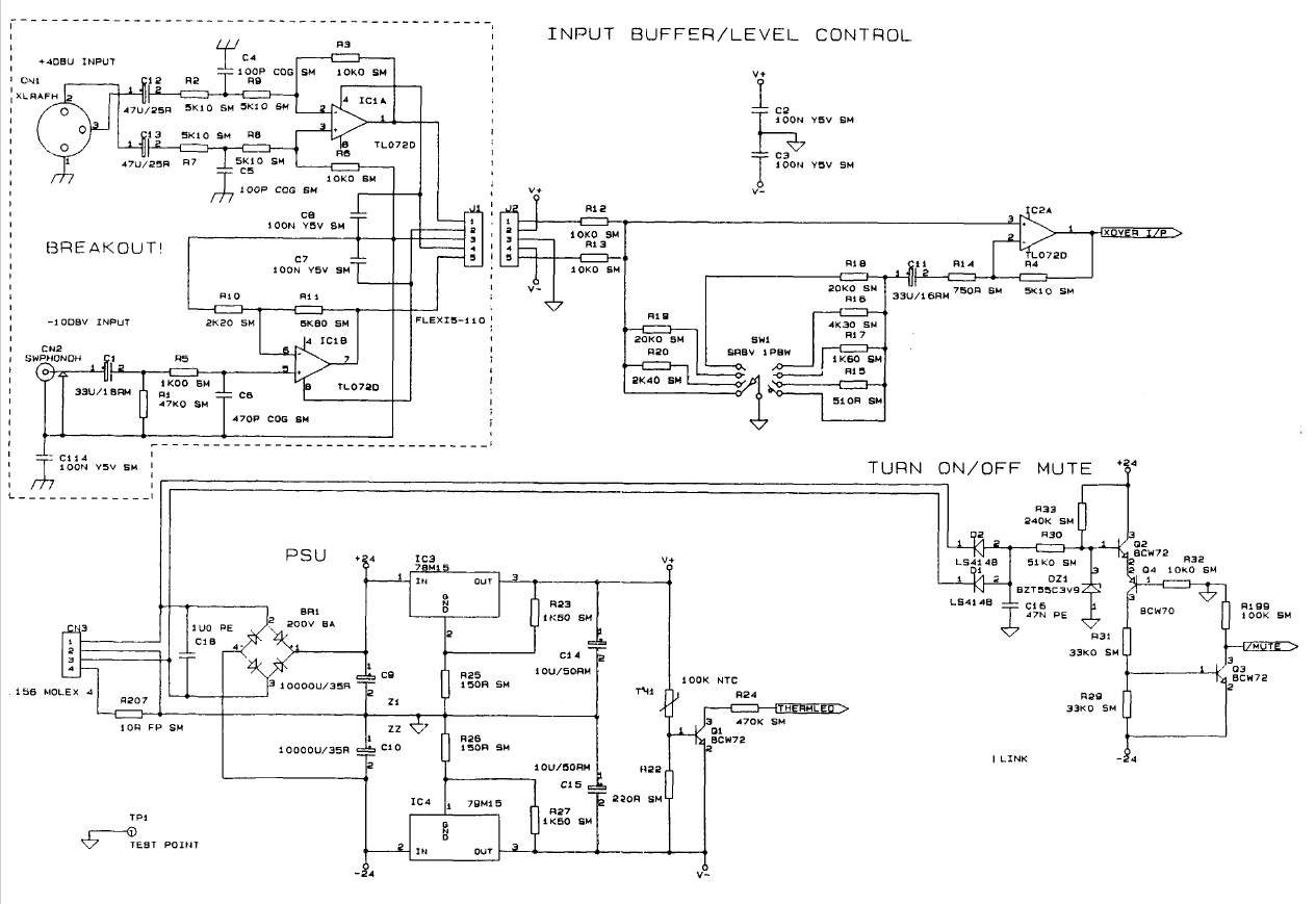

I've tried to manually copy/paste the schematics to .PNG's and attach them to this post.
As far as I'm able to interpret the schematics, there are no electrolytic caps in the "turn on/off mute circuit", nor are there any of interest in the woofer and tweeter protection circuits. I thinks those are based on optocouplers, that "short" the positive and negative inputs of the respective amps, thus lowering the outputs. But I could be wrong. I would suspect, however, that a any start-up delay would mute the woofer and tweeter so as to block any pops and clicks from the drivers. What could be the cause of this not working properly? Is this easily fixed (i.e. replacing a few parts)?

Regarding the power/on-off pop noises, I would direct my attention to C116-C117.
Loud hum/buzz most likely indicates that the 10000µ caps (C9/10) have seen better days, and possibly bootstrap capacitors C102-105 as well. Just make sure it's not mechanical though, and verify that both regulators are actually putting out their +/-16.5 V as they should, since results would be less than pretty if one were dead.
This is getting quite close to a full recap, isn't it? I wonder what they were using for capacitors, nothing first-grade I suspect. Either that, or they had a lot of active use. These look to be a bit over 20 years old?
I'd say proceed with that and see where you get from there. I would not expect a designer cautious enough to properly distinguish between chassis ground and signal ground (and connect XLR pin 1 in line with modern standards!) to make severe power supply PCB routing mistakes, but you never know.
Once you have this sorted out, I would take a listen to tweeter hiss levels, given that all power amps look to be identical.

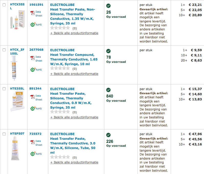

One more thing, though. Before tearing them down, I checked if I still had some thermal compound. Because will need that when putting them back together. I don't have any, so I'll have to order new.
The chip-ams themselves are mounted on a T-bar with silicone pads. But the T-bar is mounted on the heat sink with thermal paste.
Which one should I get? Is the higher W/m.K number better? How high should it be? 1.xx? 3.xx?
All quite expensive, by the way...

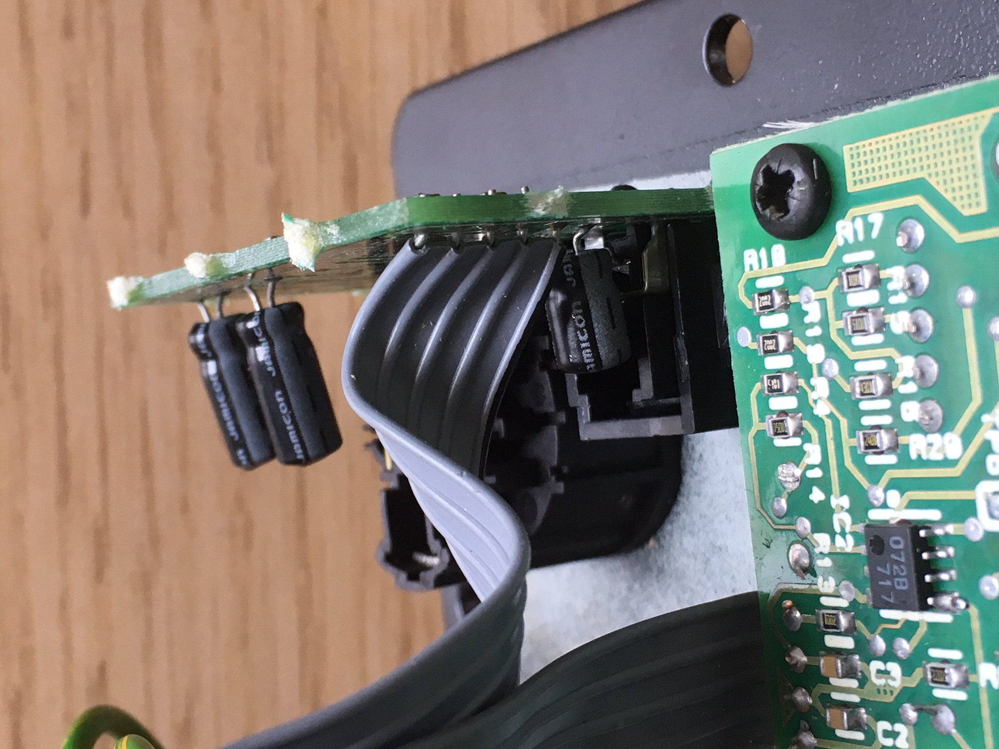

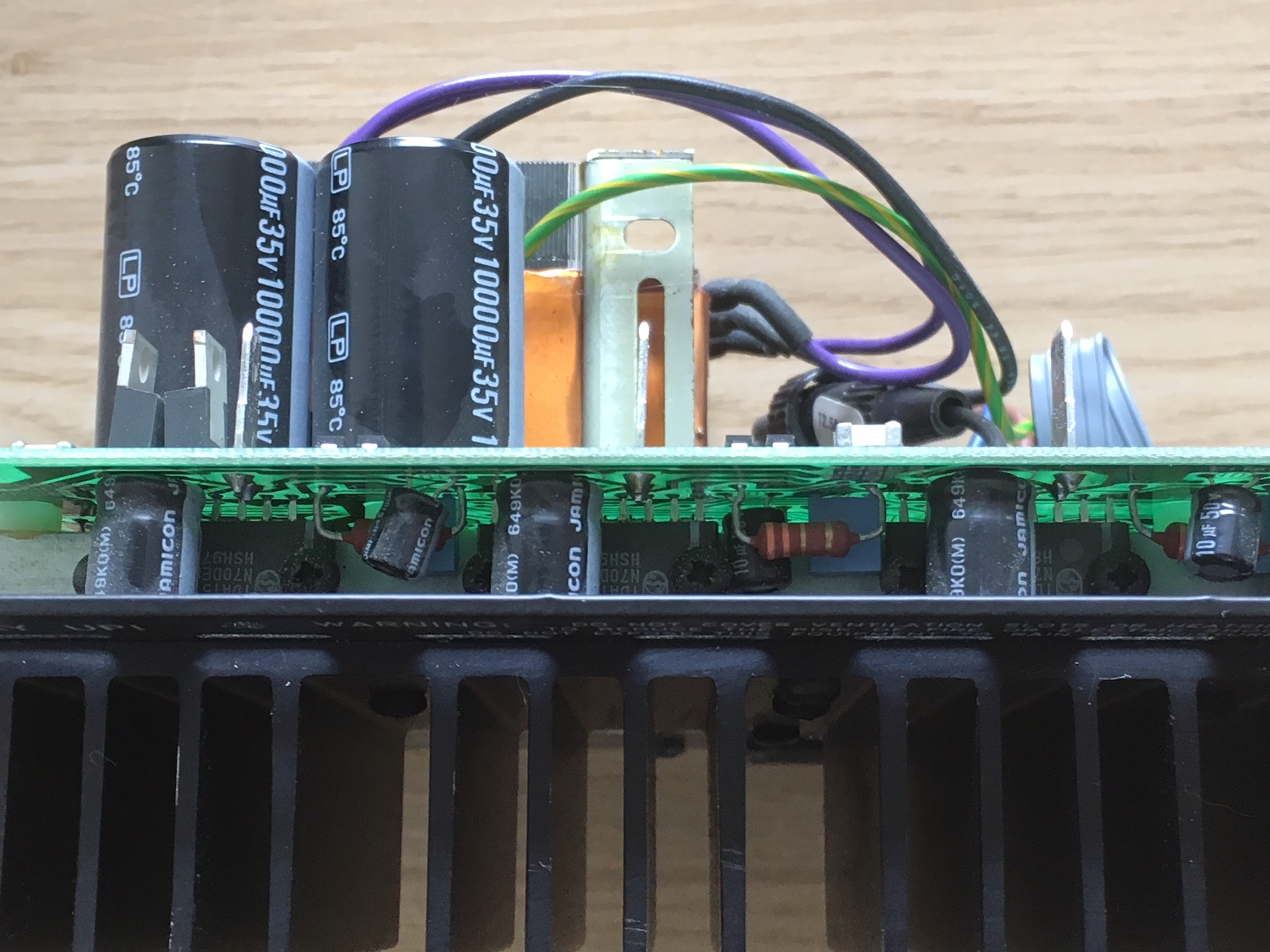

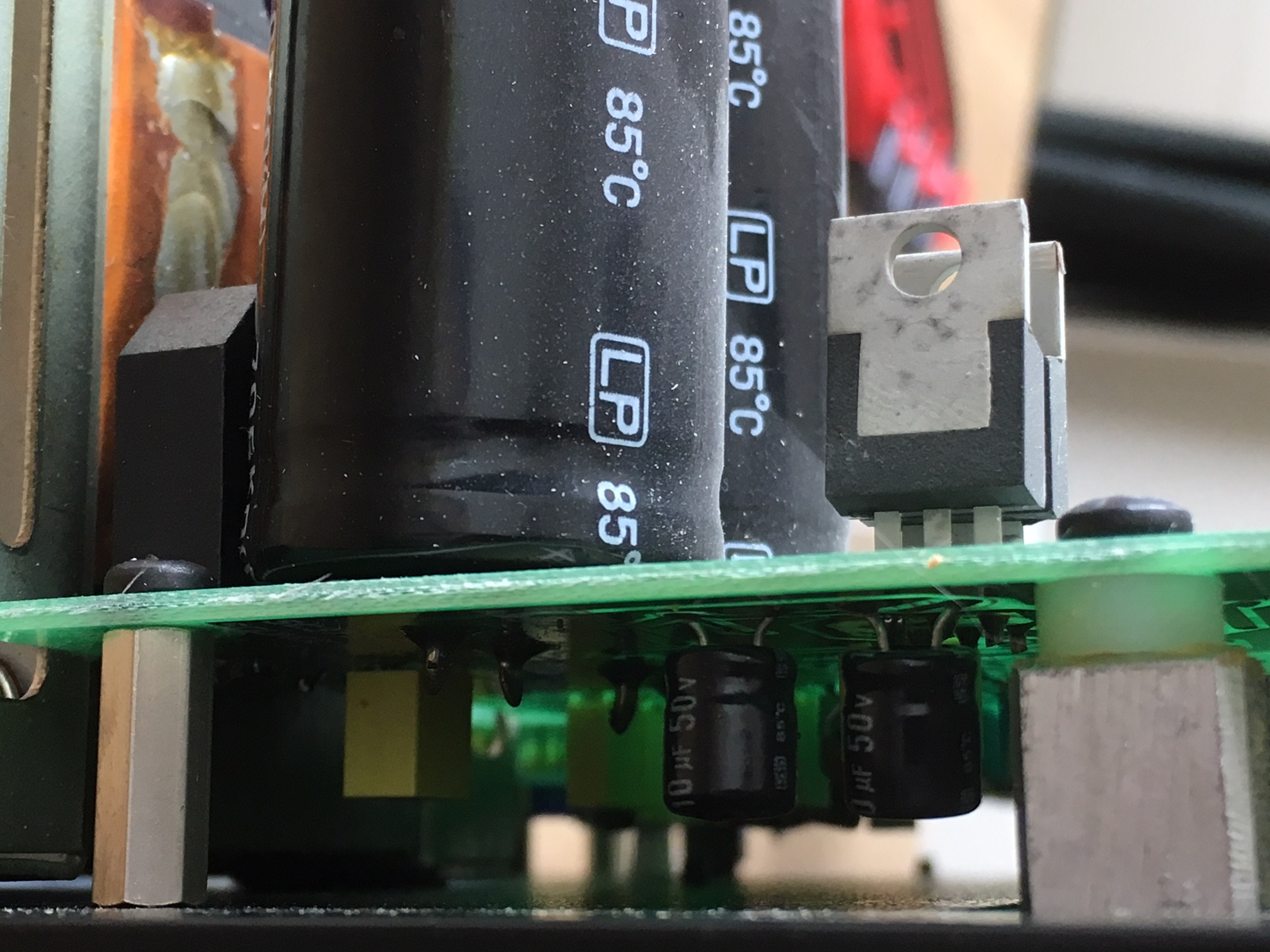

I took out the amplifier and found I didn't have to totally dismantle it to determine what's inside. I've attached some pictures.
As far as I can tell, all electrolytic caps are made by Jamicon. That name doesn't ring any bells.
We see C1 and C11/12 on the input board. Here there might be room for someting physically larger if that's easier to obtain.
We see C14/14, part of the PSU and mounted on the opposite side of the main filter caps. These, and all the others, are small. I'm not sure if they could/should be replaced with panasonic KS-series or similar, or if I should just look for physically small Panasonic/Nichicon/Rubycon parts.
We also see the bootstrap C's (C116-119), which are in fact 50V parts, not 25V. The larger parts next to the bootstrap C's are C102-105.
All pin pitches are 5mm or smaller, except main PSU filter caps, of course.
Any suggestions on which parts/series to order?

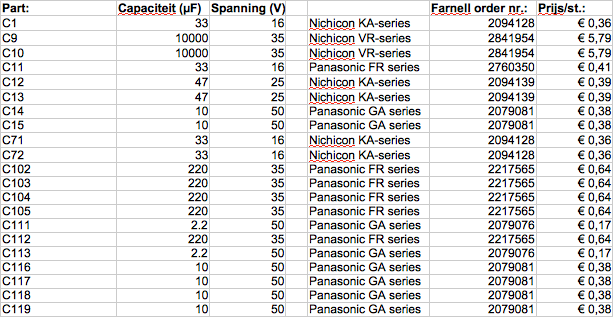

Unless there are any objections against this parts list, I think I'm good to go.
Nichicon KA- and VR-series, Panasonic GA- and FR-series.
As far as I can tell, there are little to no differences. But I went with the given advice above. Other than that, I chose highest thermal rating, small package and availability by single units, not reels of 2000 pieces.
I have ordered and received the parts in this list. Somewhere over the next few days I hope I will find enough time to tackle this job.

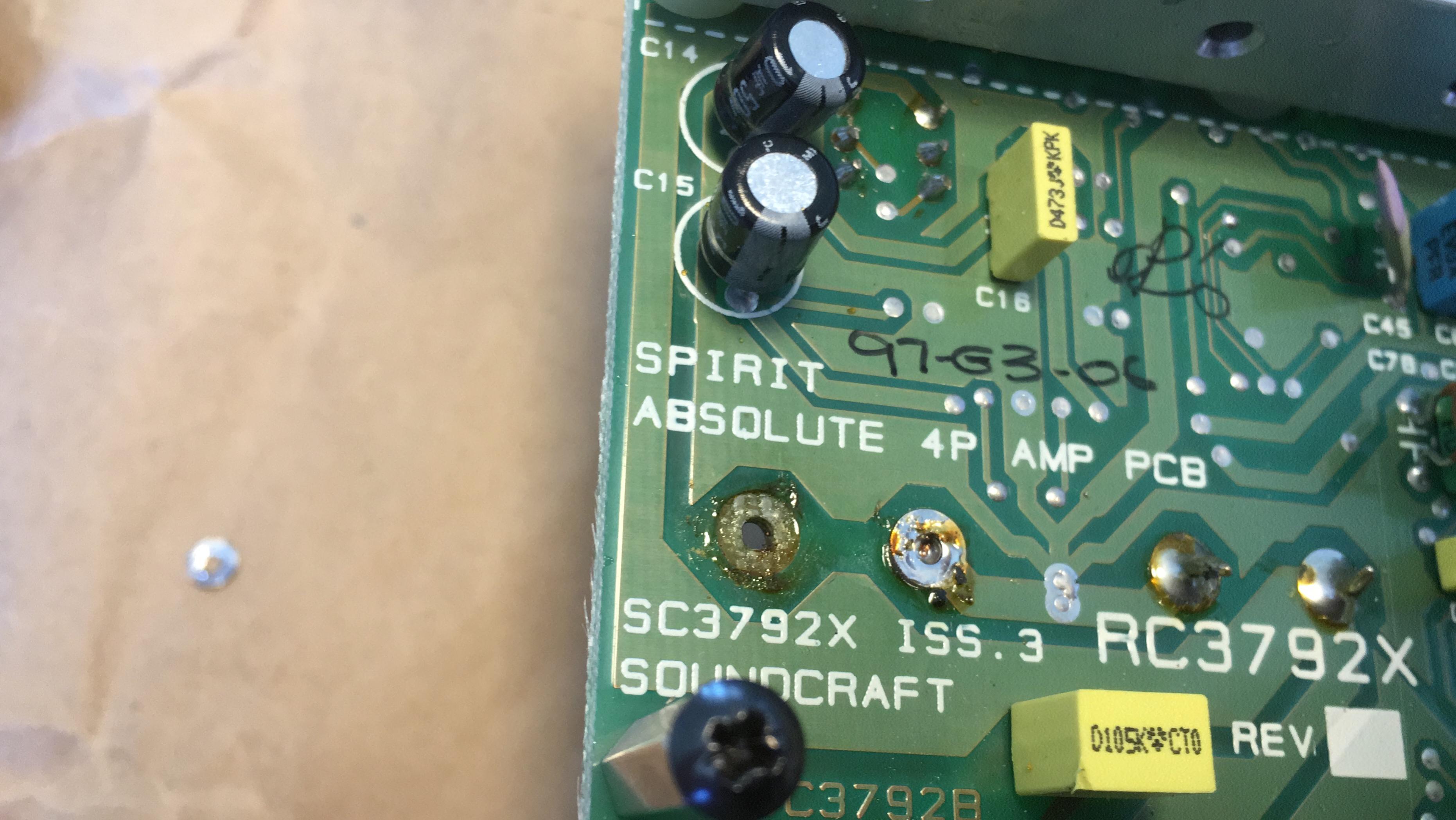

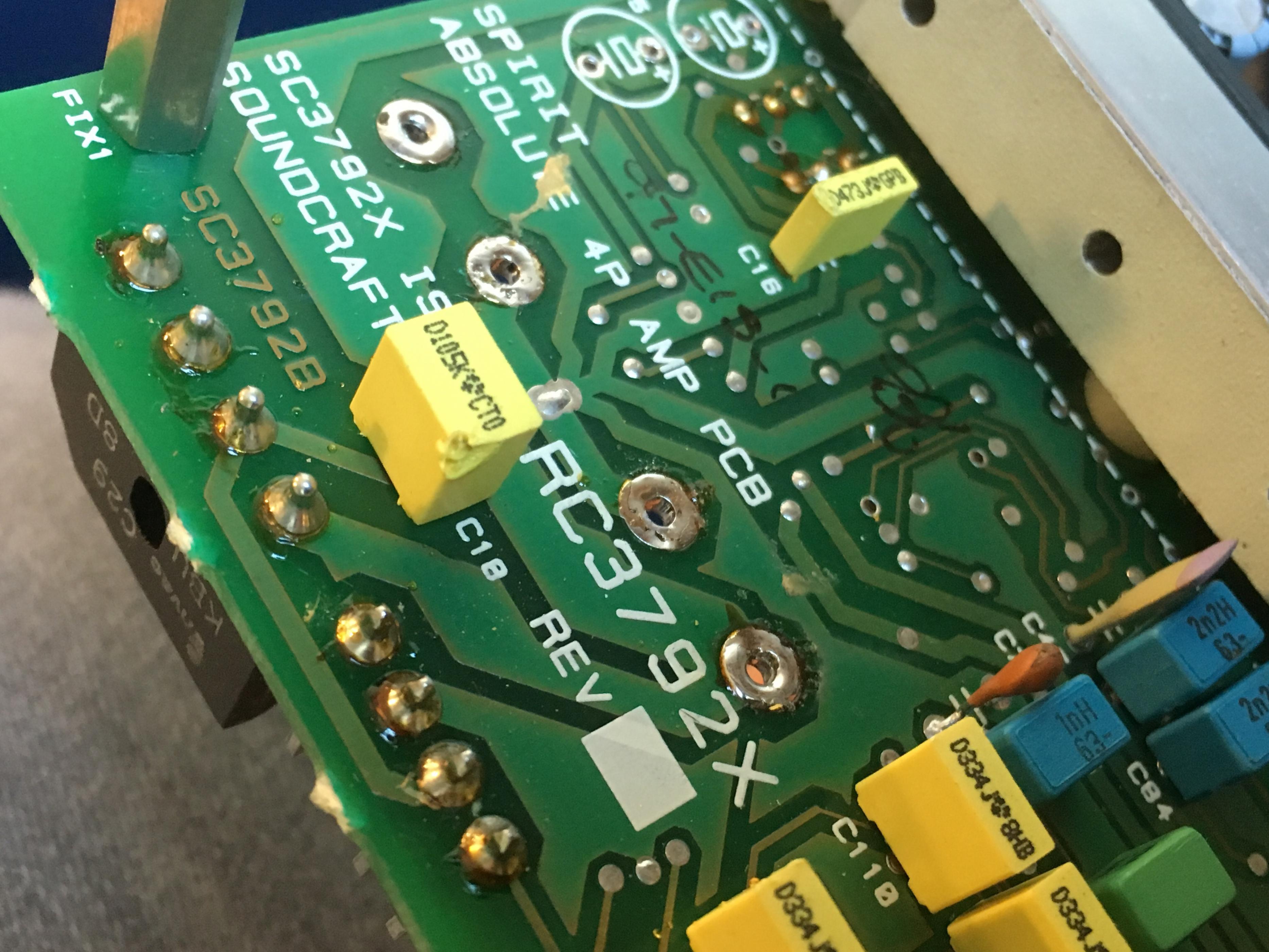

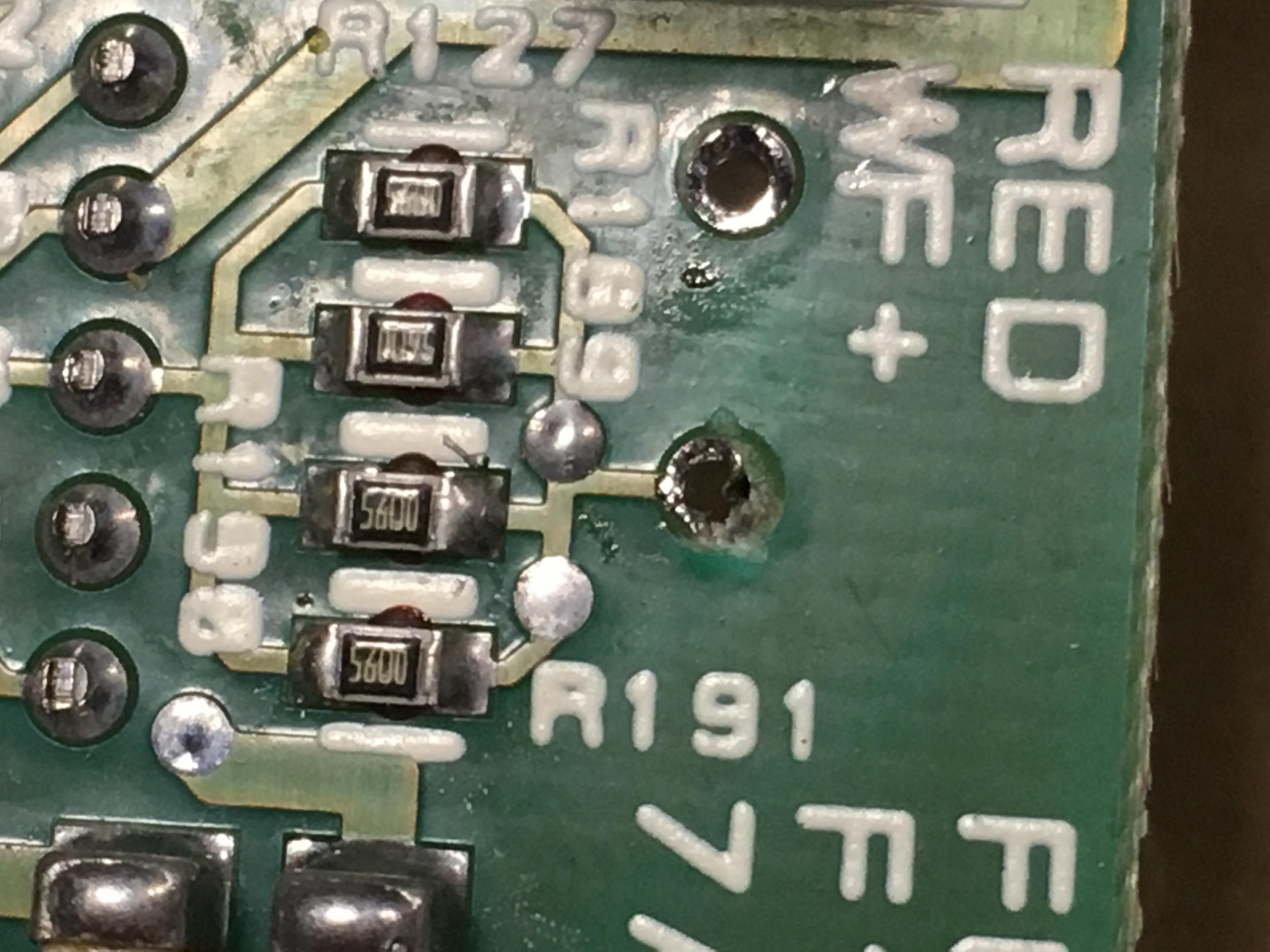

I've desoldered the elcaps from one of the two amplifier pcb's without major issues. But the copper traces of the other pcb came off way too easily. Is there a reliable way of fixing that? Can components still reliably be mounted on a damaged pcb?
It depends on the part you have to fix. A good way is to use hot glue under a large capacitor, for example, so the mechanical load is taken by it. Silicone, epoxy or conventional glue will work just as well. Avoid super glue, it contains acid that corrodes metal.
Then you can bend the loose copper trace to the contact and put some solder over it to stabilize. If the whole trace is lost, use some copper in any form to replace it.
Happens much to easy, I often found terrible destroyed PCB´s when "professional services" had repaired something. "Pro´s" often work against time, not for your equipment...

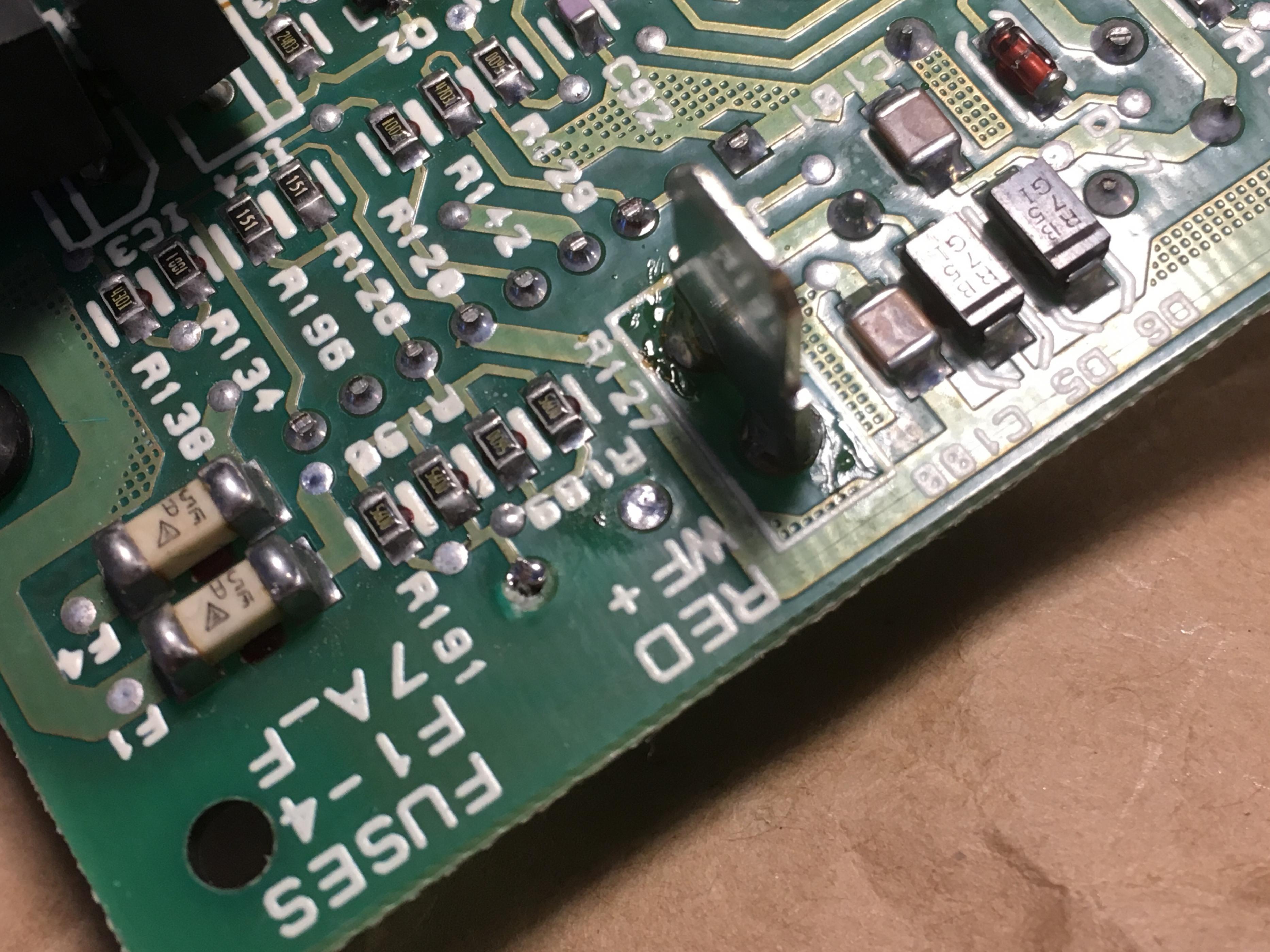

Hopefully these images will clarify the problem somewhat. I think the biggest problem is the disappearance of the copper trace underneath the psu filter cap.

In regards to the desoldering, the tip was too large / temperature too high or too long applied, which lifted the copper traces from the board.
Holly macaroni!
Thank you for the schematics, I contacted several divisions and could not get any service manual back.
Not sure about that. Temperature was set between 300 and 330 Celsius. My soldering iron is a Monacor SIC 520, which is supposed to a 28W device. The pcb from the other monitor exhibited no problems. I think (hope, actually), that this was just a bad pcb. I've gotten my hands on another set of 4P's, one in good working order, one with an unknown defect. I hope that the good one will have a PCB that will desolder fine, like my first other board. If not, then I'm in trouble. We'll see what a bit of hot glue can do, then...
Perhaps good or useful to mention is that the legs of the larger elcaps (still only 10mm large) are bent. I don't see how I can bend those legs straight and take the parts out without prolonged heating of the copper pad. I've been looking for desoldering stations, but they are either very expensive, or not being sold. I doubt that it's smart to buy one, for the occasional repair/restoration job that I do.
Any idea on how to best approach this?
