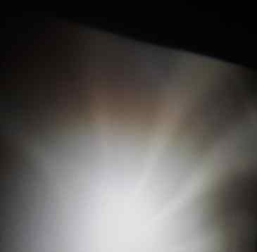

I am making the MkIII - using the kit - I am not
able to remove a spider like pattern from the screen
- I have removed the reflector and condenser
- moved the lamp - moved the mirror - used the lens
out of my OHP - moved the frensle lens -
I have not seen this in any of my home made projectors
and OHPs yet -
I have though it was my light because every thing else
has been moved or replaced - but I moved the light
and it did not change the spider pattern -
here is a pic - I changed the brightness and stuff to
bring out the pattern

Whats the shape of your reflector? My guess is the reflector is folding light in a way that overlapps at certain angles.

I tried lots of things - I still have it with or with out
the reflector - I had a mirror and removed it by using
the MkIII like a OHP with the light out of the top
- still have it - I got a sheet of glass thats as thick
as your pinky finger over the frensnel - I think it may
be what it is - It came with the kit - I am going to get
a thin piece of glass to see - the one from my OHP
is two small

Its my frensnel - its got to be - with or with out
the glass its still there - the frensnel came pre
cut - its a split frensnel - and I use some black
on the sides to join them - ring lines face-ing
I made sure it was lined up - using the center rings
I tried flipping it over - and the pattern it different
- could I have got if off center just a hair, and it do this???

If it is the fresnel, the alternating bright /dark angles going out from the middle are an interference pattern.
Does the fresnel look warped or buckled in any way? Does it lie flat? Could it have been on something hot or had something very heavy on it that would flatten the grooves?
Is this the fresnel between the LCD and the final lens? try raising or lowering it a bit. Does that change the pattern?

warped and not burnt and lies flat - its new
yes - the arms move -try raising or lowering it a bit. Does that
change the pattern?
the fresnel is between the LCD and the light - I tried
moving it up and down and was never able to
remove the arms - even tried tilting it, the arms
move with the tilt
no - its some 3M OHPis it a page mag?
frensel - I think, it had a 3M sticker on it, and its huge
it came with the MkIII kit, if I remember right it said
220mm - both look the same, and look cut from the
same joined OHP frensel but a big one

So you are saying without this fresnel you get a clear projection but with it you get the "arms". Seems like a bum lens to me! return it.

3 things i see is whats causing this if its the frensel.
1) The rings are miss matched
2) The top frensel has a different ring count or pitch then the bottom.
3) Crushed rings. Who ever cut this may have crushed the rings from clamping, (though you would see the crushed rings on your screen).
I can prety much garentee you that its either 1 or 2.
A warped frensel wont do this, it will simply give you a dirty looking light on the edges, and the edges will be out of focus. (on a triplet is best for testing, though just use your eyes by looking at the frensel lol).

I just had the same thing
They are interference patterns between the two fresnel's rings, that only show up if the light between the fresnels is perfectly parallel.
I found two different cures:
1) Raise the fresnels about 5 mm above the focal length from the lamp arc, so the light between the fresnels is not perfectly parallel.
or
2) Seperate the two fresnels by at least 1 cm.
or
I separated the 2 fresnels and tried sliding them back
and forth over each other - gently so not to scratch them,
I was able to get it just by placing one of them off center
I tried even lining up the cut marks in the edge of the
fresnels and tapeing them together - it did no good

I had the exact problem when I put both fresnels (unsplit) before the lcd panel in my pj. (I am not uing an ohp, but am putting everything in an enclosure.) I pulled out the 330mm fresnel and put it in front of the lcd (now a split fesnel setup) and the spider light rays disappeared.
