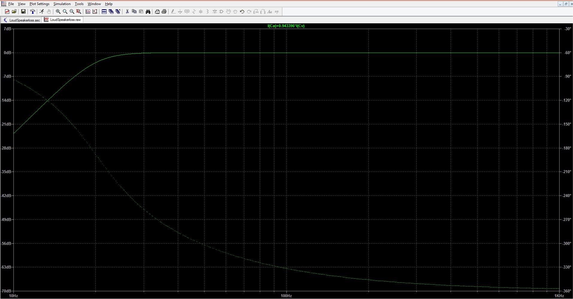

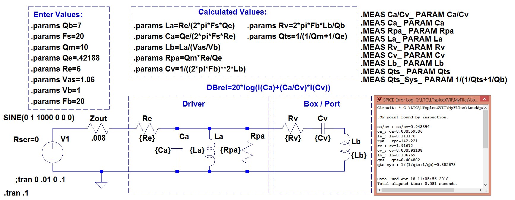

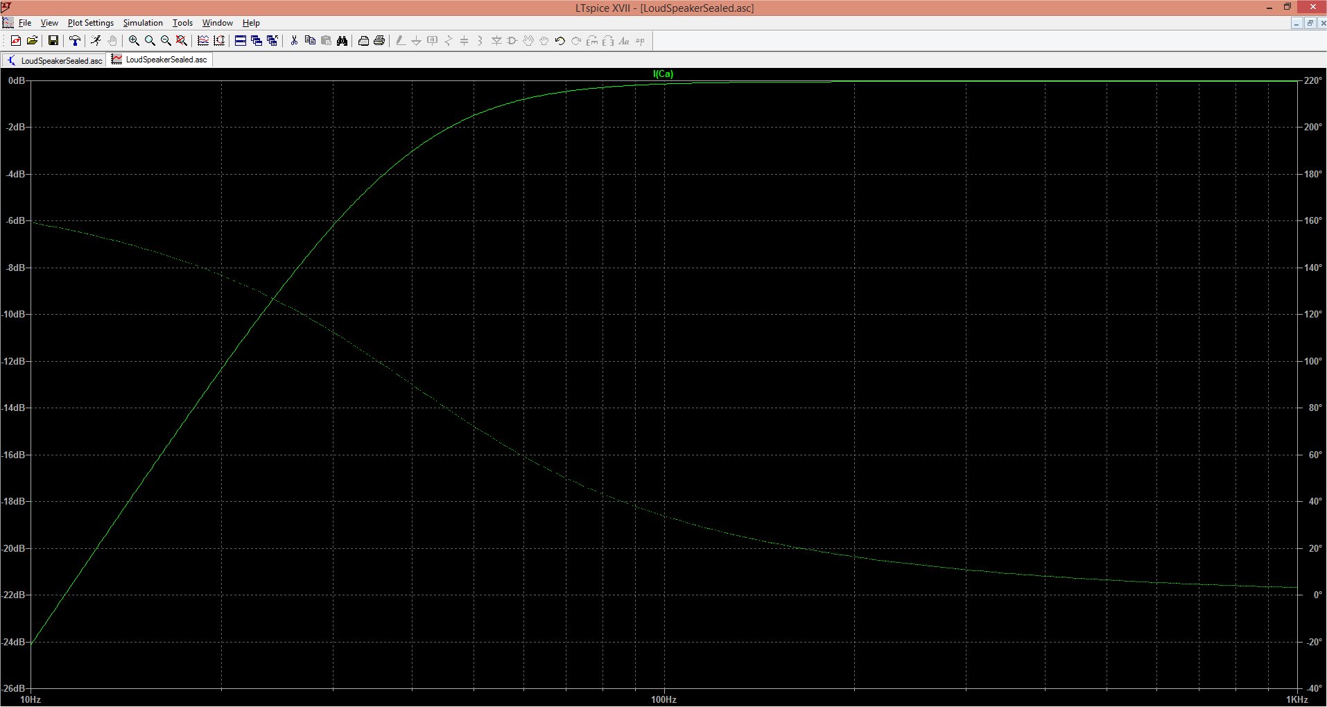

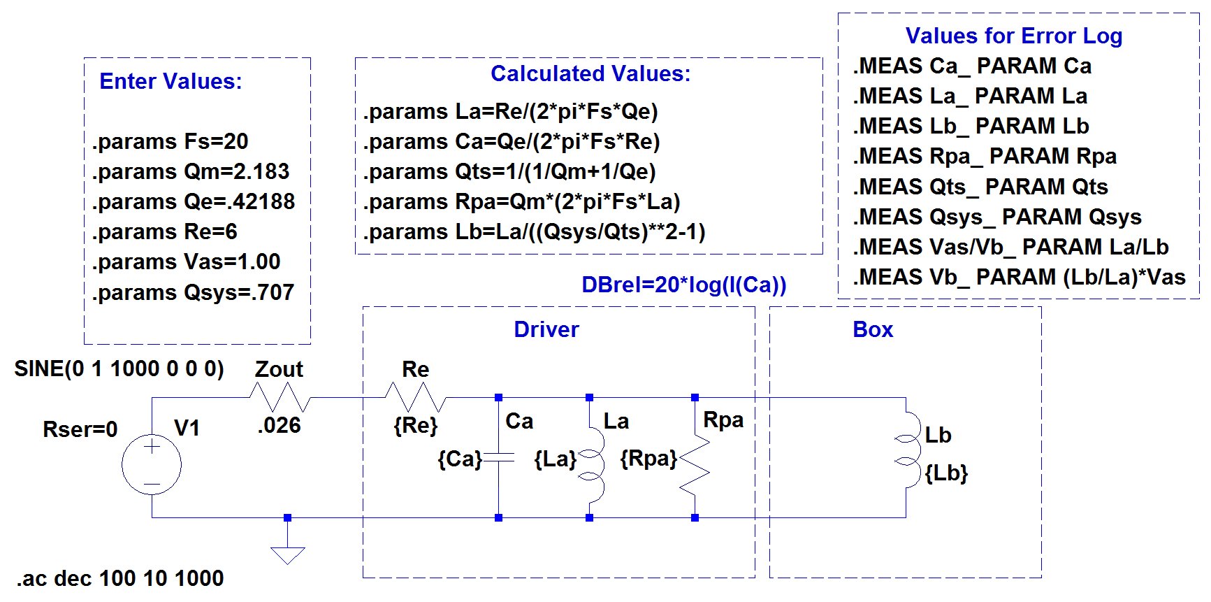

Did you know that you can model electro-acoustic properties of loudspeakers? I use LTSpice for my simulations. I create a circuit based on the electro-mechanical properties of a woofer, and an enclosure. It takes the form of a high pass filter of sorts. Using Thiele-Small parameters, you can convert them into a circuit. I am attaching a screenshot example acoustic suspension speaker system with a system Q of .707. You can plot frequency response, impedance, phase or anything you wish. This model has an amplifier with a damping factor of about 300. I also model ported systems. I can show an example of that if there is any interest.

Jim - you showed a pretty simplified model of the loudspeaker, how close would it match the actual measured results? Dr. Leach back in 1991 was already working with more complex models, which no doubt were subsequently incorporated into the modern speaker design programs.
The model can be made as complex as you want, but it will have little effect on the box volume and/or tuning condition IMHO. Thiele showed more complex models in 1971 but opted for the simpler model for design.
The ported model is similar to the one shown but contains 2 more elements that are of consequence. Since there is a vent capacitance, there is also a resistance associated with it. This is used to calculate the box leakage Q.
Tuning conditions for ported designs are selected based on Butterworth, Chebyshev, or whatever filter you prefer. Again, the simple model is best for these calculations. The other elements will have little effect on box and tuning conditions.
More complex models can be created based on actual measurement of specific drivers. From this you could get more accurate impedance/phase plots.
Jim

I think you missed the point of this. A.N. Thiele solved the mystery of ported loudspeaker design by converting the electro-mechanical properties of a speaker system into a circuit. The idea being that once these parameters are known, the values can be calculated for known filter types. As an example, a ported system can be designed as a Butterworth filter as quasi third order (QTS less than .383) or a forth order if Qts is .383. The poles are zero for orders 1 and 2 in first case and zero for 1,2 and 3 in second case. SPICE is great for modeling filters.
