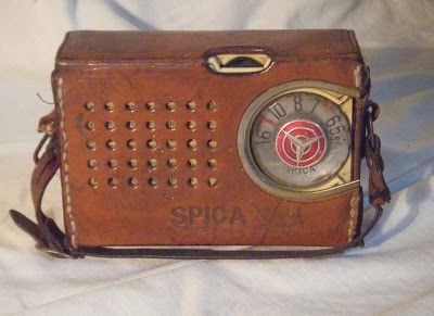

I thought this brand was exclusive to portable AM radios that were very famous here, in Argentina !!. Many football fans attended the stadiums equipped with their "Spicas", and followed the game's events by tuning into the broadcasts of their favorite announcer...
Sorry OT
Sorry OT
It would be nice! 😳 Although I just looked up who it is, football is not my passion, tennis is, but unfortunately my knees have had enough, even for a double mixed ! 🙄
