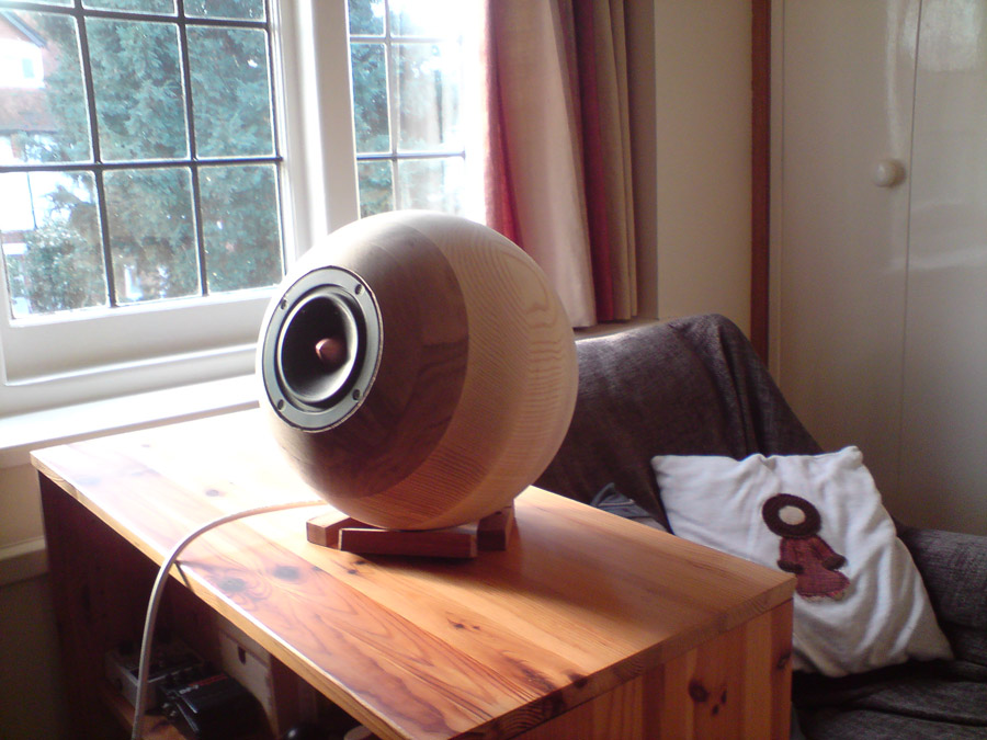

Hi, I'm new to this (rather amazing) forum and only recently became interested in designing speakers after stumbling across the various ingenious Ikea bowl designs that people have made. I made a similar speaker from solid ash and black walnut (photos below, not very well taken, and without a proper speaker stand so they don't really do it justice).
Anyway, it sounds really good to my ears (i.e. not dissimilar to my dad's £500 Mission towers, apart from a slight tinniness. However, using my sequencer's EQ to cut by 6db at about 1500Hz removes the tinniness, and vastly improves the sound. Is this likely to be caused by the design of the enclosure?
Would making a basic notch filter, like the designs I've seen elsewhere on this forum get me a similar result without having to play all my music through Logic's EQ? Is there a better way of establishing exactly where this spike is, or should I just continue going by ear? I'm pretty happy with the post-EQ result I currently have.
Would anyone be able to help me establish the values of the components I would need? Do i just solder them together and stick them in front of the negative terminal on the speaker? I'm really struggling to make sense of the information out there. I'll try to upload a screenshot of the EQ curve I'm trying to achieve.

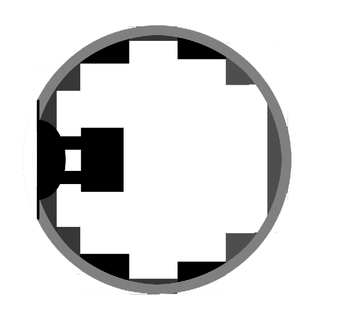

Hi. It is a shielded CSS FR125. The inside diameter of the sphere is tricky - in the cross section below the external diameter of the light grey circle is 28cm, and the internal diameter is 26cm -however, I left those internal ridges in the sphere as an attempt to break up the soundwaves and avoid standing wave problems I had heard people saying might be a problem with spheres.
After I had made the speaker, the only way I could think to ascertain the actual volume was by filling it with small bean-bag beans poured out from a litre measuring jug. The internal volume seems to be seven and a bit litres. The speakers don't really sound too boomy in the low end, so I'm assuming that this volume is OK for these drivers.
I find this to be counter-intuitive. I have no idea about standing-wave theory, but I would have assumed the flat surfaces would make the issue worse, not better. I could be completely wrong, though.

7 litres is a good volume for FR125
A sphere will usually have a single resonce related to the diameter and can be ameriolated by putting a good wad of damping at the centre. By squaring things off you have distributed them a bit, but it is most likey still the problem. The dimensions are very close to the frequency you ar ehacing to cut. I would start by suspending a dense bit of damping in the centre and at the walls, with less dense fluff in between.

You have something nice there.
Sitting 3' away, do you need boost ?

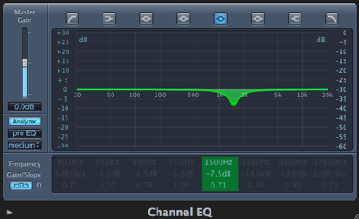

I used my sequencer to approximate the EQ curves suggested on that page, and the speaker sounded much better balanced, less bright and more bass, a much more natural sound. I'll definitely look into compensating for the baffle loss, but it's a struggle getting my head round the technicalities of that article. Are you saying that the circuit design given there won't be compatible with my full-range speaker?

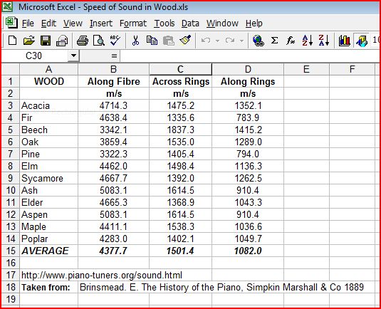

I am a total novice in speakers but since this topic resembles my quest to suppress vibration in the plastic case, I took a liberty to do some calculations. They maybe irrelevant, not applicable or just plain wrong, but the end result is quite striking.
These speakers are made of wood laminate which looks pretty solid. I presumed that it is the solid wood with some kind of surface wave propagating across the grains (just looking at the pictures). As the properties of actual material are unknown to me, I took an average speed of sound for different sorts of wood. (See my compilation attached as a picture).
The sphere made of this hypothetical ‘average’ wood with the external diameter of .28m (from the author’s post) will have the fundamental frequency of standing surface acoustic wave between 1230Hz (along rings) and 1706Hz (across rings). In presumption that ratio is 50-50, the average (once again!) gives us the frequency of 1468Hz.
Pretty damn close to the troublesome resonance frequency!

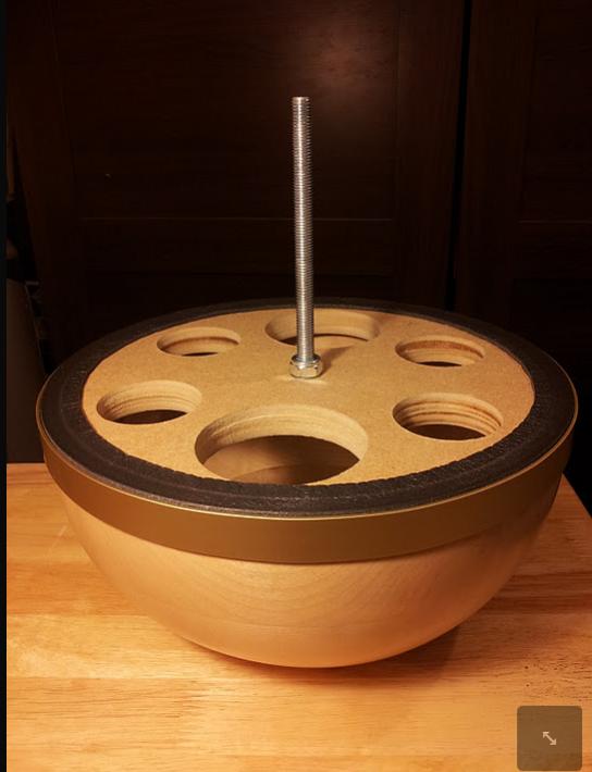

B&W intersect a tube with the sphere to suppress it:
http://www.bowers-wilkins.co.uk/Sphere-Tube.html
French Manufacturer Elipson use an internal Helmholtz resonator to tackle the problem:
http://www.elipson.com 4260BN.pdf
I've heard the Elipson's, and the idea works well IMO.
