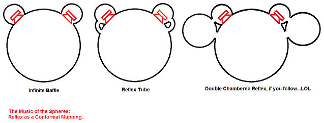

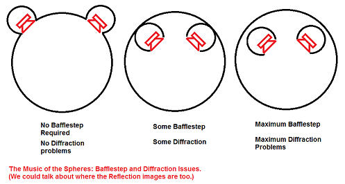

Back to your thoughts about spheres. I've just been pondering how your spherical speakers might work, in a spherical room, of course! Hope I don't get TOO obsessed by this, but I think it leads somewhere and Conformal Mapping gives you a handle on it. 😀

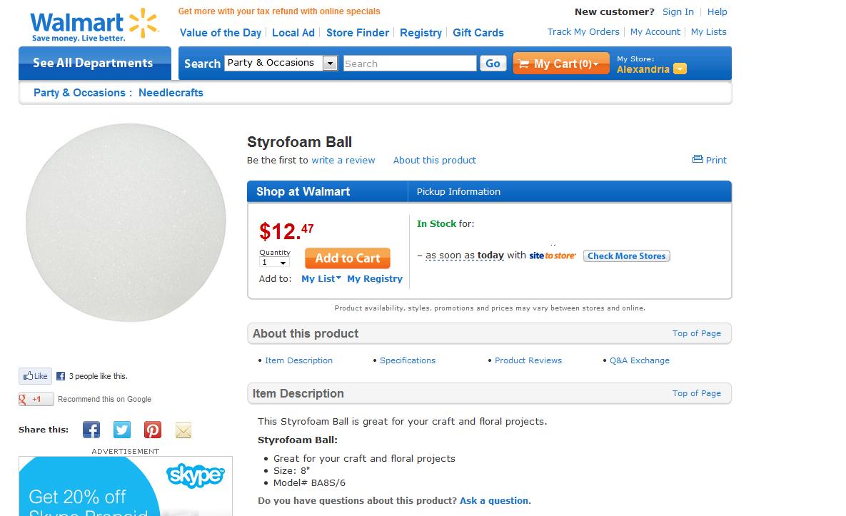

The best deal would be to make them with fiberglass; Styrofoam spheres forms are easy to find. i.e. cut front wood ring and fiberglass as one solid speaker. Should be easy to scoop out Styrofoam once done.
Local Walmarts has 8" in stock.
Ebay has 10" spheres (523sq in) in the $23 range:
2 Pieces 10" Styrofoam Ball | eBay
Price jump for larger sizes:
TheCraftPlace.com Store: Styrofoam Balls for Floral and Craft Design. Many sizes.
